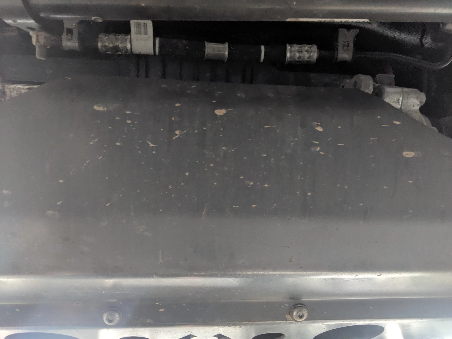

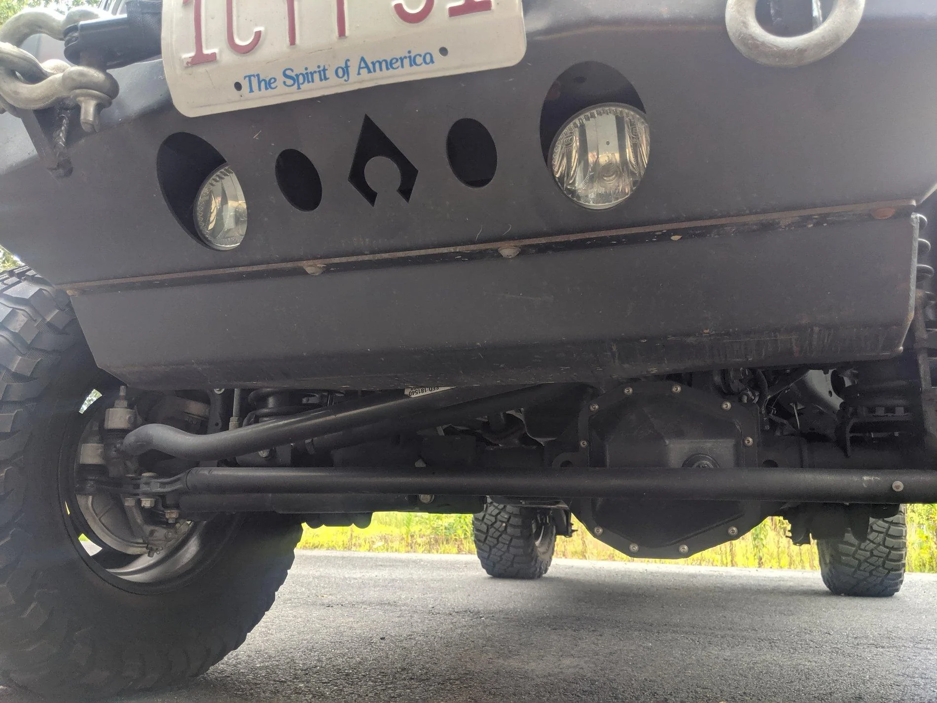

I have both artec bumper and lower skid installed
It ties into the bottom of the bumper with preexisting holes and into the frame when it drops for the air dam support. You do have to drill out larger holes on the frame to install rivnuts and it is right in that area. It protects the sway bar disconnect module very well and is tucked up as good as it can be but if you plan on removing the sway bar disconnect it have Anon Rubicon it's not worth it

I'll try and remember to grab pics in the morning, don't really have any good ones, I like it the quality is good and solid construction.
One thing to note I just remembered is the fog lights you have to do some trimming of the mounting bracket (the plastic fog light not the bumper) to make them fit for rubicons and Sahara with plastic bumpers or you can get after market jk fog lights or a light pod as they give you mounting options for both

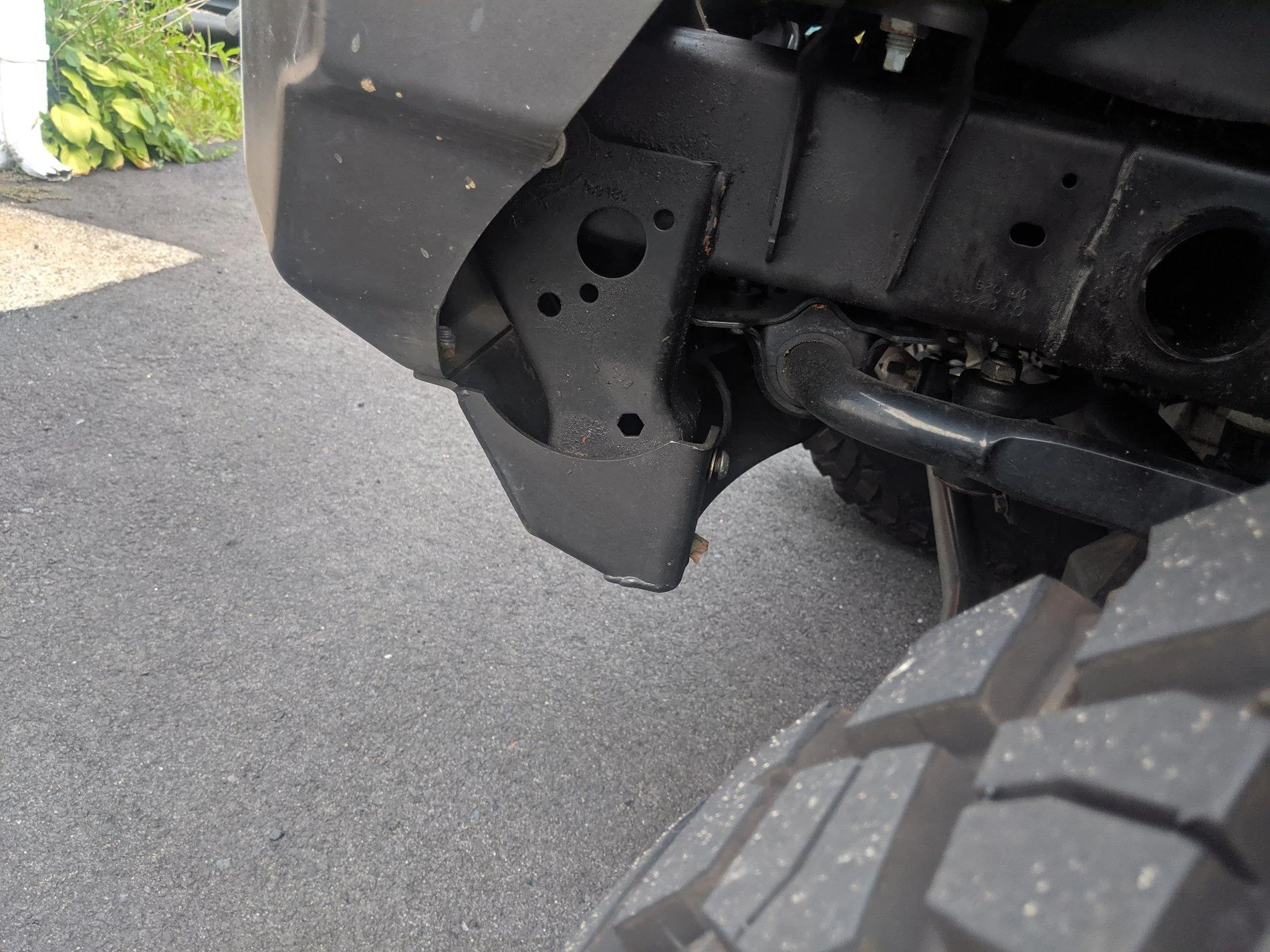

I thought they were saying that if you have a rubi plastic bumper the fog lights that come with it fit, but others, like steel bumper lights, do not - you confirmed that your plastic bumper fogs did not fit without cutting?
Would be great! Back bumper too if possible.
They may have updated the design I did this in April 2018 so one of the first see pic of what I had to trim
