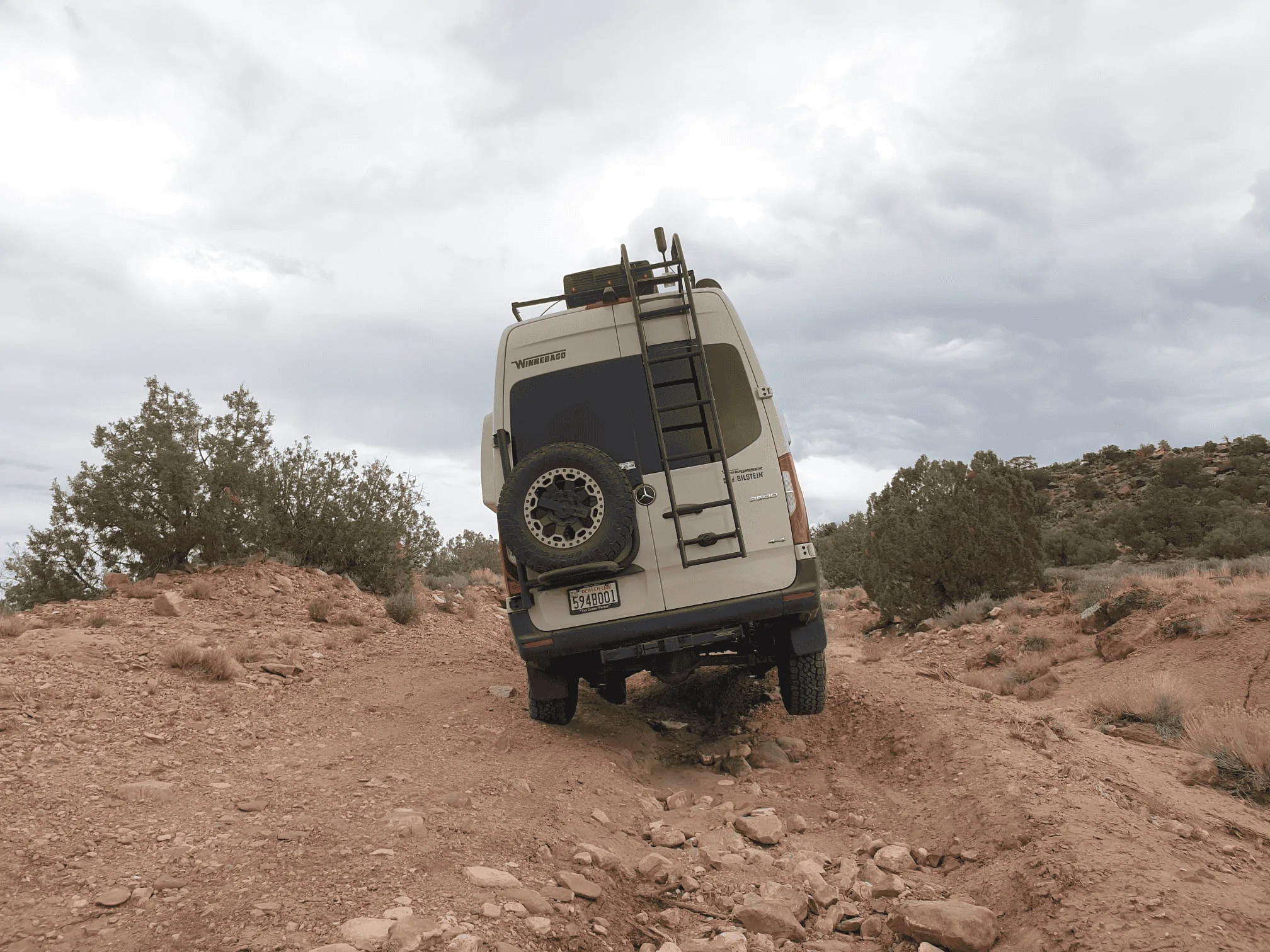

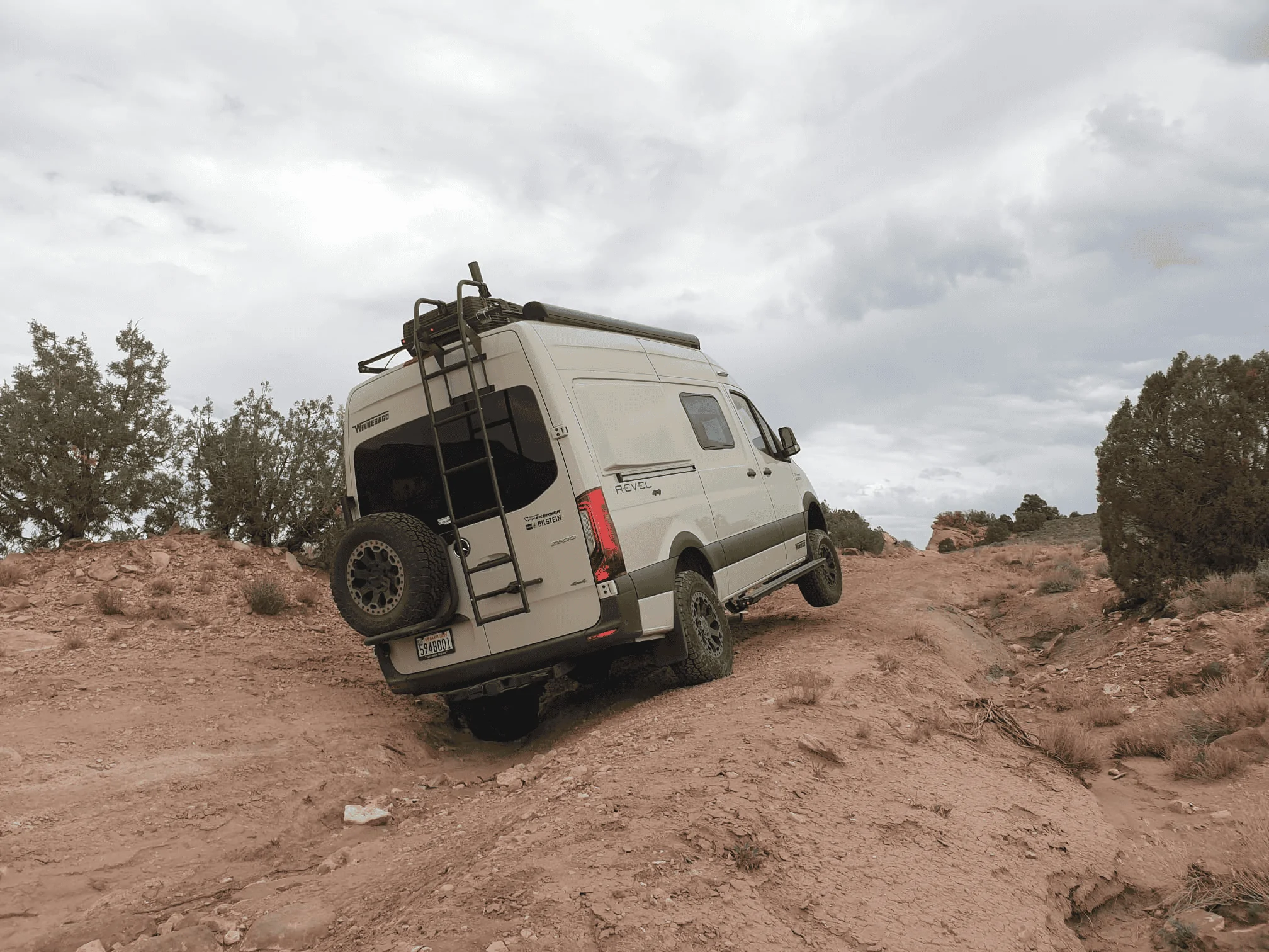

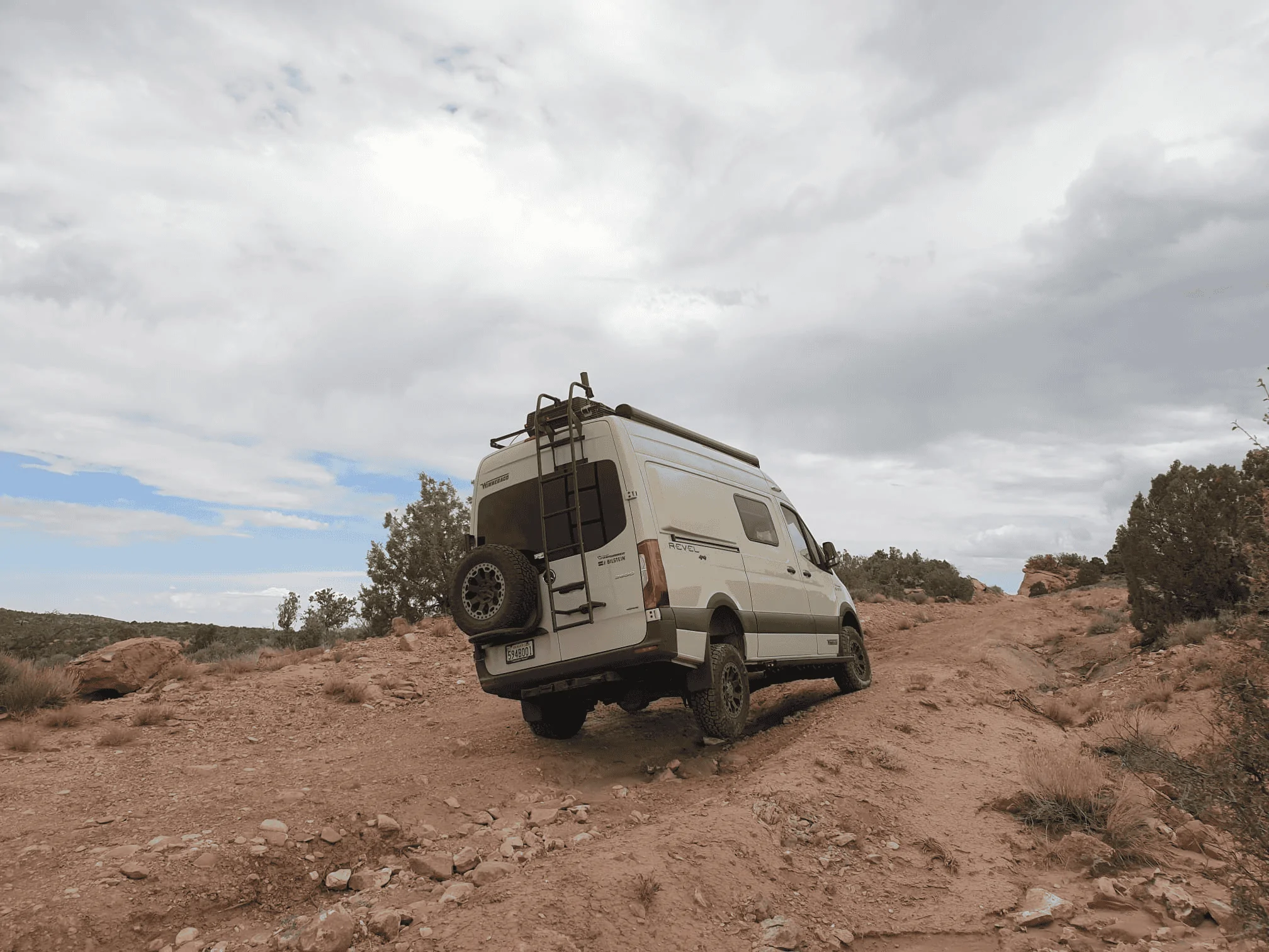

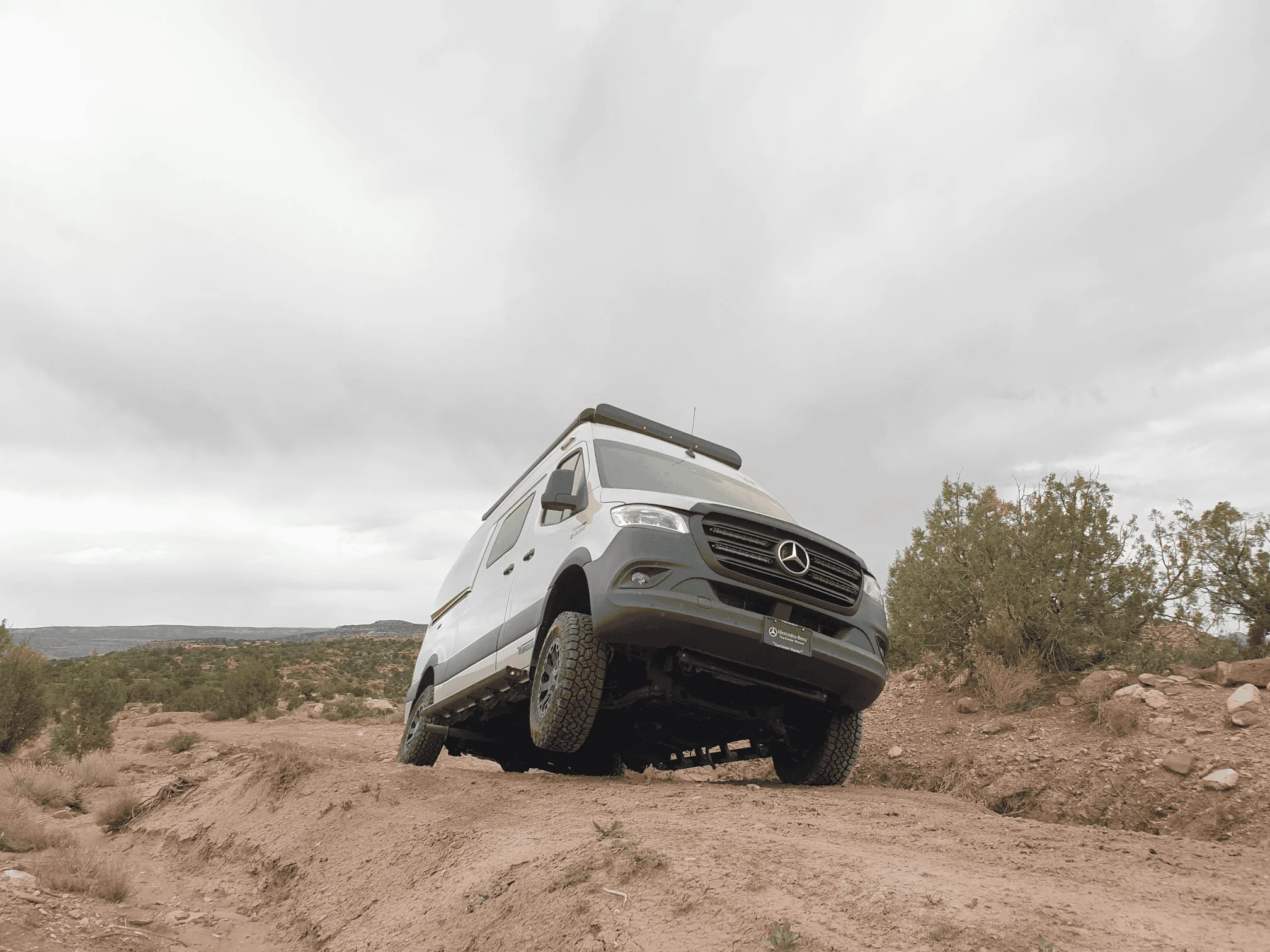

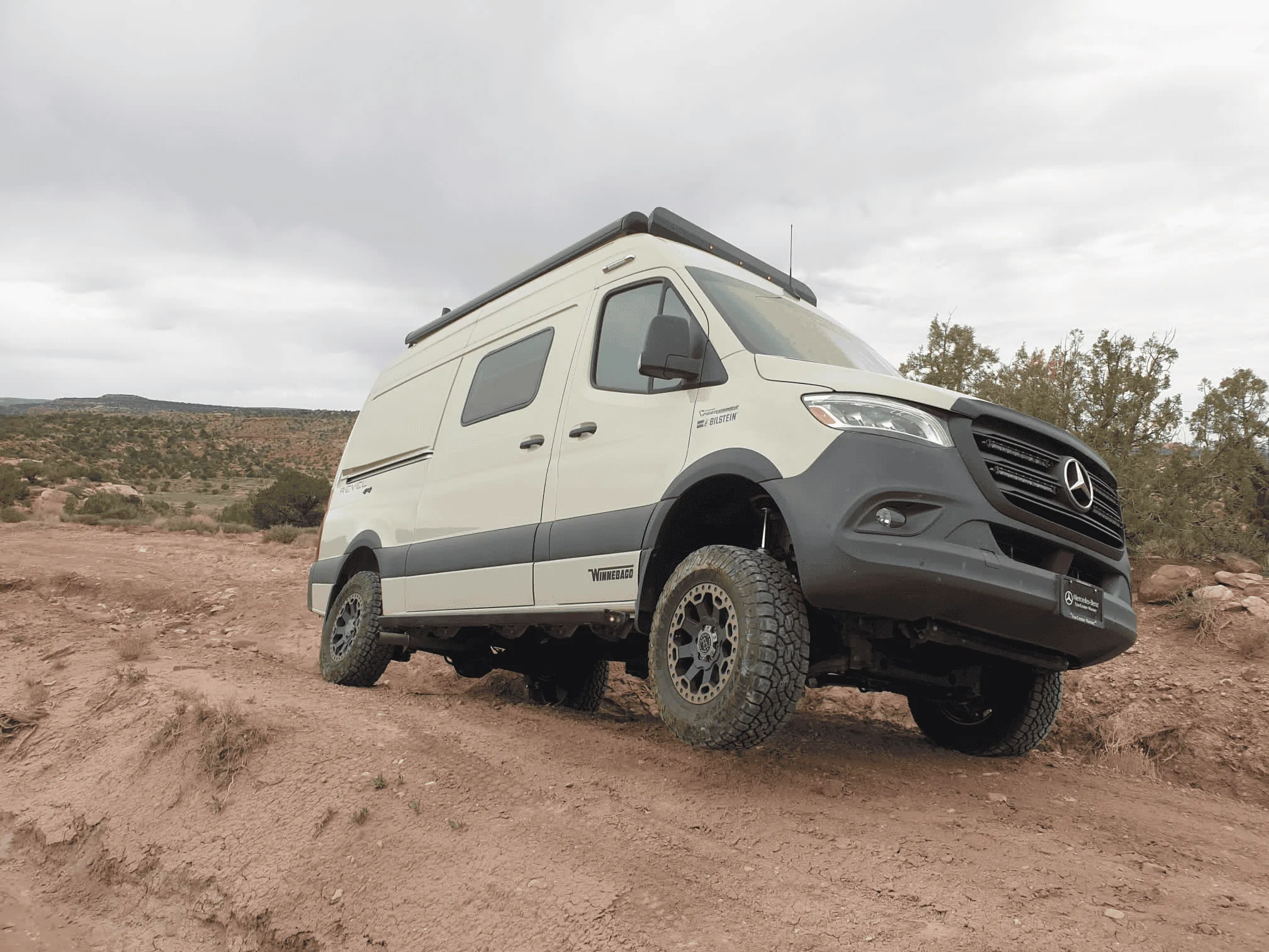

Also, they even make a kit for Sprinter vans which I think is cool for a suspension engineering firm, too:
