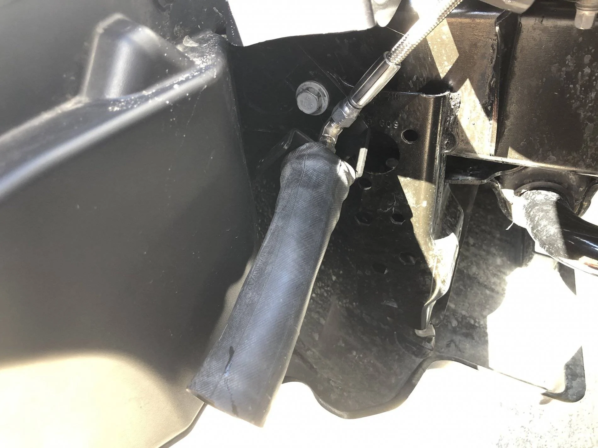

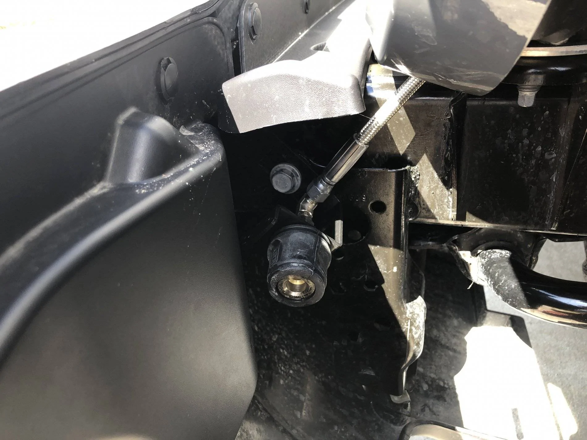

Why so snarky? There are a number of different ways to approach this mod. There is no one way. I’m just sharing what worked for me. My single works perfect off aux four. I used the ACM bracket in the wheel well with the remote chuck. I slipped a short section of bicycle inner tube over the chuck to keep it clean of mud. I might sew the open end of it up to close it off.
My ARB single HO compressor has a relay for the wiring harness to connect to. Wiring harness rus to the aux pig-tails near the battery.
