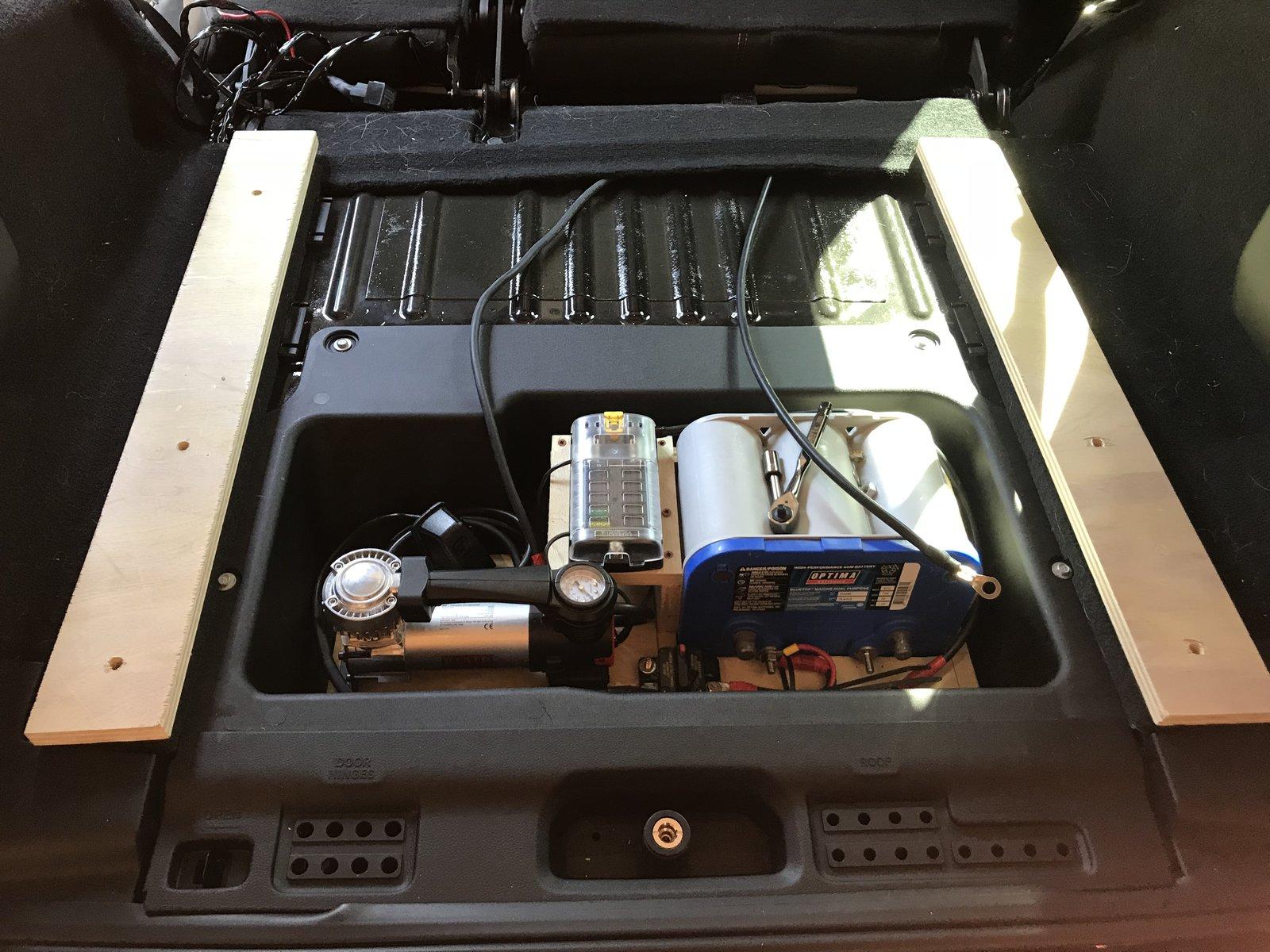

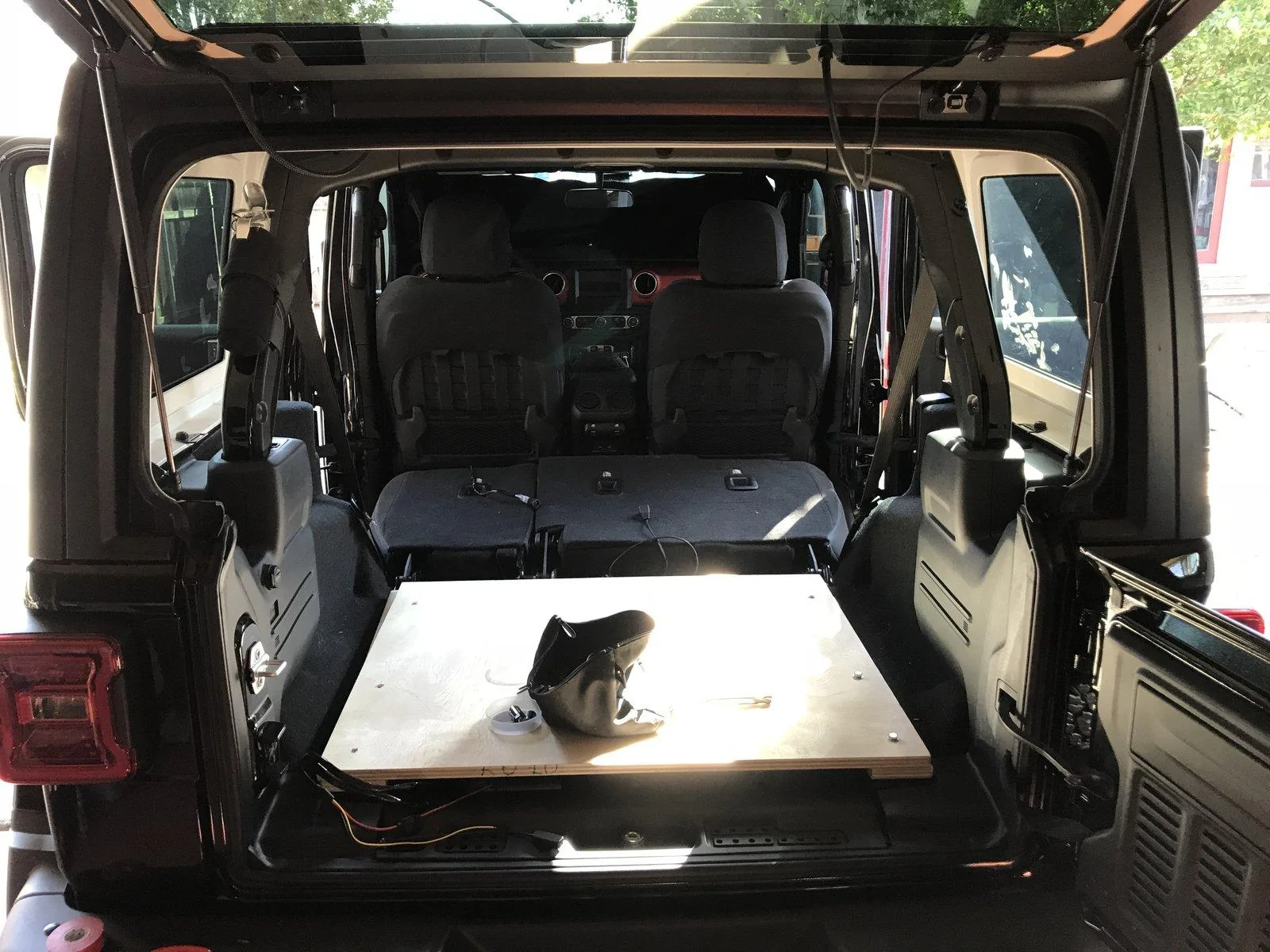

Thanks for sharing, I’m also utilizing the storage space in the rear and glad I just found this thread. My house battery and fuse block is there. Ran a 4 gauge wire to the battery isolator. Using an elevated platform which is hinged and vented on front and back. Figured if fridge is there full time I had to do something to make it accessible. Still a work in process but thought I would share:
Can’t wait to get my twin ARB:

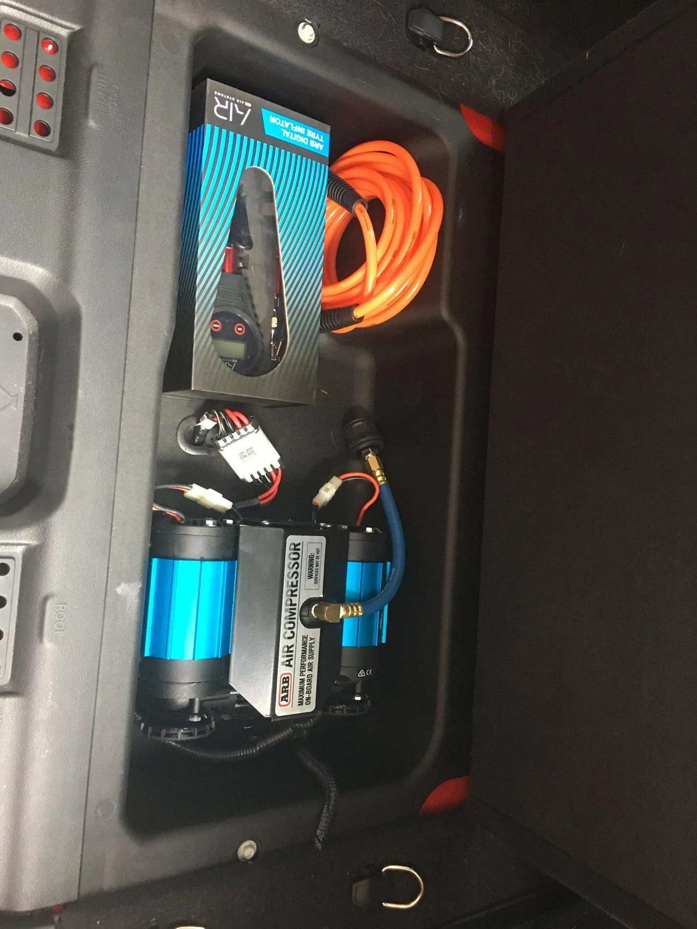

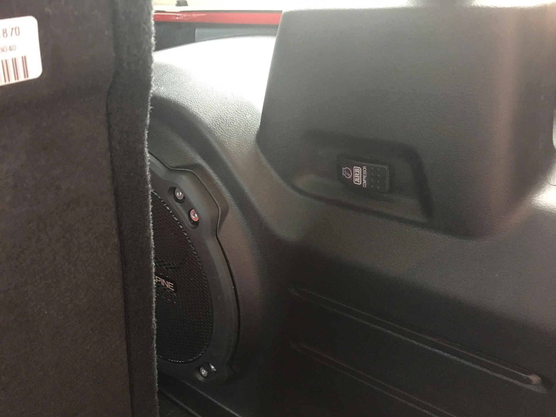

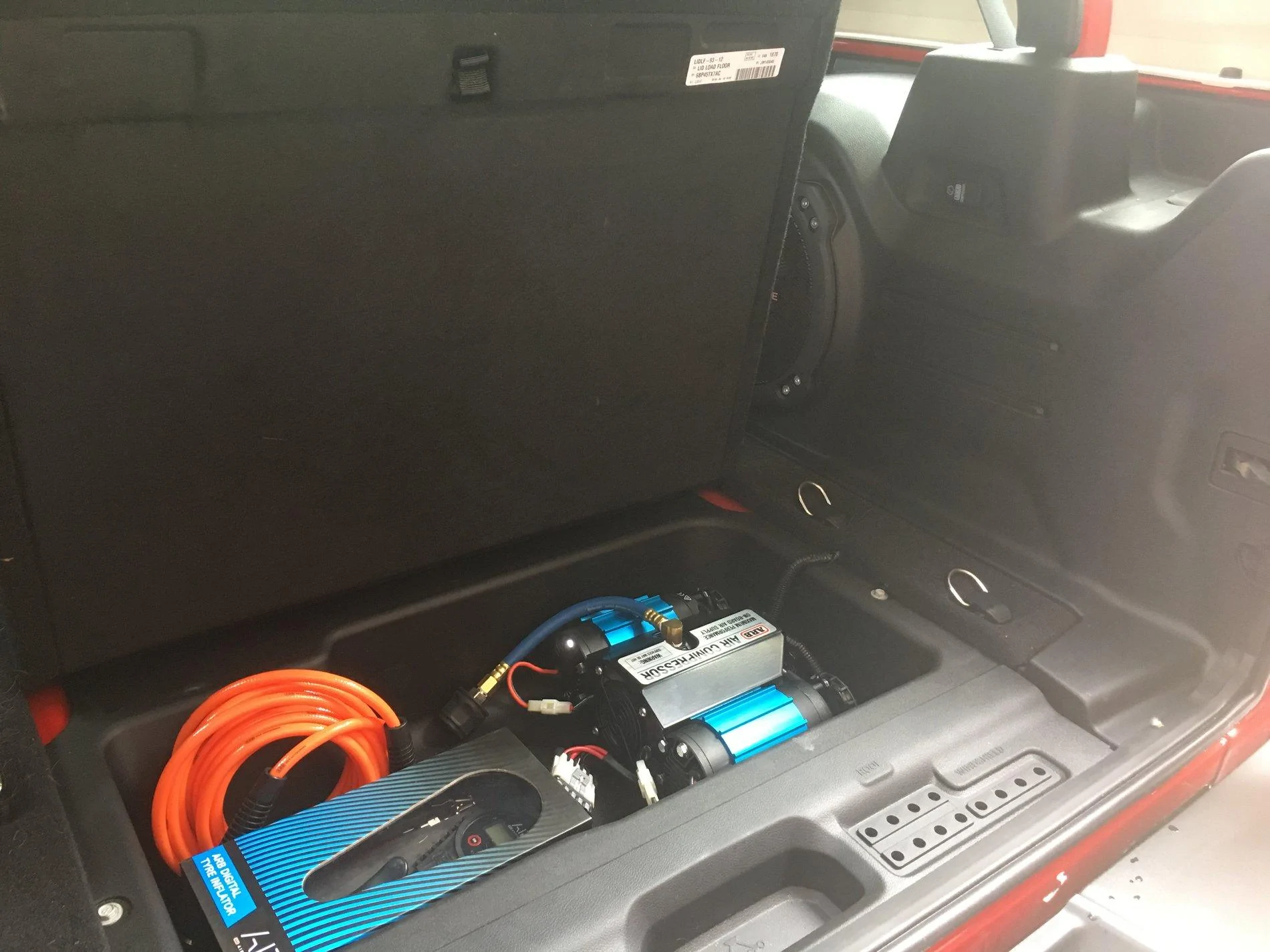

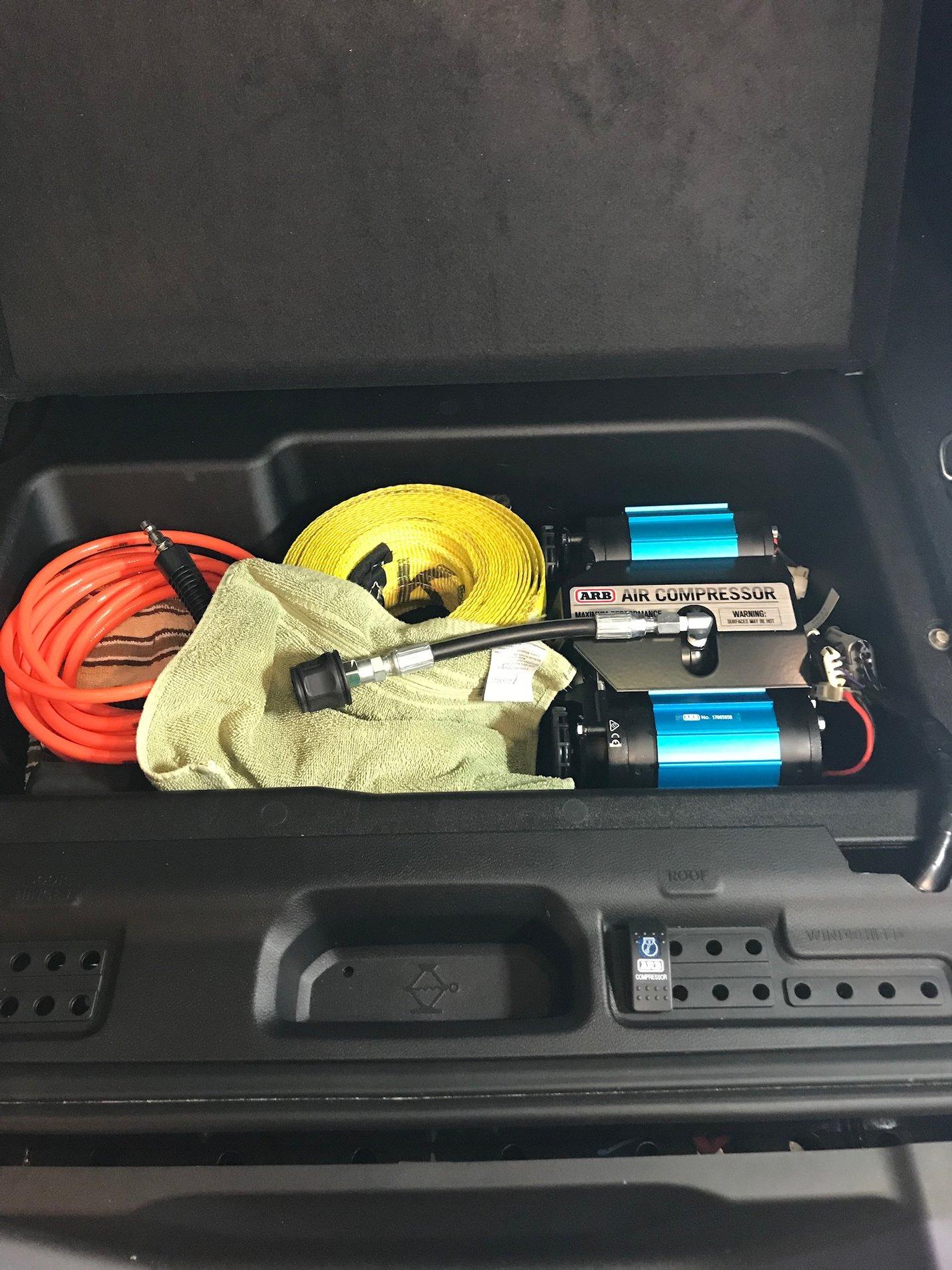

Many thanks to OnlyOne for sharing his idea on location for twin ARB mount and for his assistance via personal message. Here's a look at what I've done. Note, my switch location differs from OnlyOne's.... either location will work just fine.
Any chance of a write up in the DIY section? This looks extremely clean and I want to see how you routed the wiring back there. Again very clean look...
Any issues with heat? That ARB gets how while running doesn't it? Also are you able to leave the deck cover over the compressor during use? Your setup looks very clean BTW :like:
Did you bolt the compressor down?
How is the heat on the plastic?
