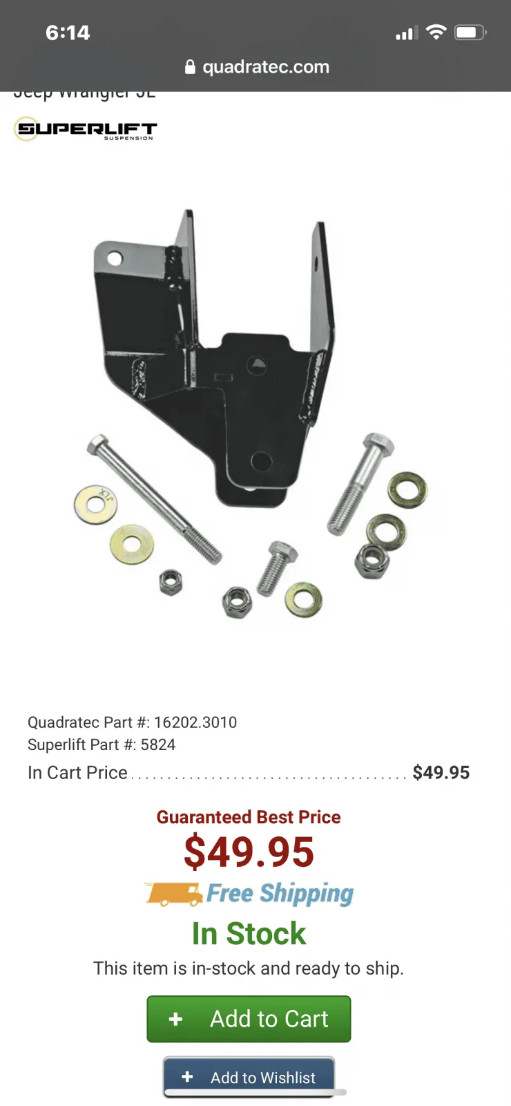

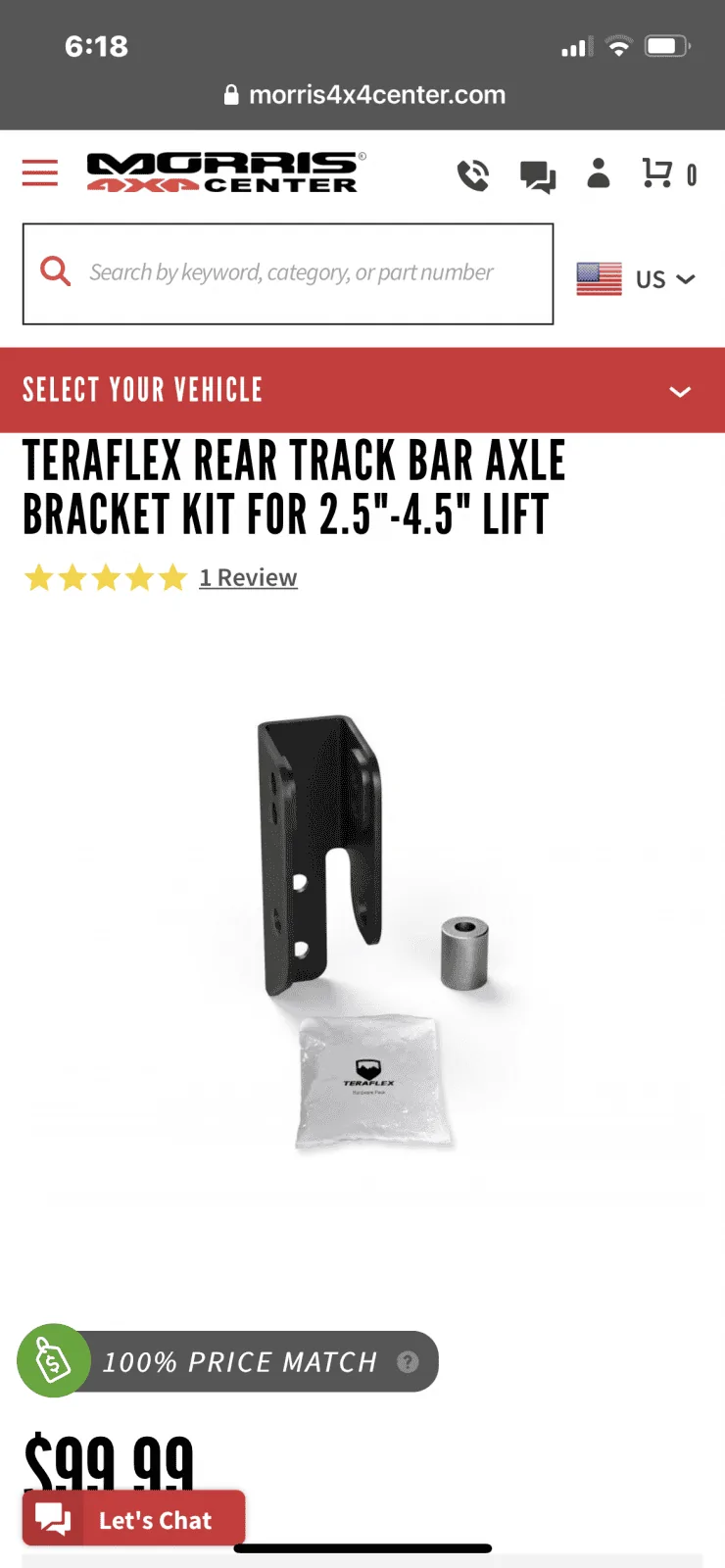

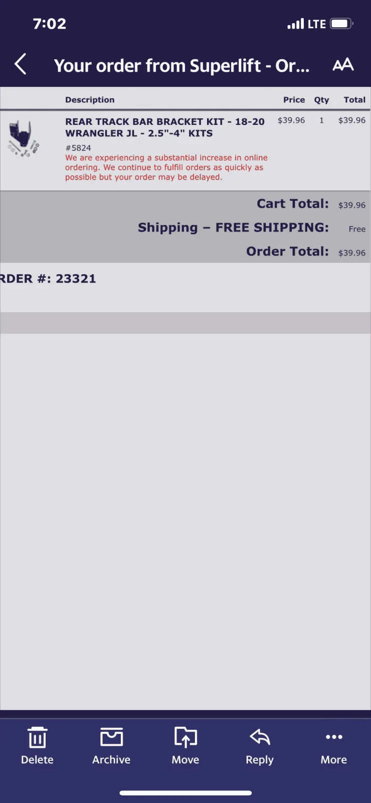

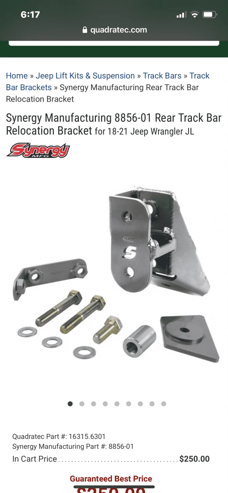

You’ll be surprised when you get the arms by how beefy they are, they’ll work fine with the Mopar kit. In the rear you can just get a track bar relocation bracket if you want. It raises the track bar which will center your rear axle.
The main reason you don’t just use a relocation bracket in the front is because it raises the track bar which gets it out off parallel with the drag link, which leads to bump steer.
