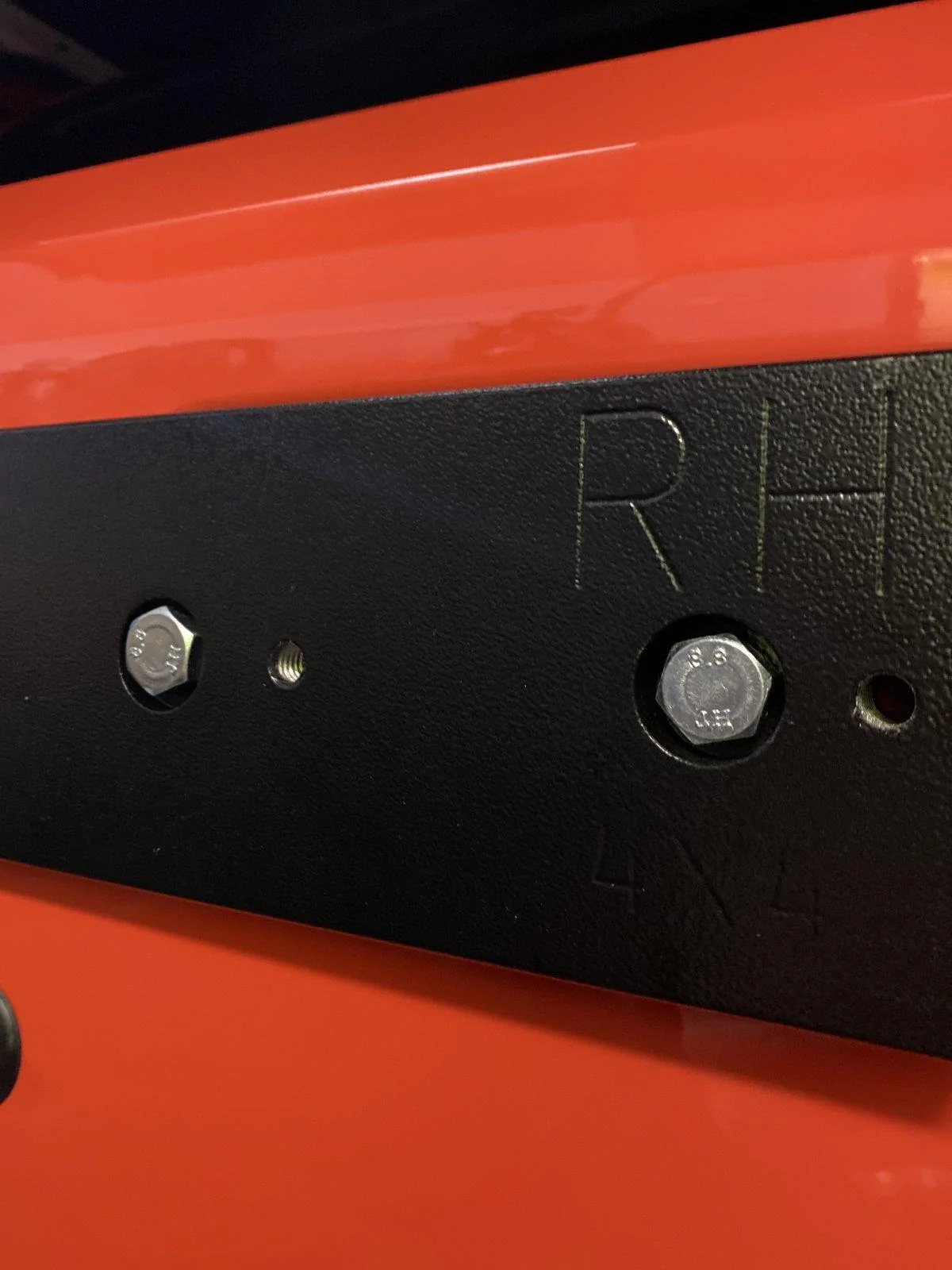

So I’m trying to install @ROCK HARD 4X4 braces. It’s been a nightmare. The bolts were initially completely wrong. They were nice and overnighted new bolts.
Those were still wrong but more right.
The braces attach with 10x1.5x50mm bolts. These use a 17mm socket head.
They fit fine but the recessed hole doesn’t leave enough room for an actual socket to fit to tighten them.
I’m at a loss here.
anyone have any ideas or should I just return/sell this?
Ps I have two socket sets. My impact and my dinky tekton and neither will a socket that fits that head fit that hole.
