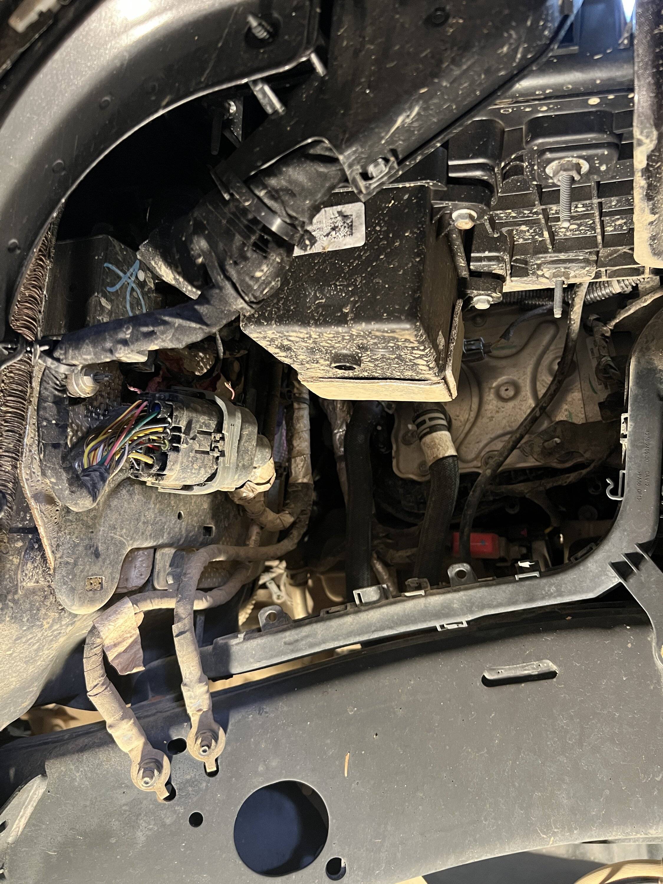

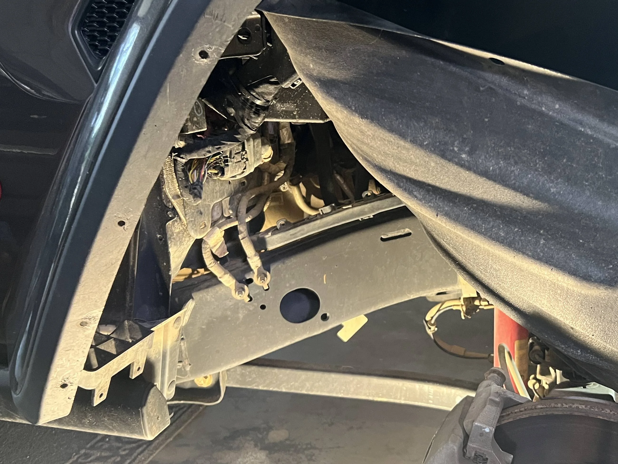

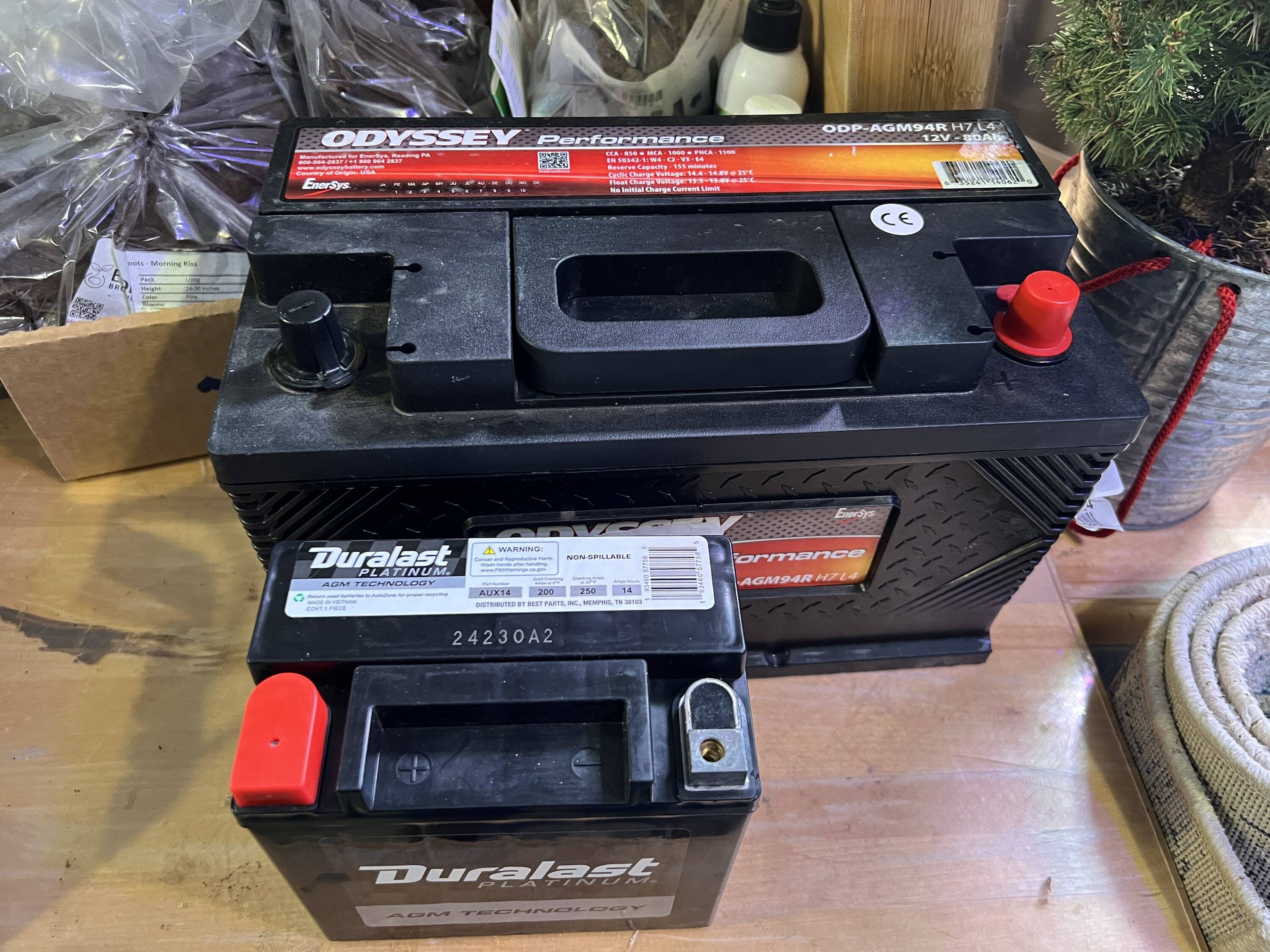

Well yesterday I replaced both batteries in my 2.0 L 2020 Rubicon JLU. My original batteries served me well - since 4/2020.
I’m 69, out of shape, been in treatment for Leukemia for two years and have limited hand tools and mechanical skills. Nonetheless, after the too many videos on how to do this, I figured it can’t be that difficult.
I decided to go the fender liner route because it seemed like this would be the path where I would have the least opportunity to screw something up.
Tire off, battery disconnected up top, small bit in the dremel tool and fender rivets were quick work, a few bolts at top of the liner - boom in a short time the auxiliary was out. One of those fancy battery powered ratchets would have been really nice, but still not much work by hand.
I did make sure both new batteries were fully charged before installation. Definitely the hardest part was getting the 35 x 12.5 tire back on. There must be a technique to this, but I obviously don’t know it.
Fender liner back on with Amazon rivets and a Harbor Freight rivet tool.
Point of this post is simply just about anyone can do this job.

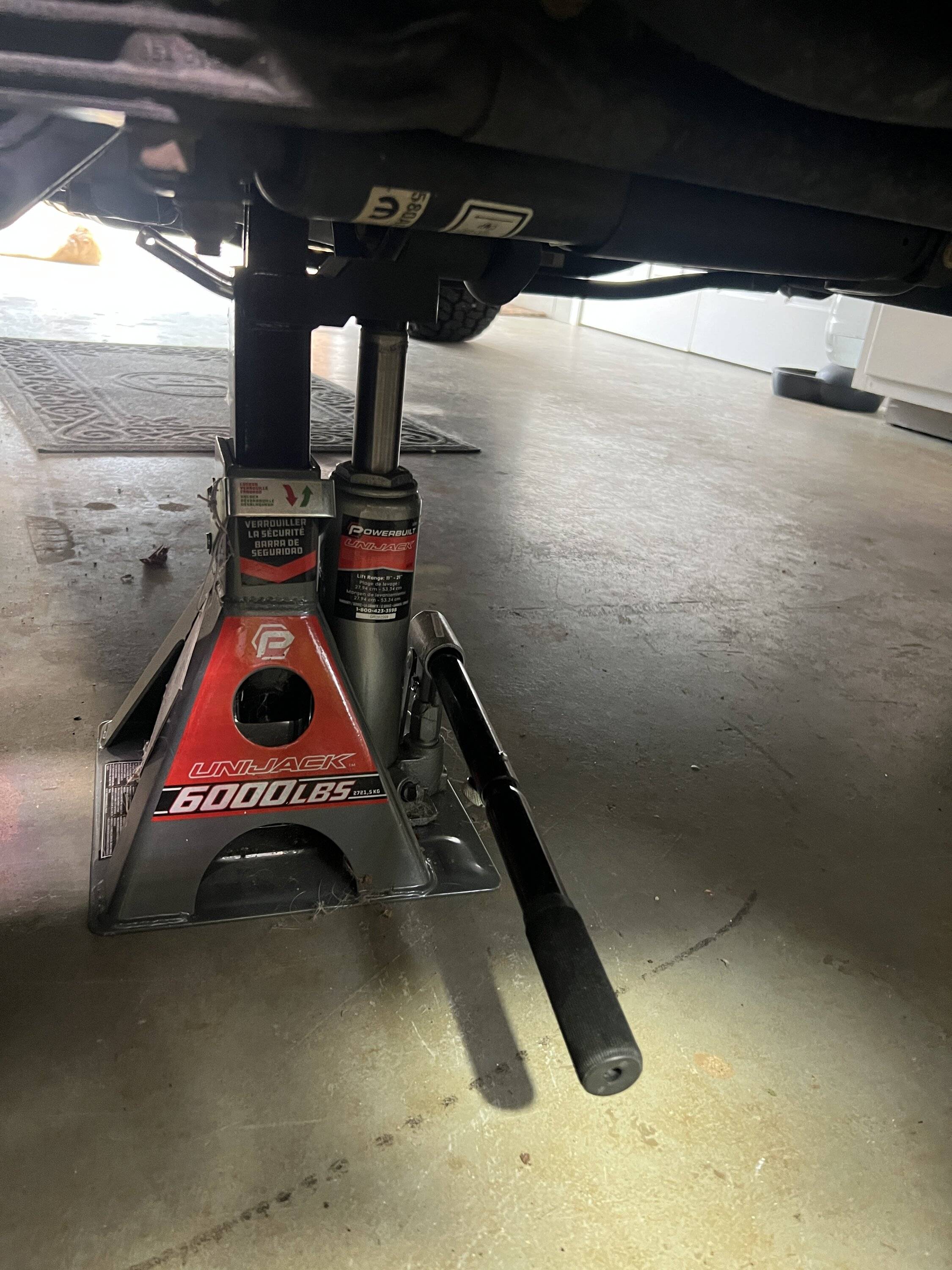

Just came here to congratulate you on using the combination jack/jack-stand unijack. I have two and it is safe and make quick work out of lifting the Jeep. I carry one in the Jeep instead of Hi-Lift.

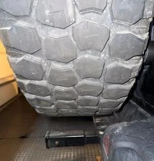

Here are a couple of tire dollies/jacks I've been considering:
The TRAC Jack is very portable and seems easy to use but is priced too high in my opinion.​
The Harpy Eagle is easily portable and more reasonably priced.​
Both of these would work well on my shop's smooth floor but may be difficult to manage on rough pavement and even more so off-road. I am currently using one of my non-jackable car dollies but it's a bit clumsy to align the wheel to the studs.
5-tire rotations are another matter. My tire-wheel combined weigh is 112 lbs which makes it rather difficult for me to hang on the spare tire mount at my age. I use my 12" receiver extension (used to carry my mountain bike rack) to roll the tire up onto. From there I can make the lift by lifting the tire with my thighs as well as my arms to get the spare mounted. Understandably, the stinger prohibits any radical transitions.
