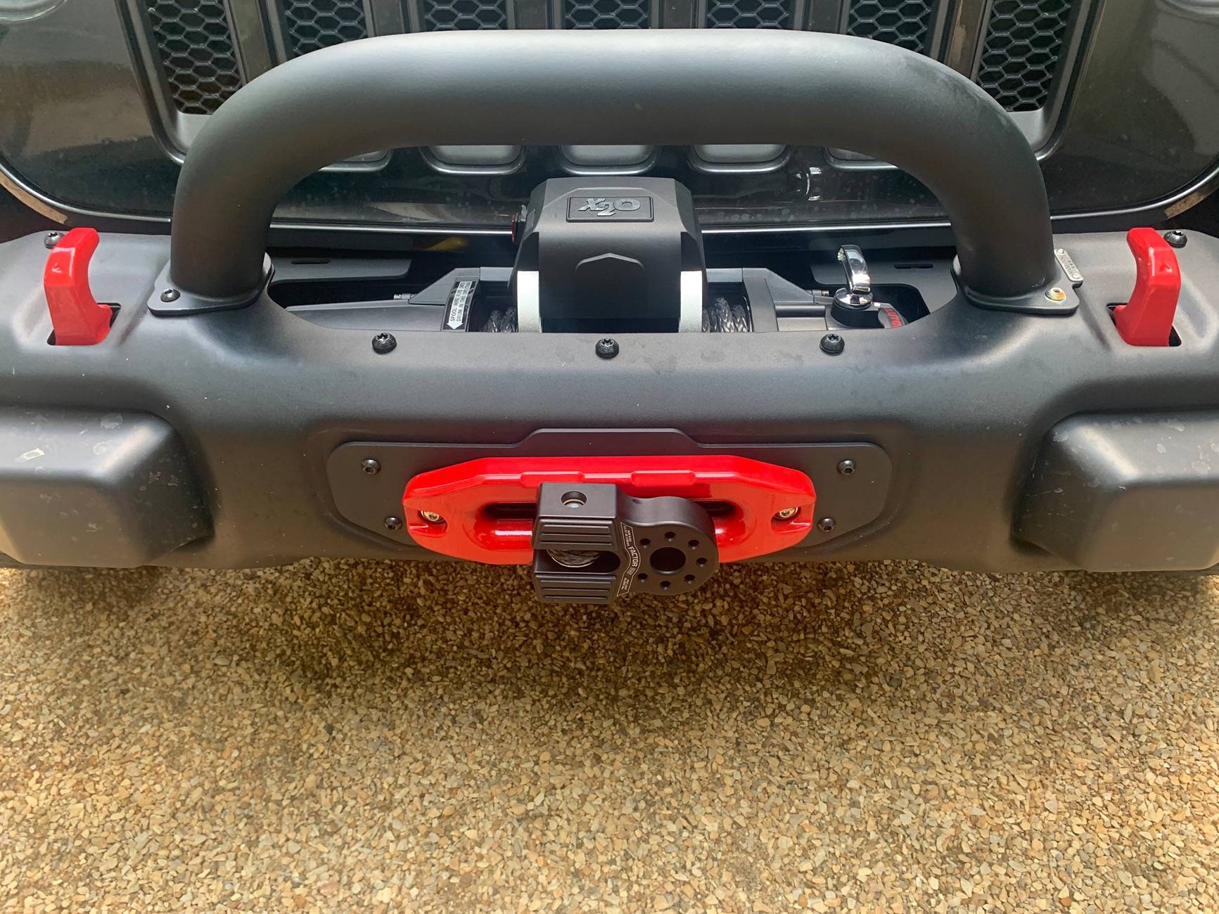

That looks like a stock bumper, did it come with the little bull bar addition?
