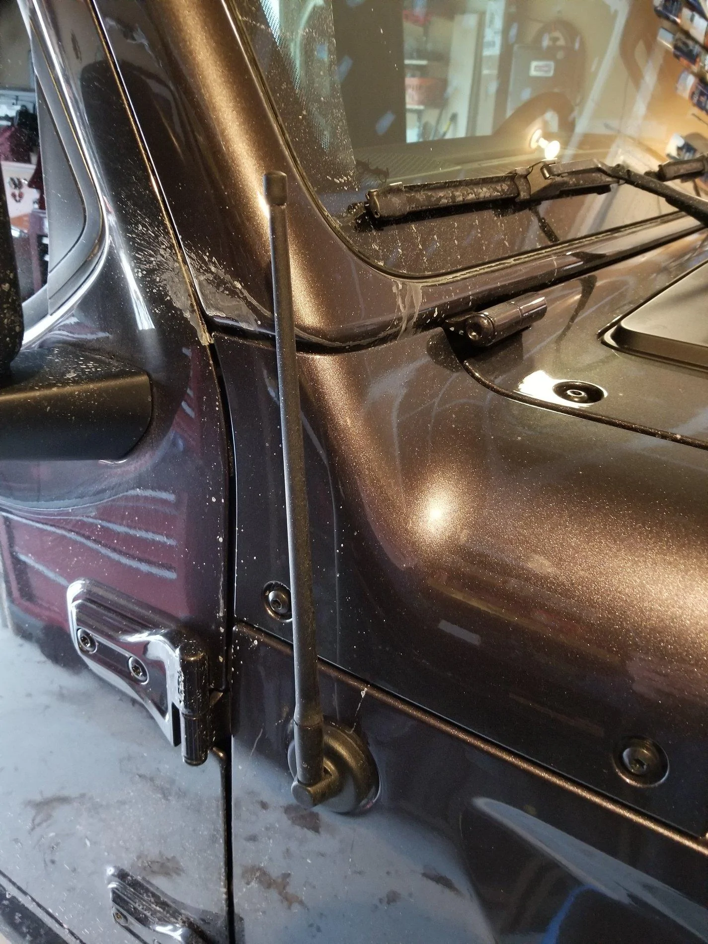

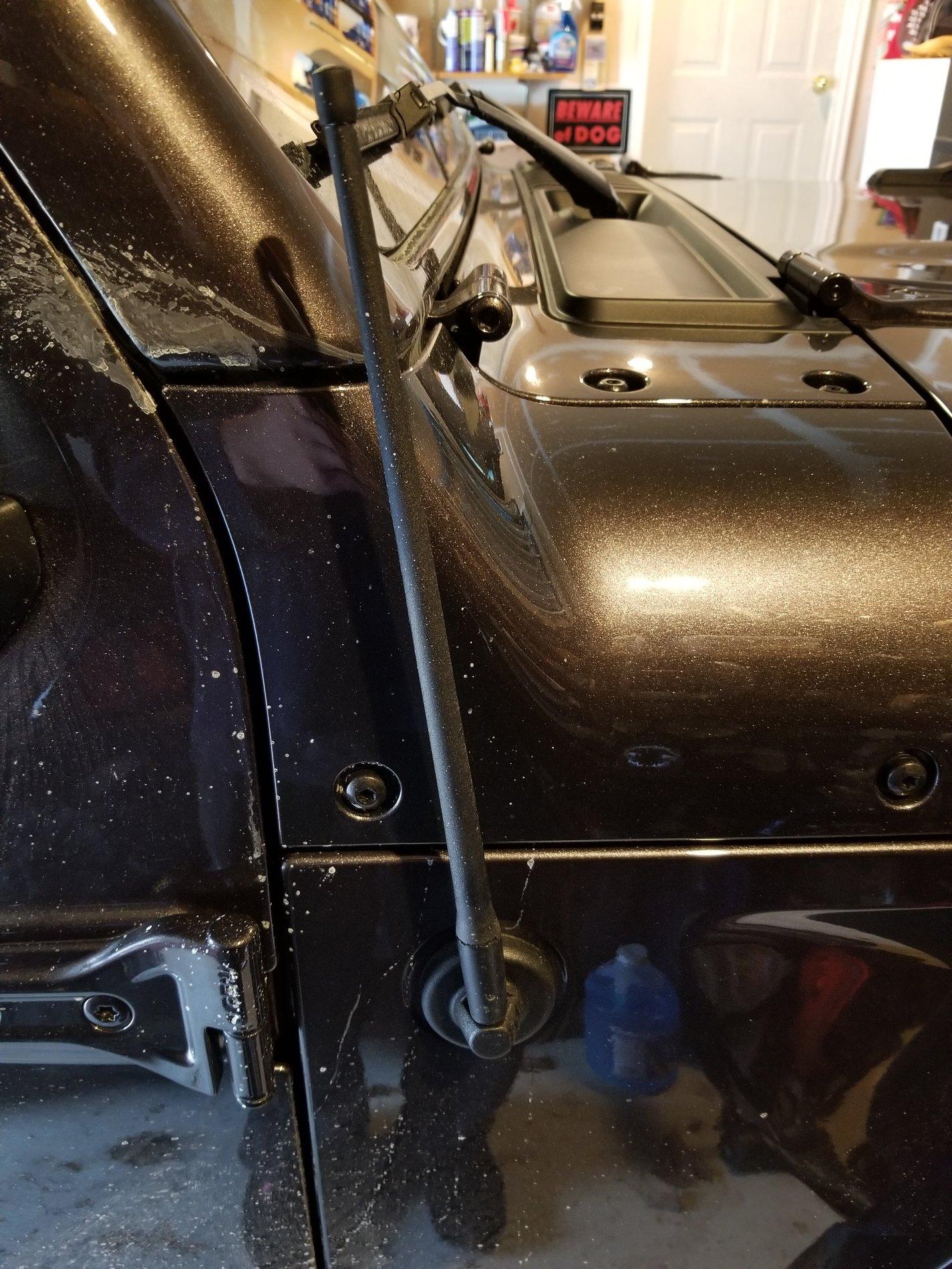

So I went with the 13’ antenna X, I lost minimal reception ( not a big deal to me) seems like a quality item and looks one hell of a lot better IMHO.
