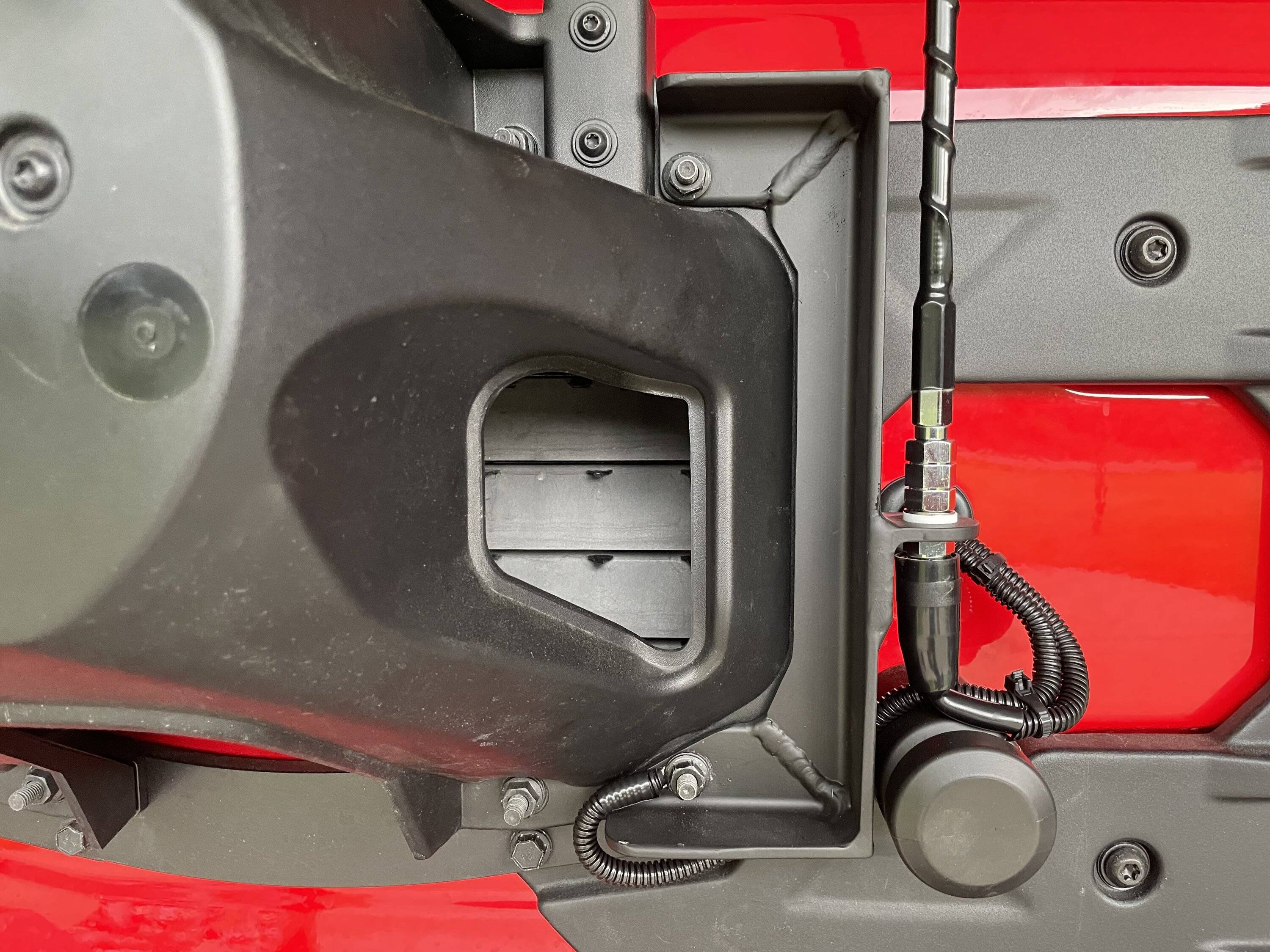

I wasn’t happy with the hole locations in the XR tailgate reinforcement for a CB antenna. They were either too low or too tall for even a 3 foot antenna to get the Jeep through a 7 foot garage door. I looked at many other options of CB mounts online. I finally decided to design my own. I built many cardboard templates then finally cut some aluminum angle and had it welded together. After mounting it I’m pleased with the final product.

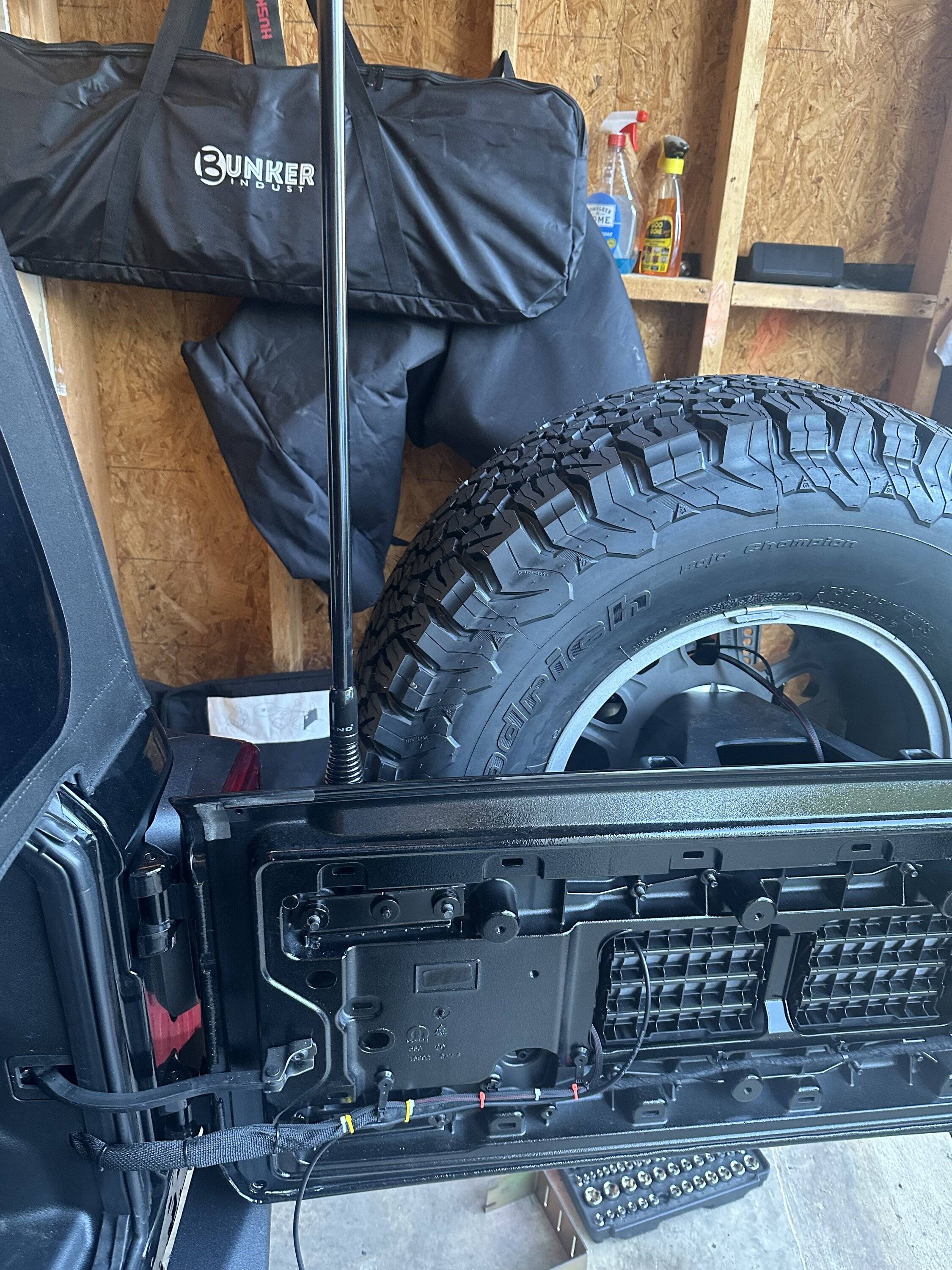

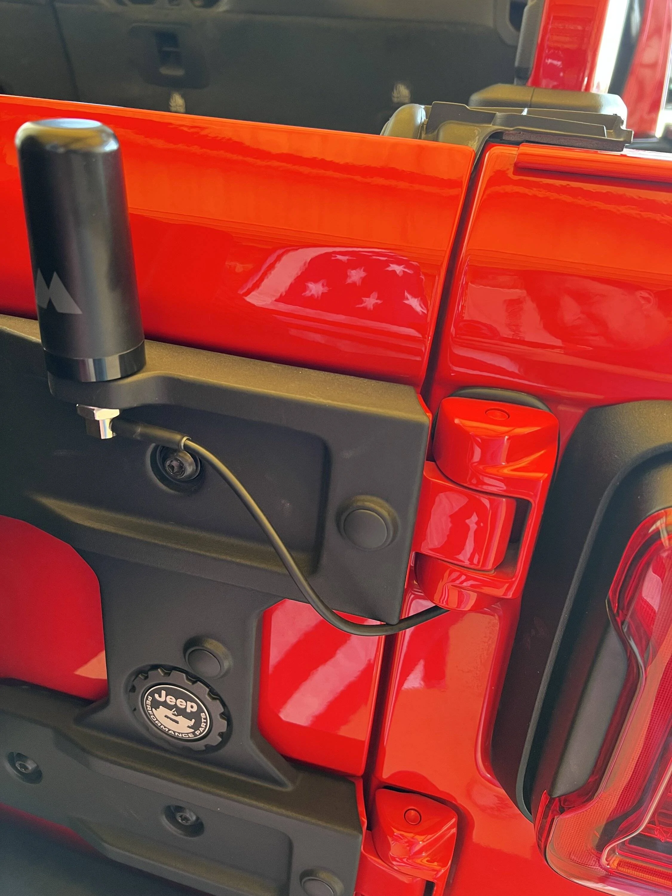

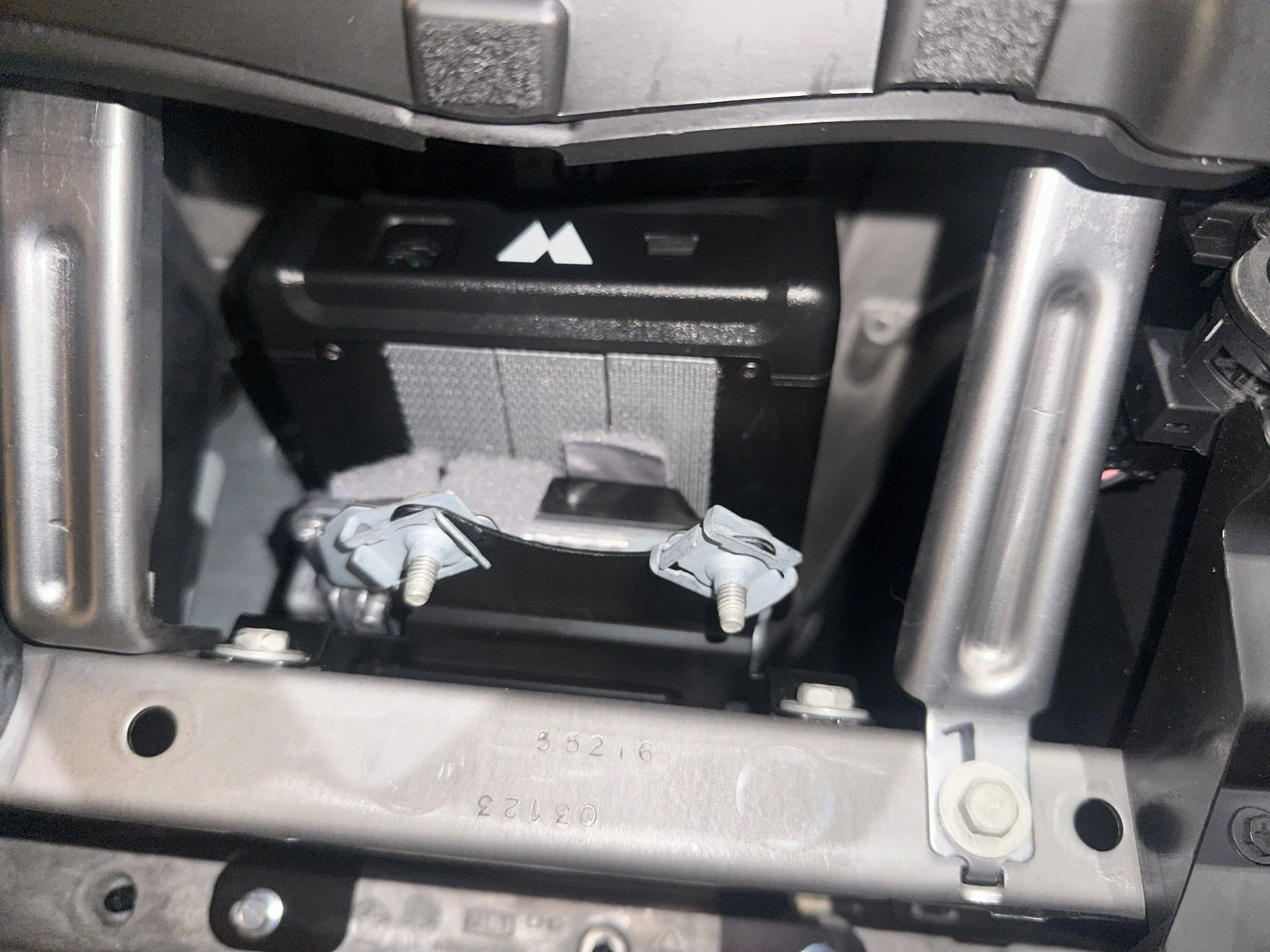

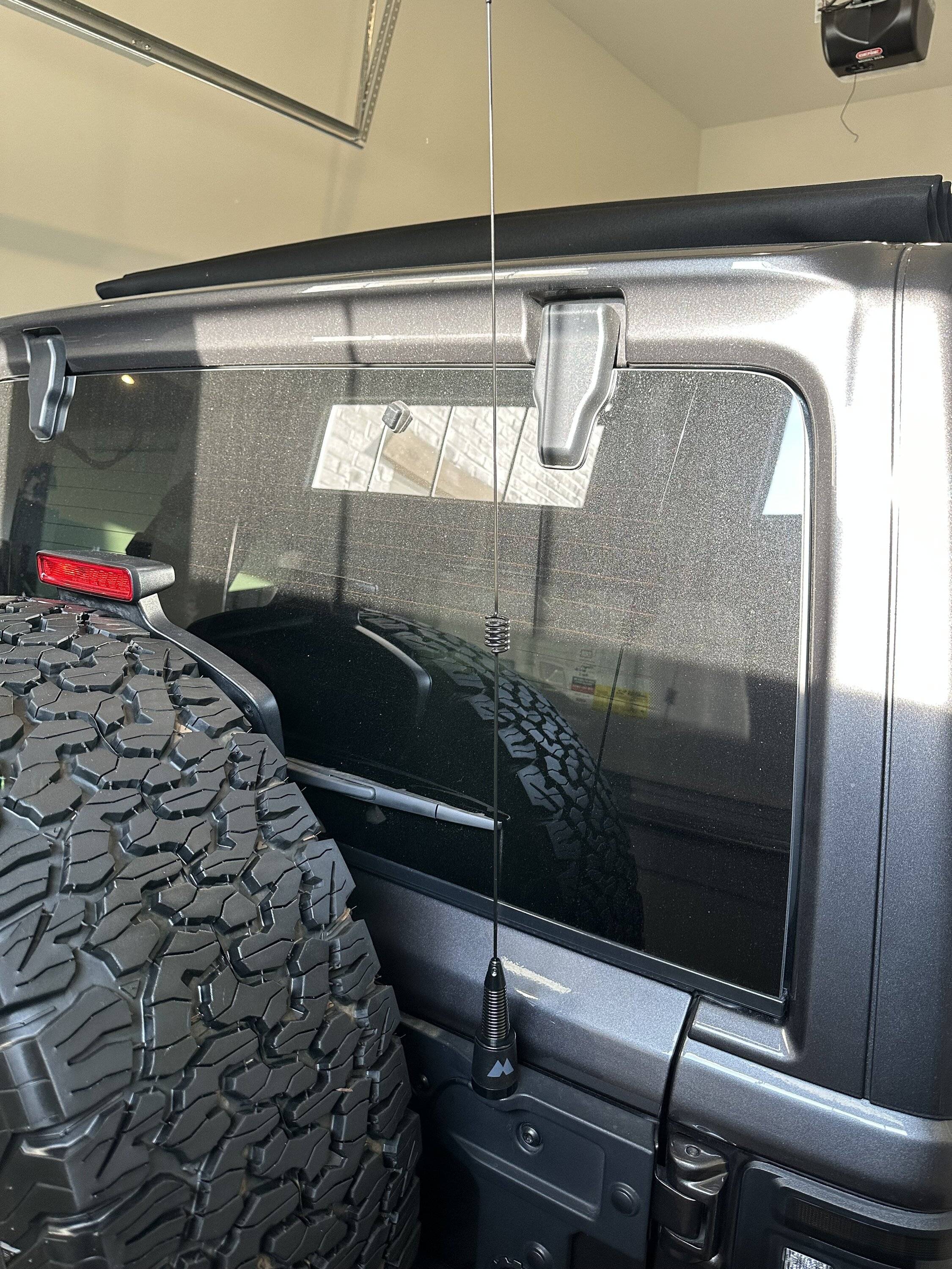

I did what you’re looking to do on my ’22 392XR. You can get this NMO Mount from Amazon that is designed for a deeper mounting hole. Worked great for me. You just have to add the PL-259 connector to it, which is not difficult. Also got this NMO Cap to cover up the mount when not using the radio/antenna.

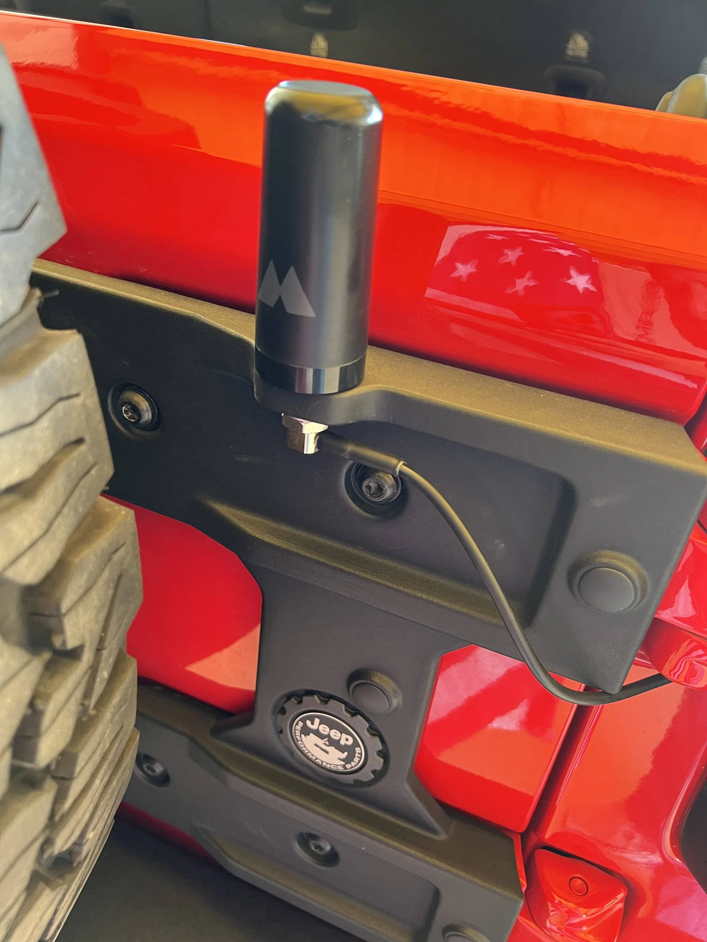

Is that for a GMRS radio? You know offhand what antenna that is? That looks great.
Yes for gmrs radio its the midland MXAT03 canyon edge a little pricey but works great. I have it paired to a midland Mxt575 and love it

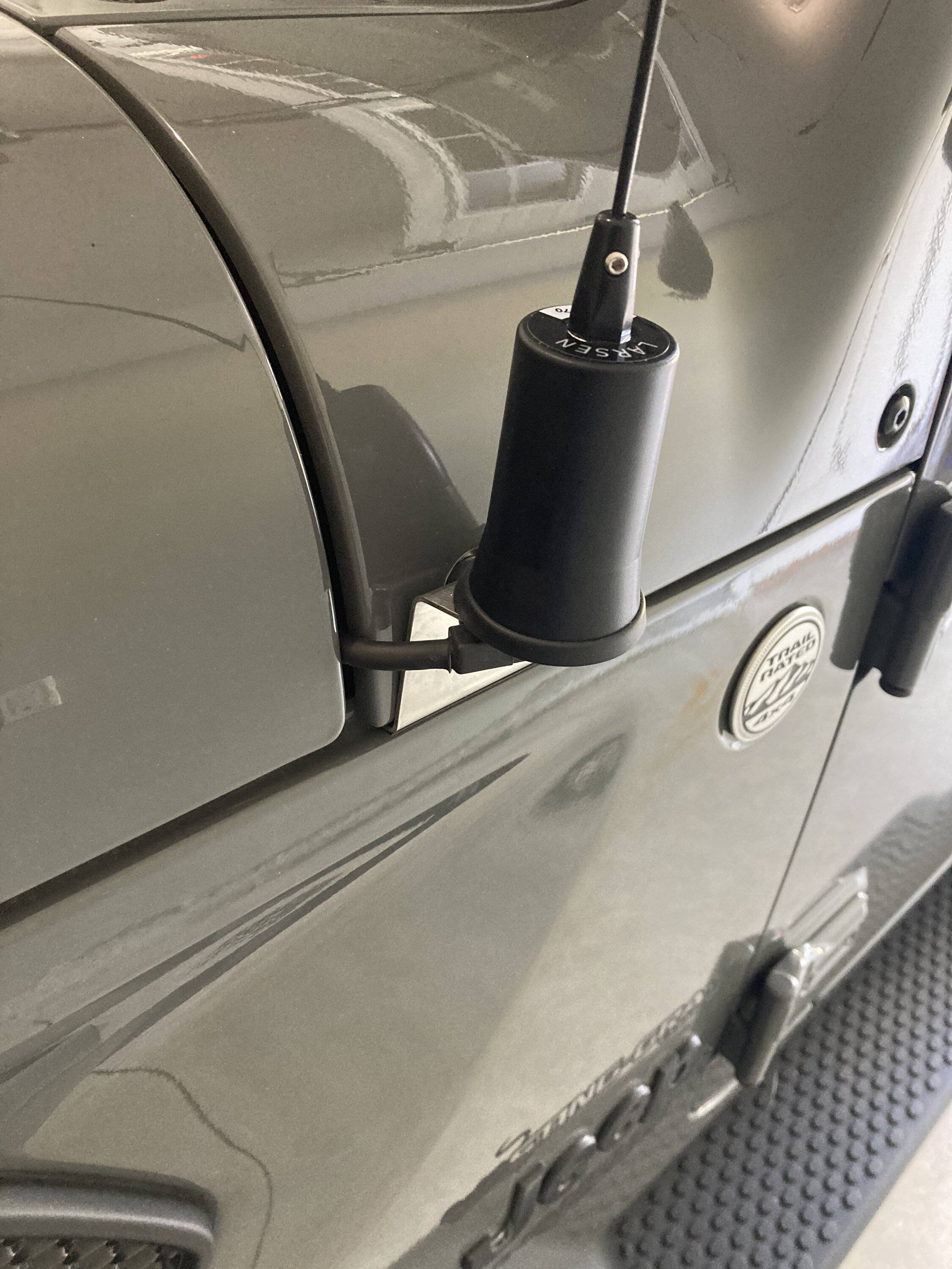

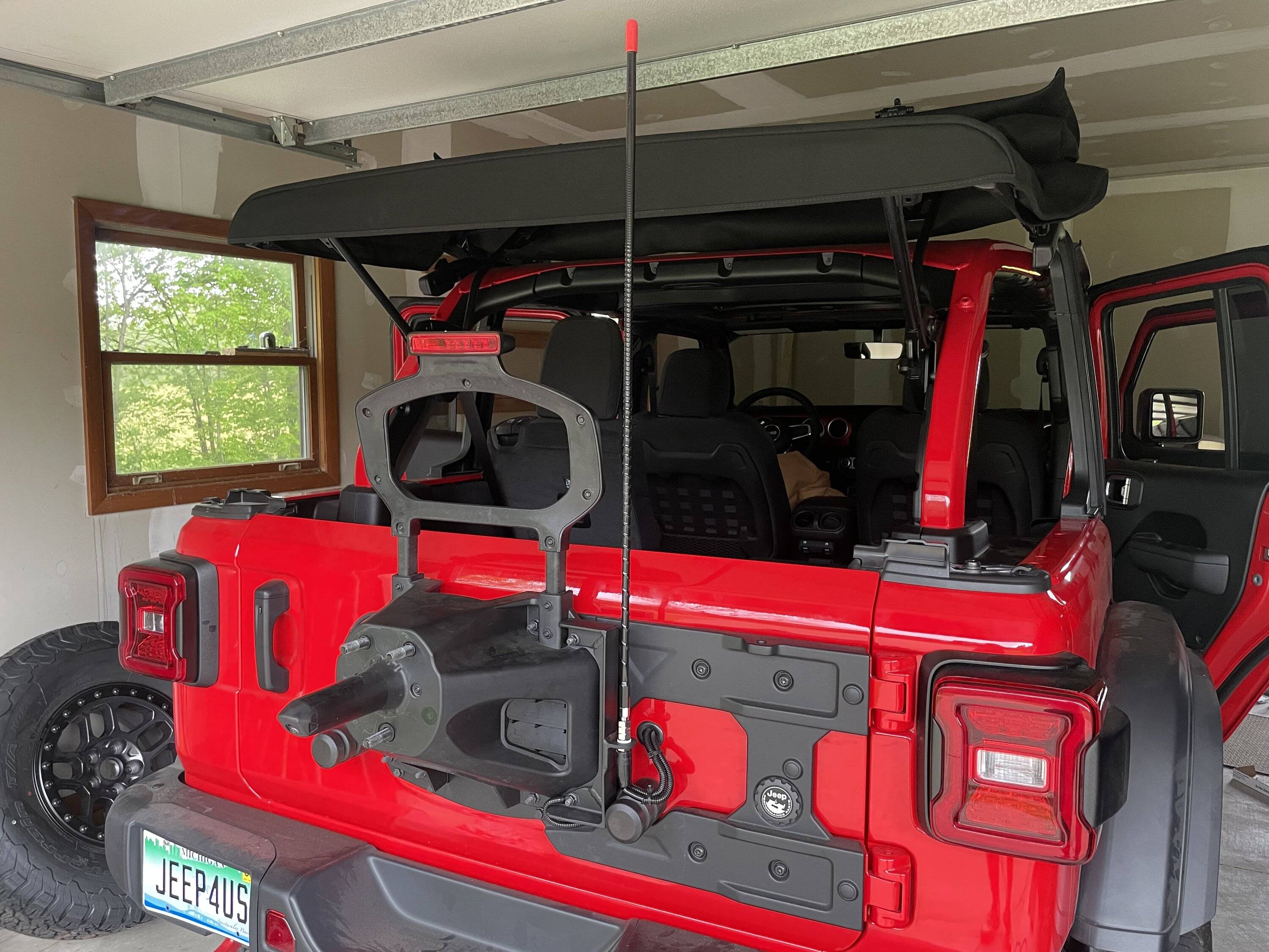

Mine is a 2meter/70cm antenna for amateur radio but I mounted mine in the front to get it as high as I could. You'll lose a great deal of transmitting capability with the antenna mounted so low on the tailgate. As it is mine is too low for my liking. The coil should be in free space too and not so close to the body but with the amount of plastic on these vehicles the roof option is severely limited.

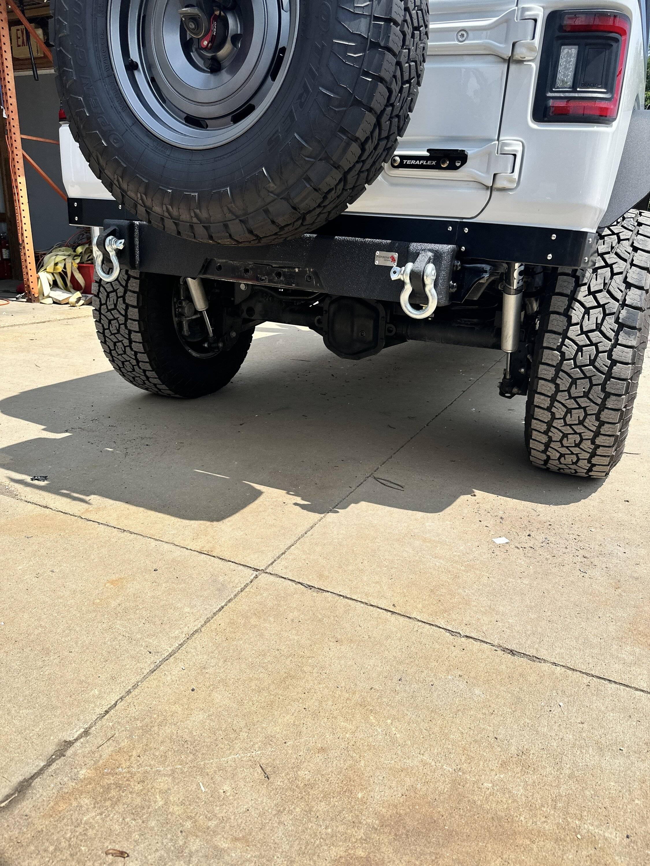

Tereflex makes one… Not sure if it would work for you, worth a look.

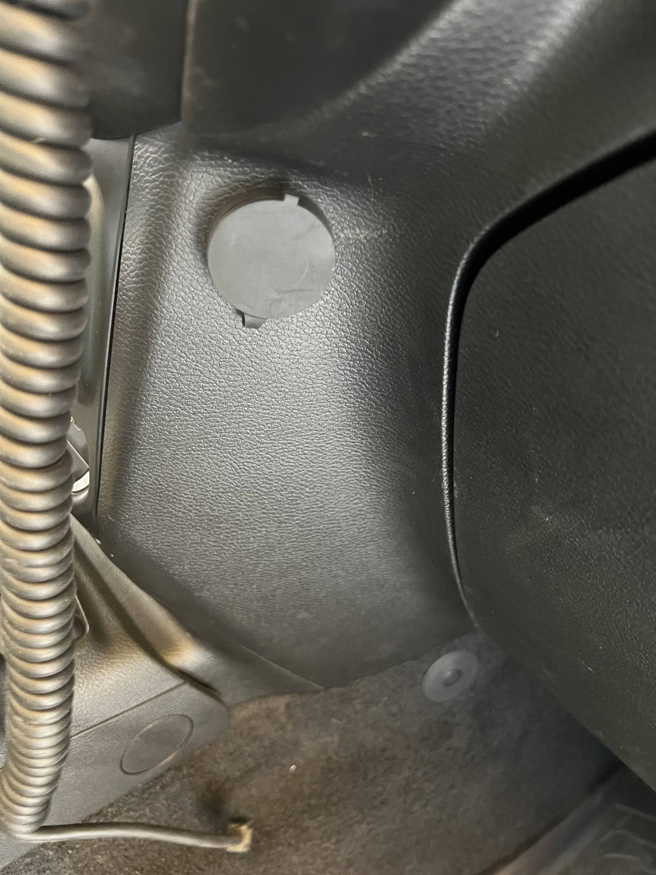

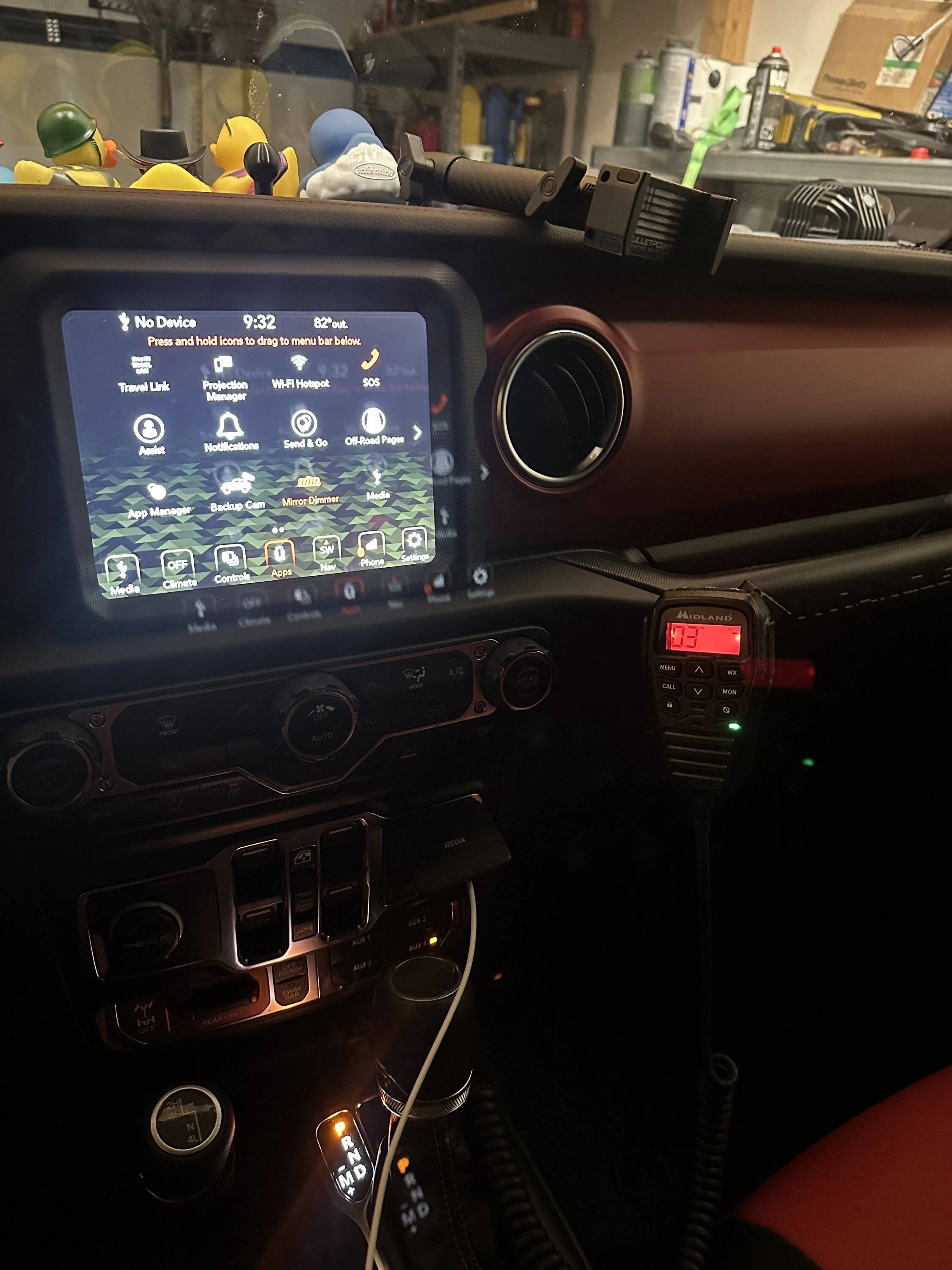

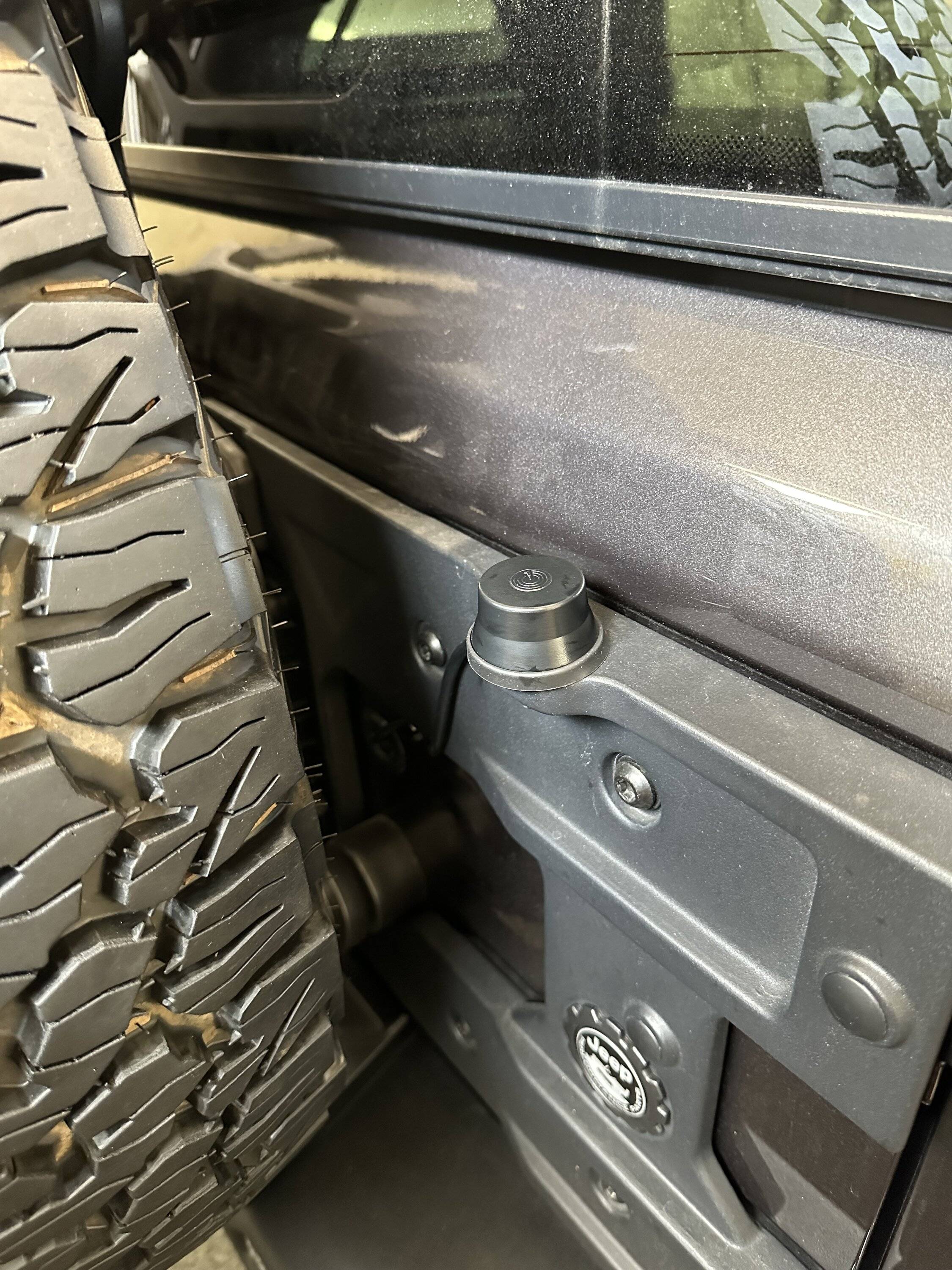

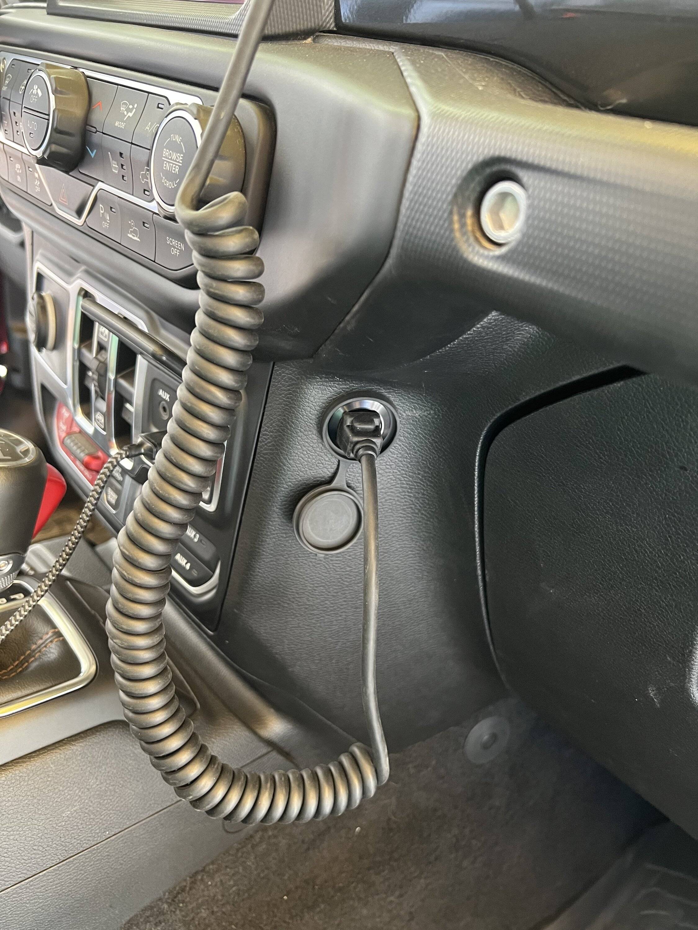

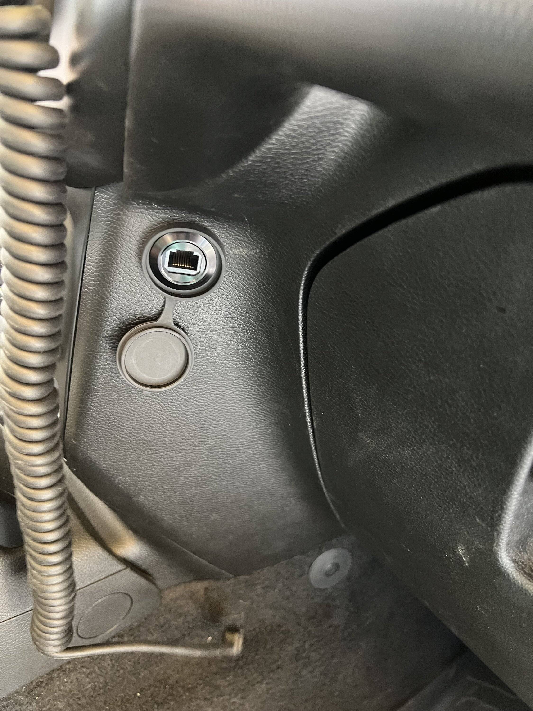

Got my ghost antenna installed on the Mopar reinforced spare tire rack. Thanks for all your replies. Also showing pics of install for microphone plug in mount for Midland GMRS radio. I thought it looks pretty clean.

Would you have a link for the mic plug?
