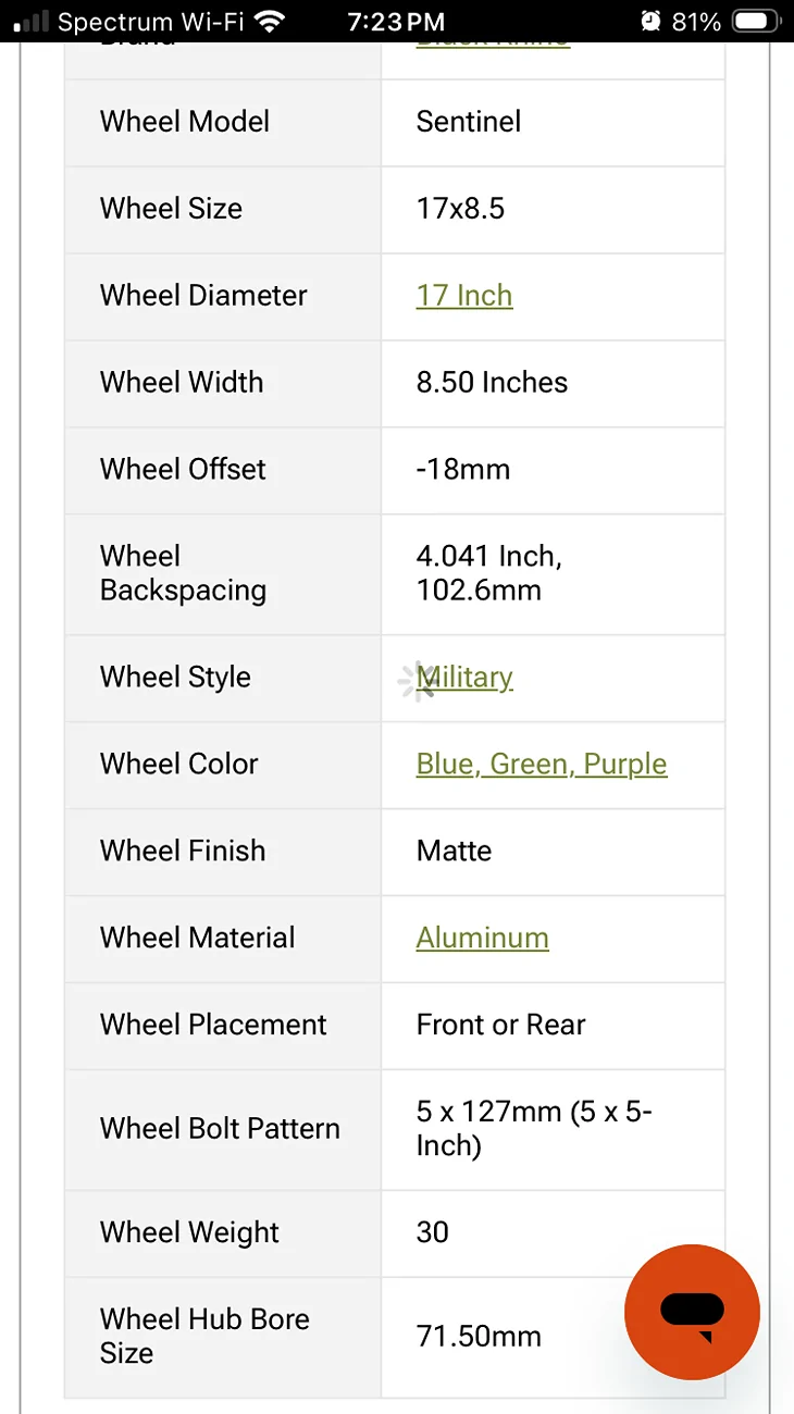

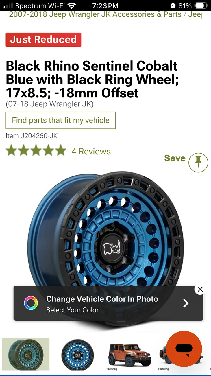

I’m looking at some Black Rhino wheels. I already proved that my rig only sees easy off road trail due to my better half. I currently have a Willy’s -2022, with standard axles, not the wider Rubicon ones. I’m running stock black Willy’s wheels with 6” backspace and zero offset. I had to add 1.75” spacers to make the 35’s and core 4x4 components work. So I’m looking at some black rhino wheels with 4” backspace and -11mm offset. I think this will do the job, but of course the ball joint and wheel bearings will take some stress. Would a 4.5 backspace work, I’m thinking I need at least 4.25 based on the current interference and the fact that the new wheels are 8.5 wide as opposed to my 7.5 wide stock wheels.
https://www.extremeterrain.com/blac...t-blue-black-ring-wheel-1785stn-85127u71.html
Thoughts?
