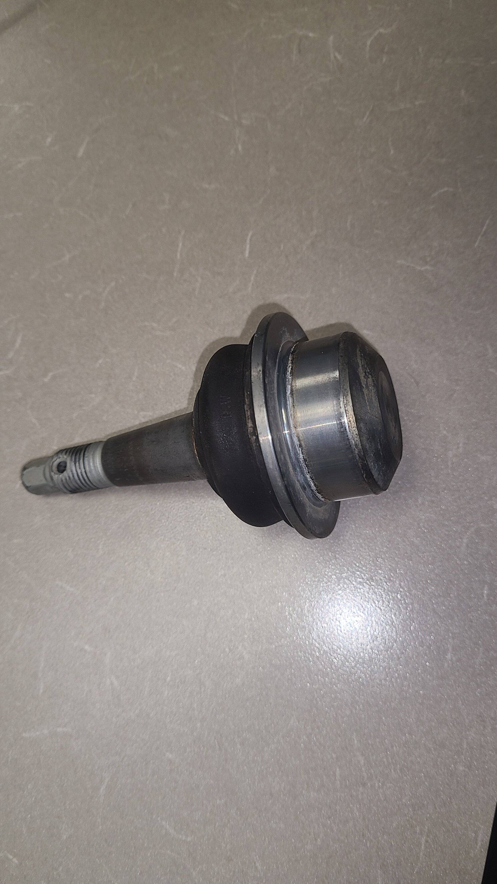

My wife's Sahara had death wobble last year and the dealer replaced the stabilizer which fixed it.
A few months later I upgraded the stabilizer which helped a little bit. I did new LCA's yesterday
with Dynatrac ball joints. It made a huge different than before. Stock ball joints suck.
