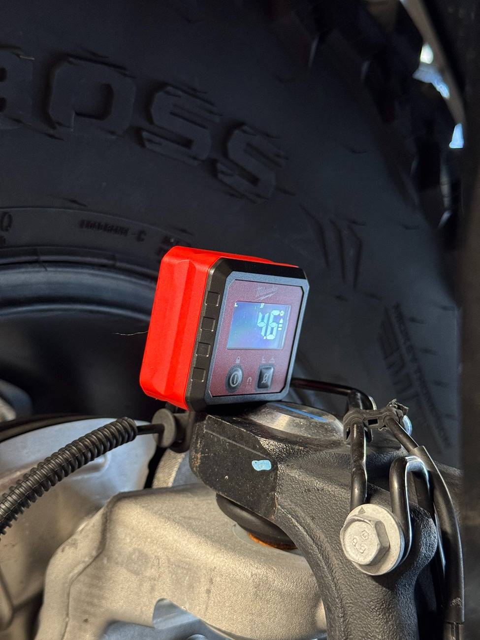

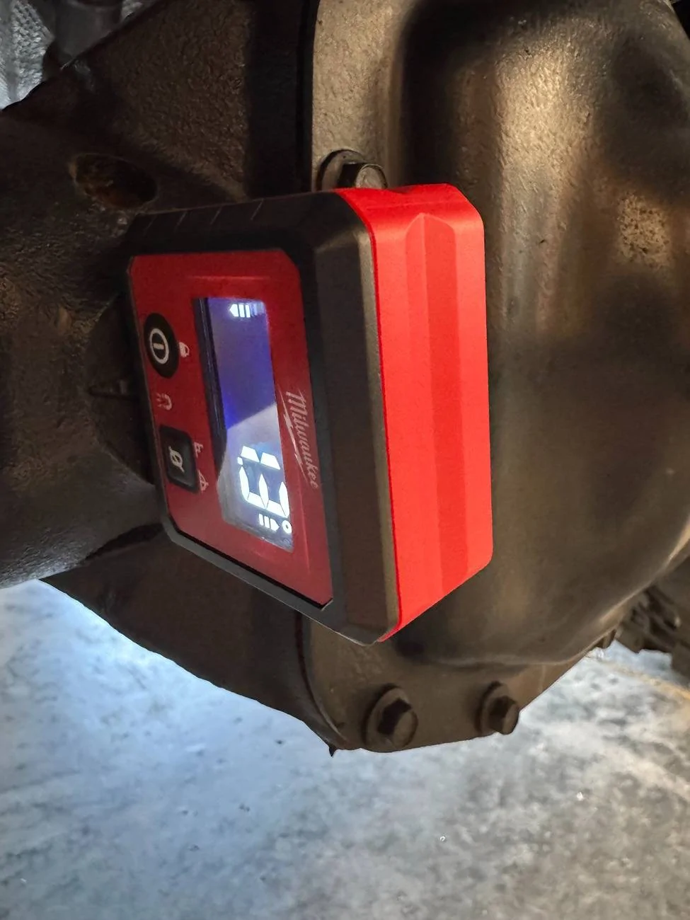

2024 JLU with 4.5" Rock Krawler mid arm(8 adjustable control arms) lift running 40" mickey thompsons. Wanted to make sure my caster is set correctly and these are the readings I get
At the pumpkin

On the C
Jeep Wrangler JL Another caster question IMG_1650
Look about right? Or should I adjust the pumpkin to 0?
Every so often, at higher speeds 65+ I'll get a slight vibration and I read somewhere that could be a combination of the FAD stuff(although mine came deleted) and a degree or two off on caster.
The Jeep doesn't feel super flightly on road and what I do feel is probably just because of the tires, but wanted to check and see if someone thinks some adjustment should be done.
thanks!

Caster is the angle at the pumpkin.

Adjust for 6° positive caster.

0* on the pumpkin where you measured there should give you ~6* at the Cs which is about where you want it. I would bring that pumpkin measurement closer to 0

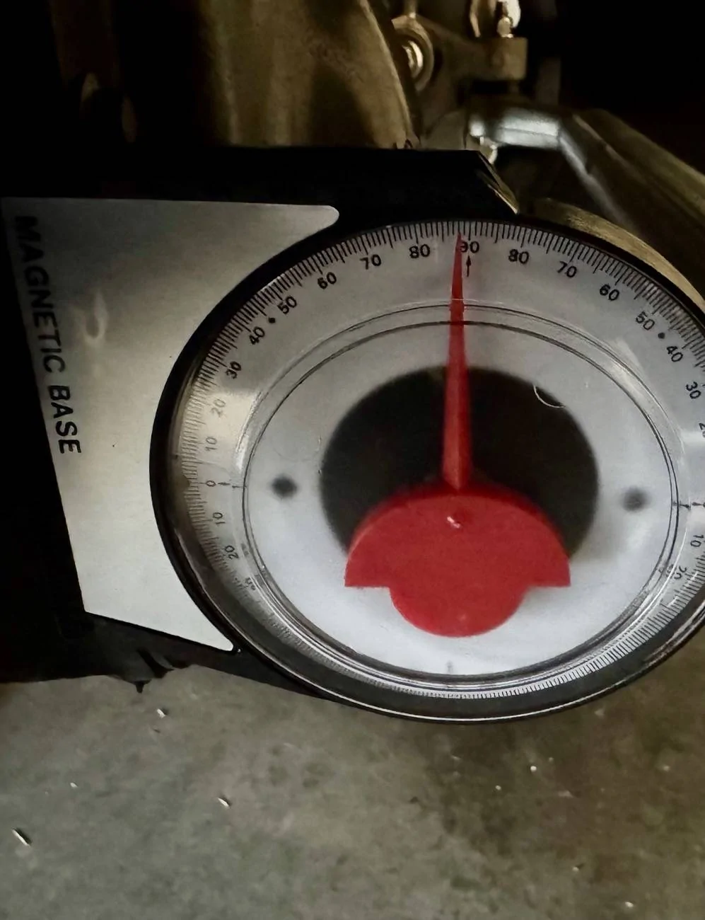

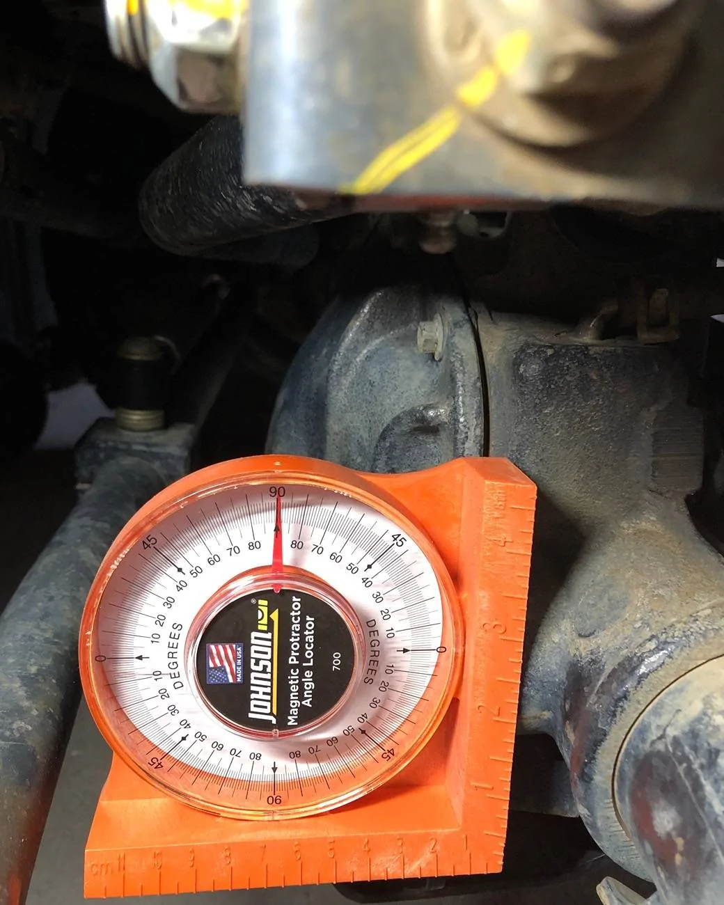

The 1.3 is plus or minus from 6 degrees caster….so your caster is either 7.3 or 4.7. An easy way to to determine it is, with the finder on the diff flat, like in your pic, just rock it up to see if the number goes higher or lower…if the 1.3 goes down towards 0 then your caster is 4.7, if the 1.3 number goes up then your caster is 7.3…there’s other way to figure this out, but this is the easiest way for me…. I actually prefer an analog finder so I can tell automatically to add or subtract by the location of the needle, if it’s ahead of the 0 or behind the 90 or 0 (depending on how it’s on the diff)…. Here’s pic of mine, my caster is 5.9ish…

Ya, forgot I had one of those

Without the FAD, that’s probably as much caster you can run or close to it… you can try and dial some more in but the vibration you’re feeling at +65 is likely the front DS…unfortunately, without the FAD, it’s a fine line between good pinion angle and as much caster you can get….

Interesting observation this morning on the way to work. I usually have it it 4H but switched to 2H this morning and the vibration at 60+mph has disappeared. So I'm guessing this is what you were talking about with the front driveshaft.
