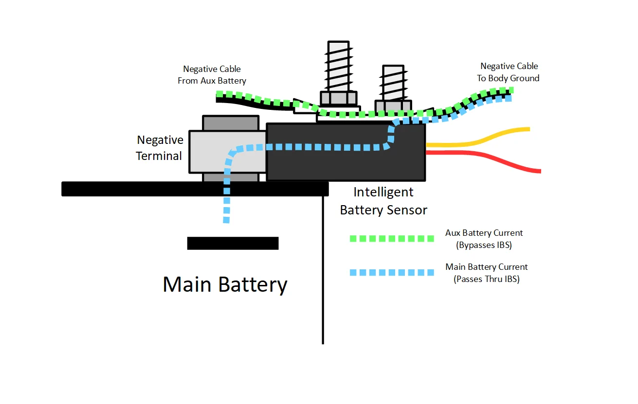

the IBS ONLY senses the crank or main battery
Well, with the OPs ESS battery taken out of the electrical schematic of the vehicle thru the cable disconnect I'd certainly agree with that Bill. But its position on the negative terminal of the main battery, normally from the factory also connected to the ESS battery, I would have thought the IBS is normally gathering intel on both batteries..hmm
Further - many of us on the Gladiator side have proven that it's almost as likely for the main battery to fail first. Some have seen battery failure, replaced the main and gotten another year out of the aux battery.

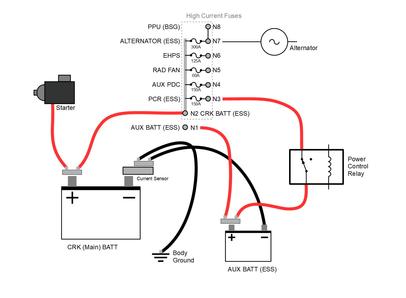

How can it "seek to use only the main battery" ? They are in parallel only when the PCR is closed
...because the PCR is a normally closed relay that is never energized from the factory setup but for an instant at cold crank and ESS events. When normally closed all available batteries are in parallel, and the OP will only have one available battery: the main, hence for the OP, it is only the main battery.
The main battery isn't connected directly to N1. the aux battery is always connected to N1.
only the main battery is connected to the starter directly.
True. Only the main battery is connected to the starter, but it is also connected to N2, which when the PCR isn't energized is connected to N1:
Jerry's diagram:
Jeep Wrangler JL Another battery question{sorry] 1706737635186
When the PCR is closed, there may be a small bit of current from the aux battery for cranking, but it's going through a relay and smaller wiring, not going to aid much at all, and if it did, then the drop in voltage due to cranking would kill voltage to N1.
A small bit current..maybe..but enough to crank a JL, in fairness on a relatively new ESS/Aux battery alone:
Would like to see how that is drawn out electrically, a schematic.
As requesed....see above.

I think he means the main battery provides the vast majority of starting current because it's connected to the path of least resistance., not that the ESS battery/wiring couldn't supply it.
But the ESS battery starting demo appears to disprove the suggestion N1 voltage would be "killed".

My question stems from the physical installation of the IBS evident on our vehicles. If there's intelligence, so to speak, that it uses to segregate batteries for reporting purposes, etc., that's the intel that's being sought.
Another forum member actually diagrammed the ESS current path over the IBS. And, rightly pointed out current could flow between the batteries across the IBS if one is charging the other.

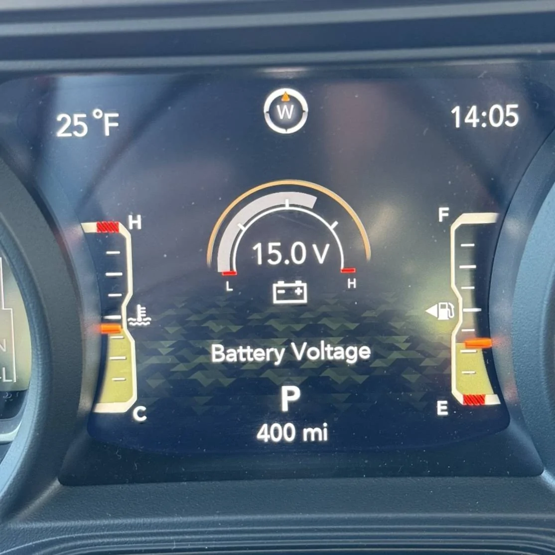

My understanding is it maxes at 14.4V. Is that not correct? What's the source for the 15.0 figure?
Jeep Wrangler JL Another battery question{sorry] IMG_8115
Mine was showing this due to an overcharging situation I was having a week or so ago.
Both batteries load tested poorly and were changed out.
I haven’t seen anything over 14.8 since.
