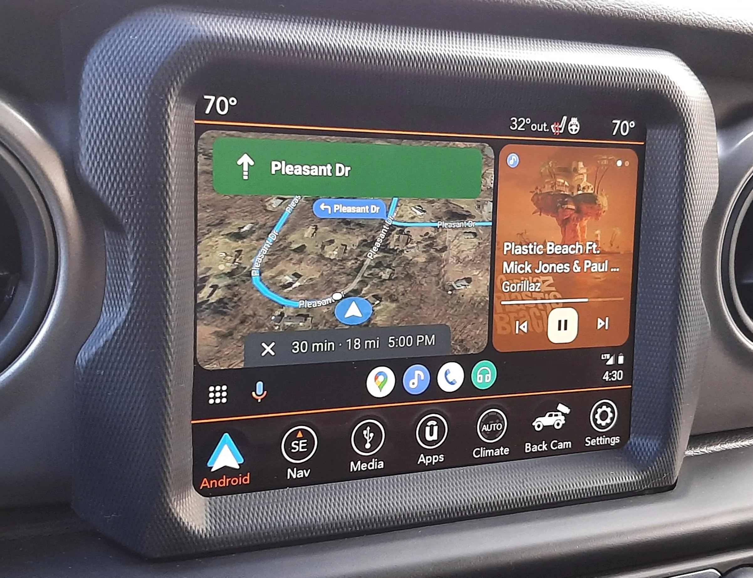

Well well, look who showed up today :)
Jeep Wrangler JL Android Auto - Smartphone App Update Related 20230202_163025

Yeah I don't need to watch YouTube in the right 40% while I'm driving. :giggle: Fortunately it's a touch screen so a tap on navigation brings it back to full screen.
Disabled YT in settings but we'll see what it does next time. I really don't need more steps in my vehicle start procedure. (Neutral, run, voltage check, clutch+ignition, ESS, driver console set, pheun unlock, plug in phone, handbrake+departure depending, display to fullscreen navigation, destination select).

You really go through all of those steps??
I just verified that mine comes back with the same settings each iteration. No need to switch to fullscreen each time.
