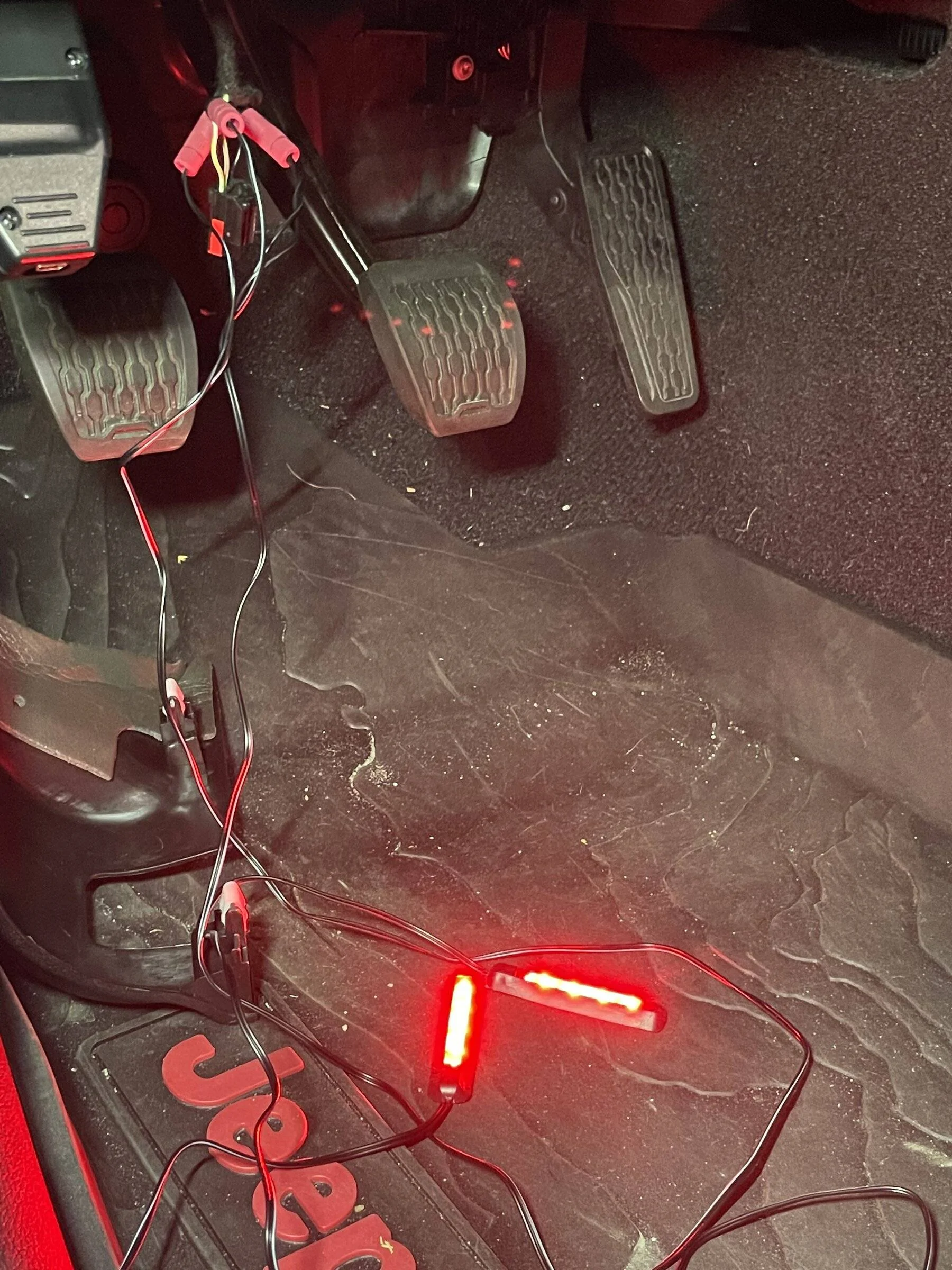

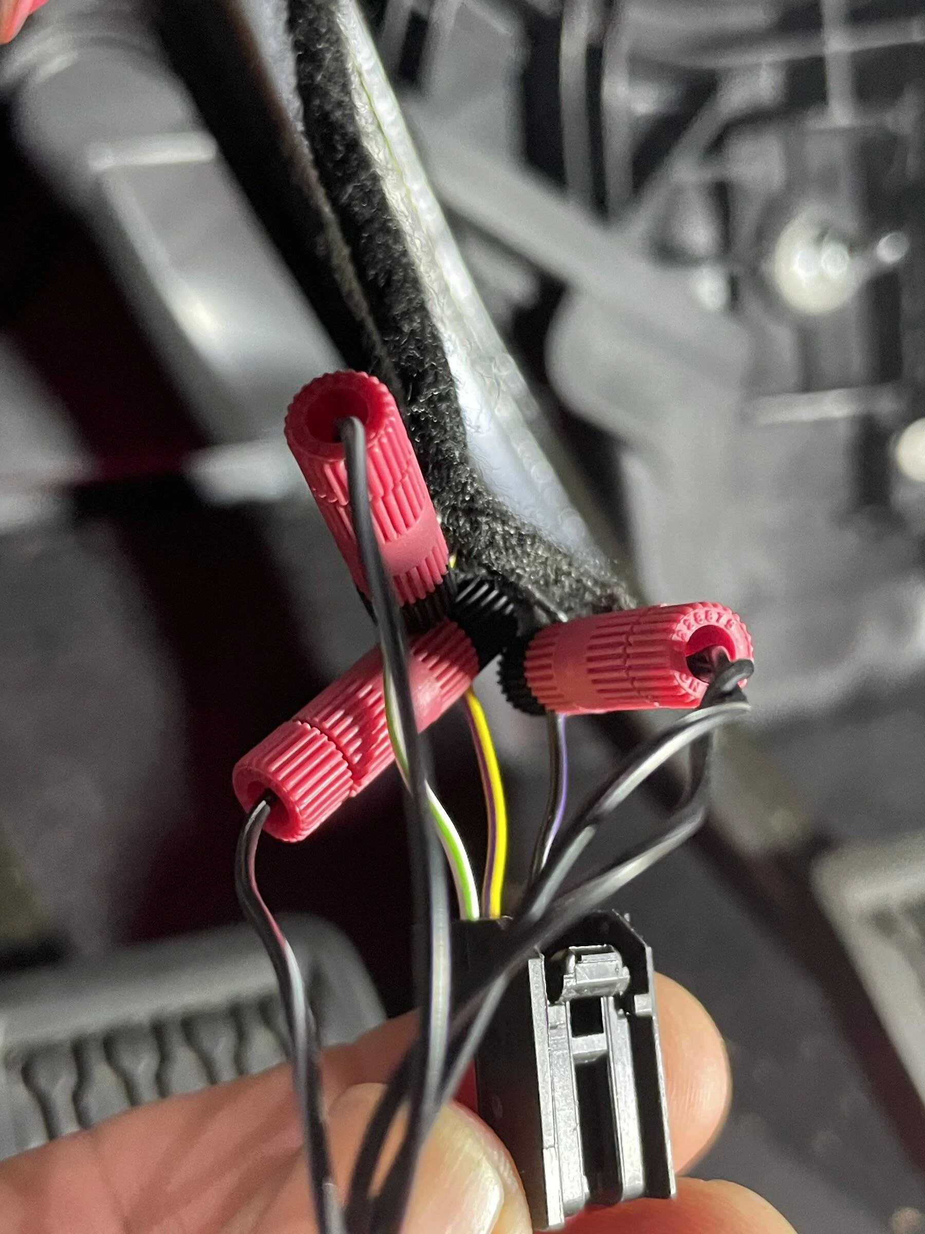

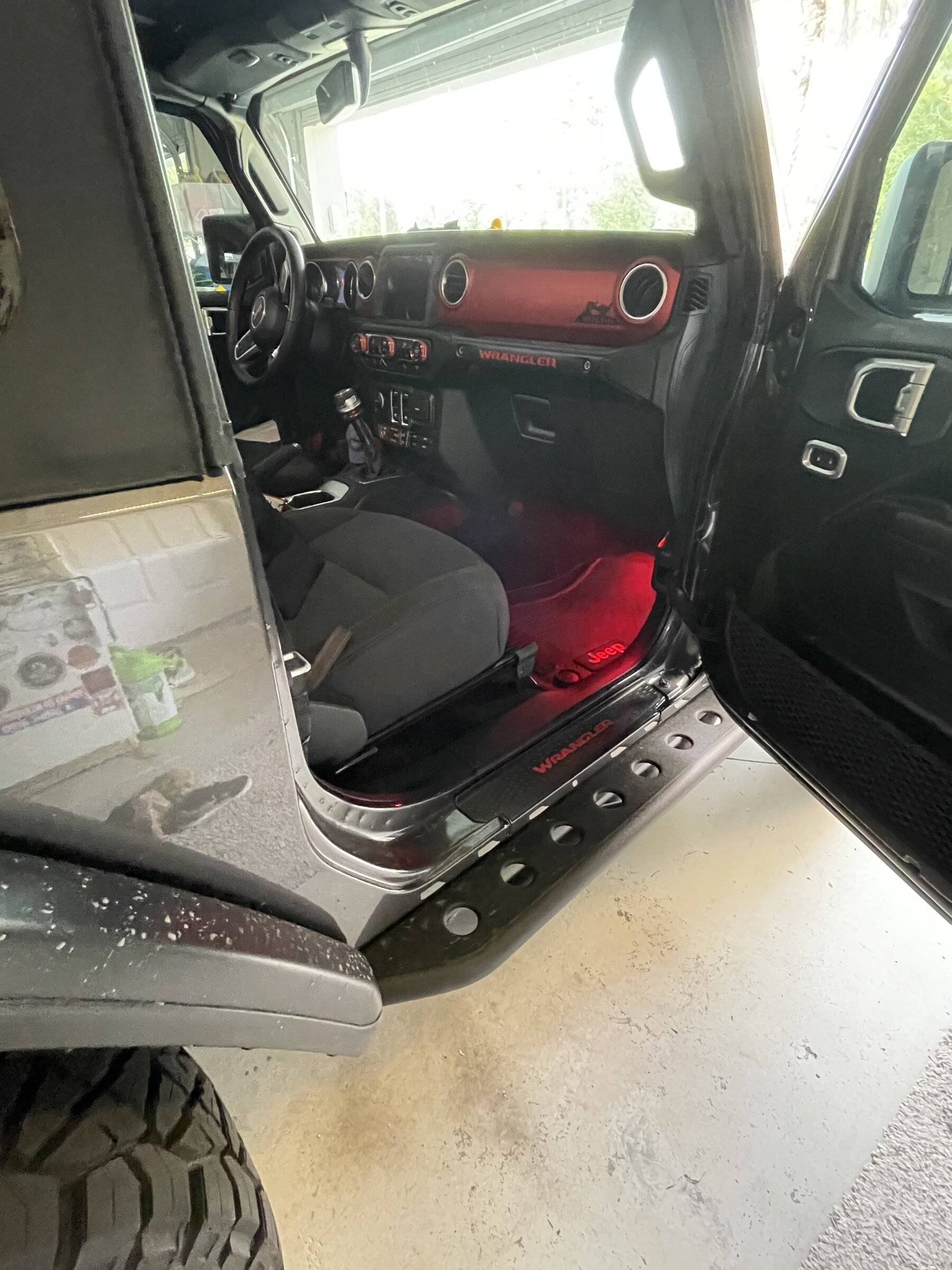

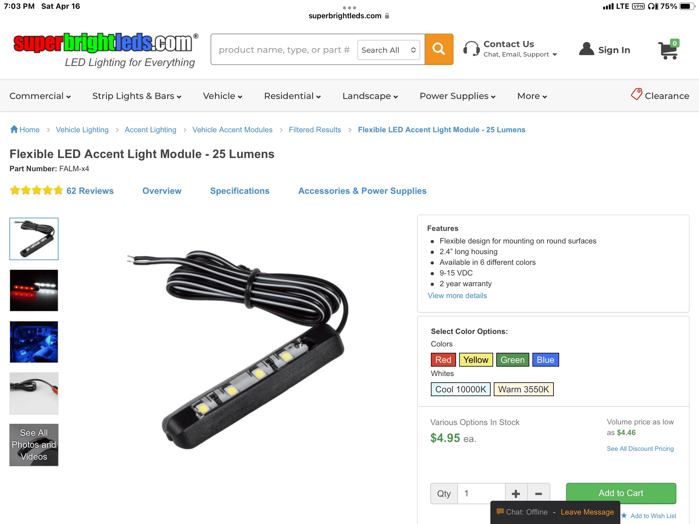

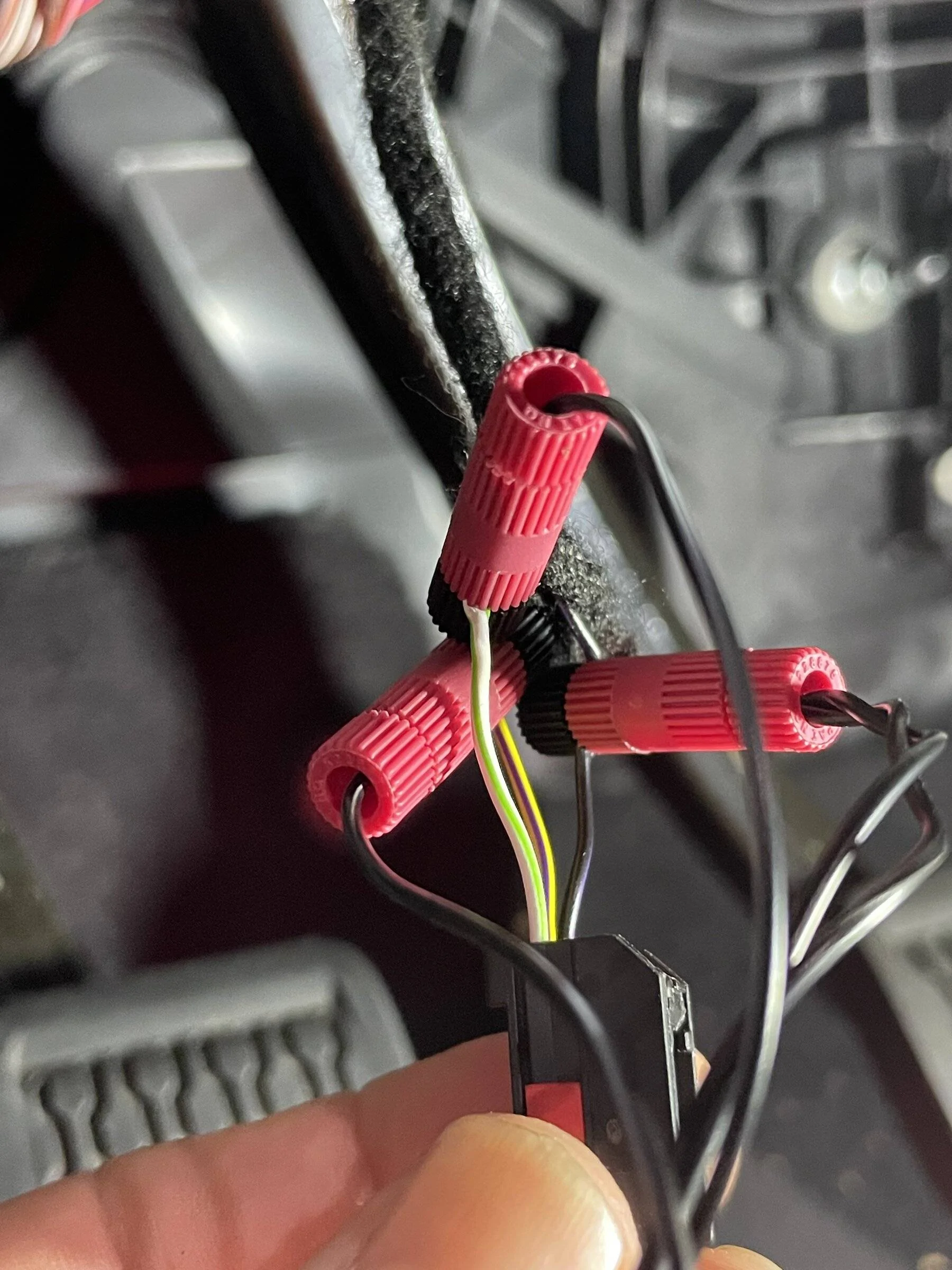

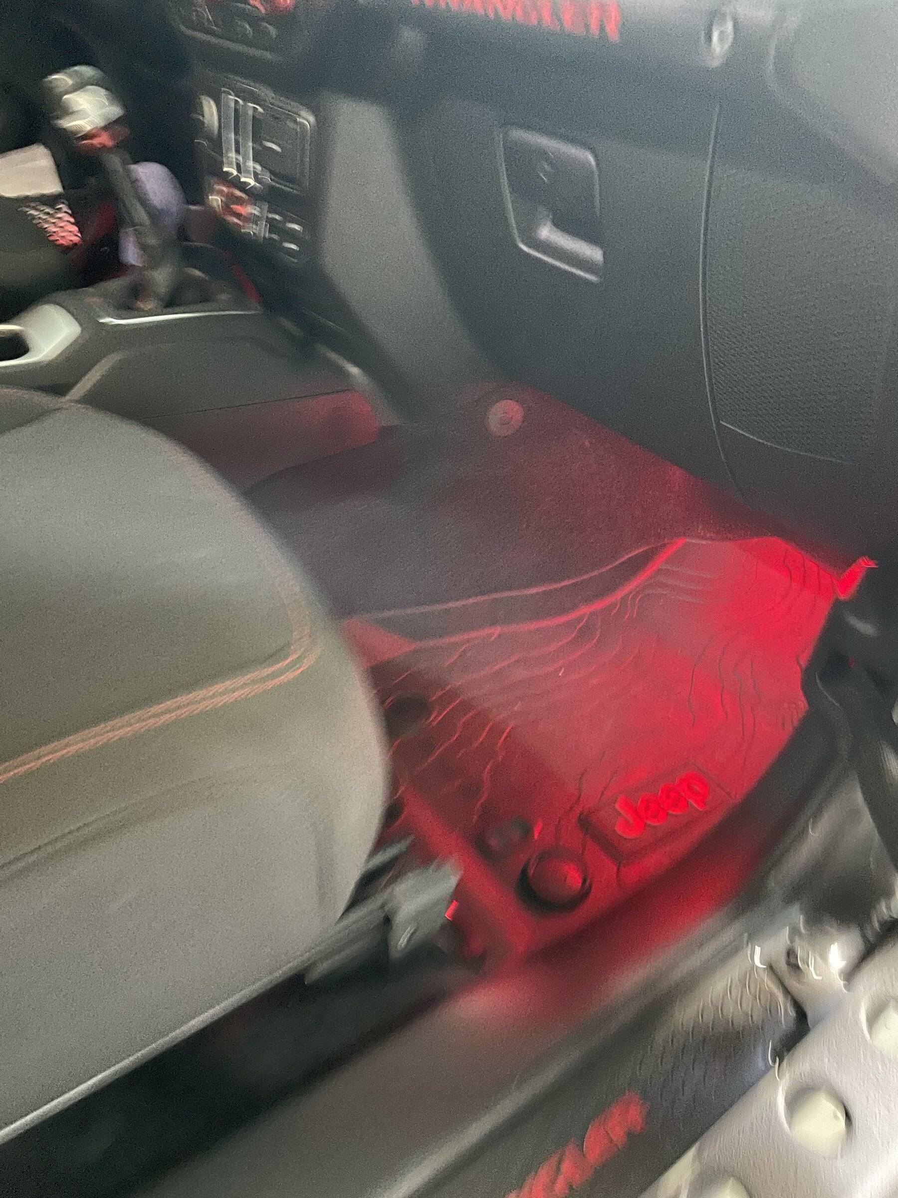

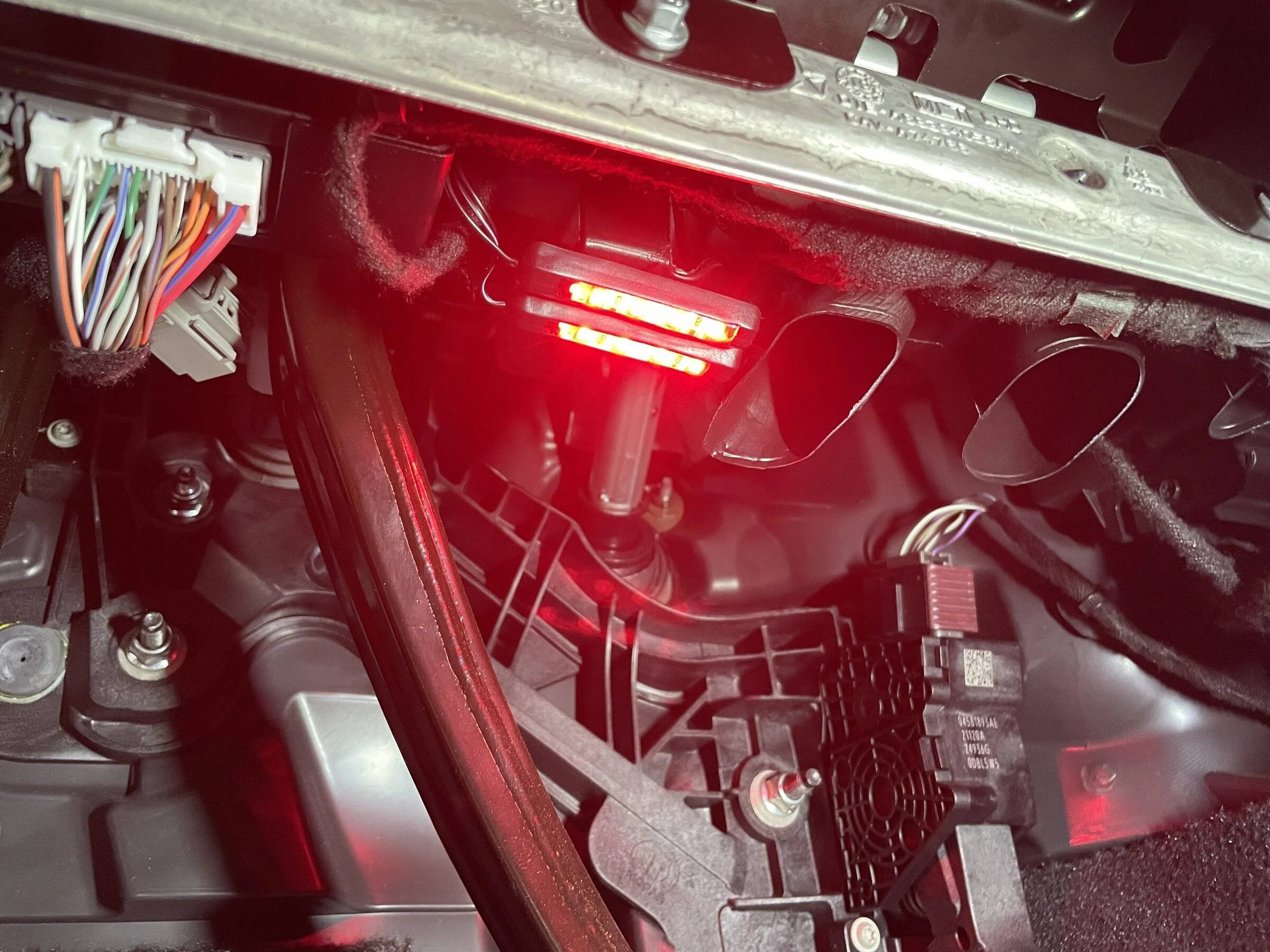

Thanks David. Project complete. Disconnected the stock white led footwell light plug and installed a pair of red leds on each side. One is connected to the door/dome wire and the other is connected to the dimmable flood. Pretty simple install, got the leds from superbrightleds.com (they have other color options). Put the ground wires together in one connection. Only trick is the led wires aren’t labeled +/- so use a 9v battery to see which wire is which. LEDs work one way only so polarity matters.
That is amazing work! It looks great! I need to take some time to replace my t-taps with posi-taps

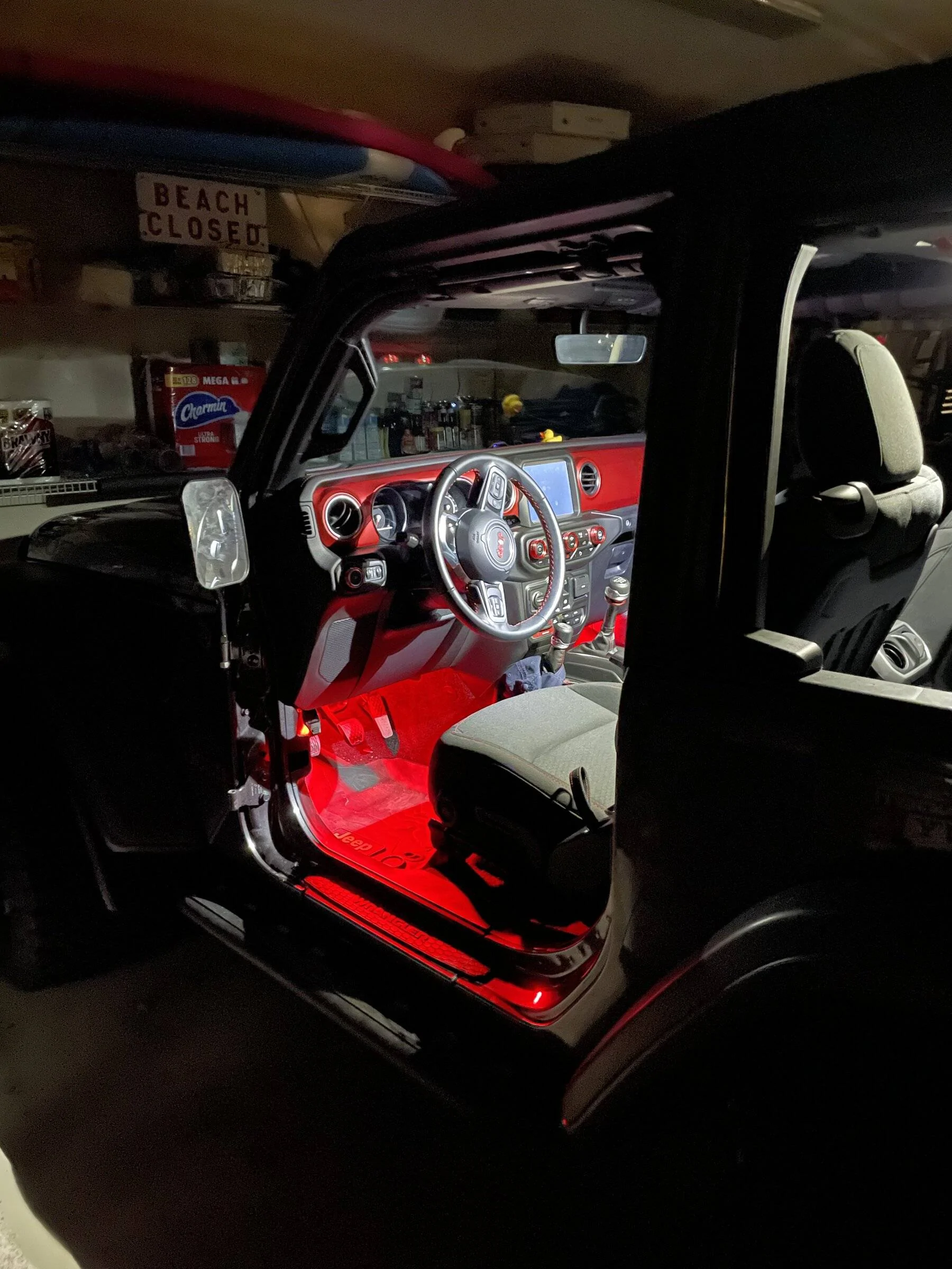

Thanks for posting this. I just did this mod myself. I used some red license plate led lights and those posi t taps. I mounted them under the dash and rear seats
I used these lights. Two sets, 8 total.
https://www.amazon.com/gp/product/B08R59W2H7/ref=ox_sc_act_title_1?smid=A15M0OICGLE6ZP&psc=1
I did two per side front and back. One light connected to the ambient light. One connected to the courtesy light. Looks freaking awesome! I will post pics soon.
