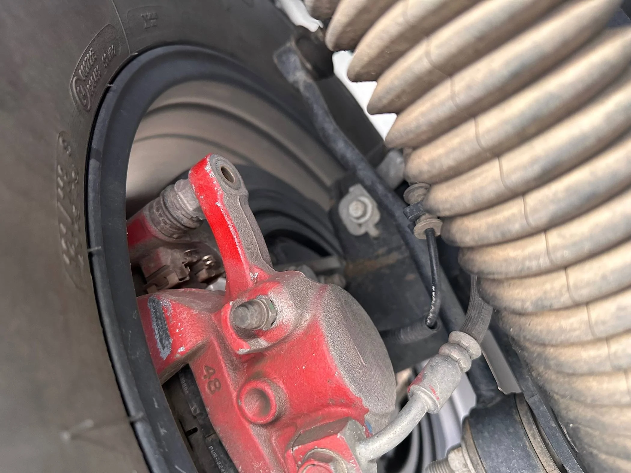

Hi all,
I’m not sure what part I need to order. Is it a caliper bracket bolt? Is it the caliper slide pin? It’s the top of the brake in the rear driver side.
Jeep Wrangler JL Am I missing a caliper bolt? IMG_1642

You're missing the Caliper Bolt, which should be PN: 6104258AA

I recently lost the caliper adapter bolt #1 on diagram. There is a TSB to replace them, come to find out
Should probably replace that.

One drop of red loctite solves this problem. I believe it was an issue up until 2020, then they supposedly resolved it.
