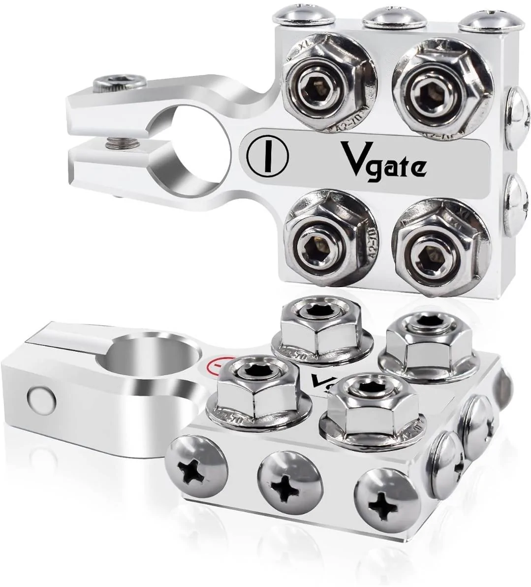

I am looking for the bus block???? and would buy the above mount too. I hate all the wires that I have running off the battery. I want something I can wire the winch to before the battery as well as a 30 amp like that runs to the back of the Jeep to connect to a DC to DC charger for my camper battery.

I know you've already made a purchase, but this item came to mind as a cost-effective reply to your inquiry.
Just a caution with an exposed bus bar, that entire portion is hot. If you've ever accidentally had a ratchet hit ground from positive on a you know why I'd warn against that. Think welder arc.

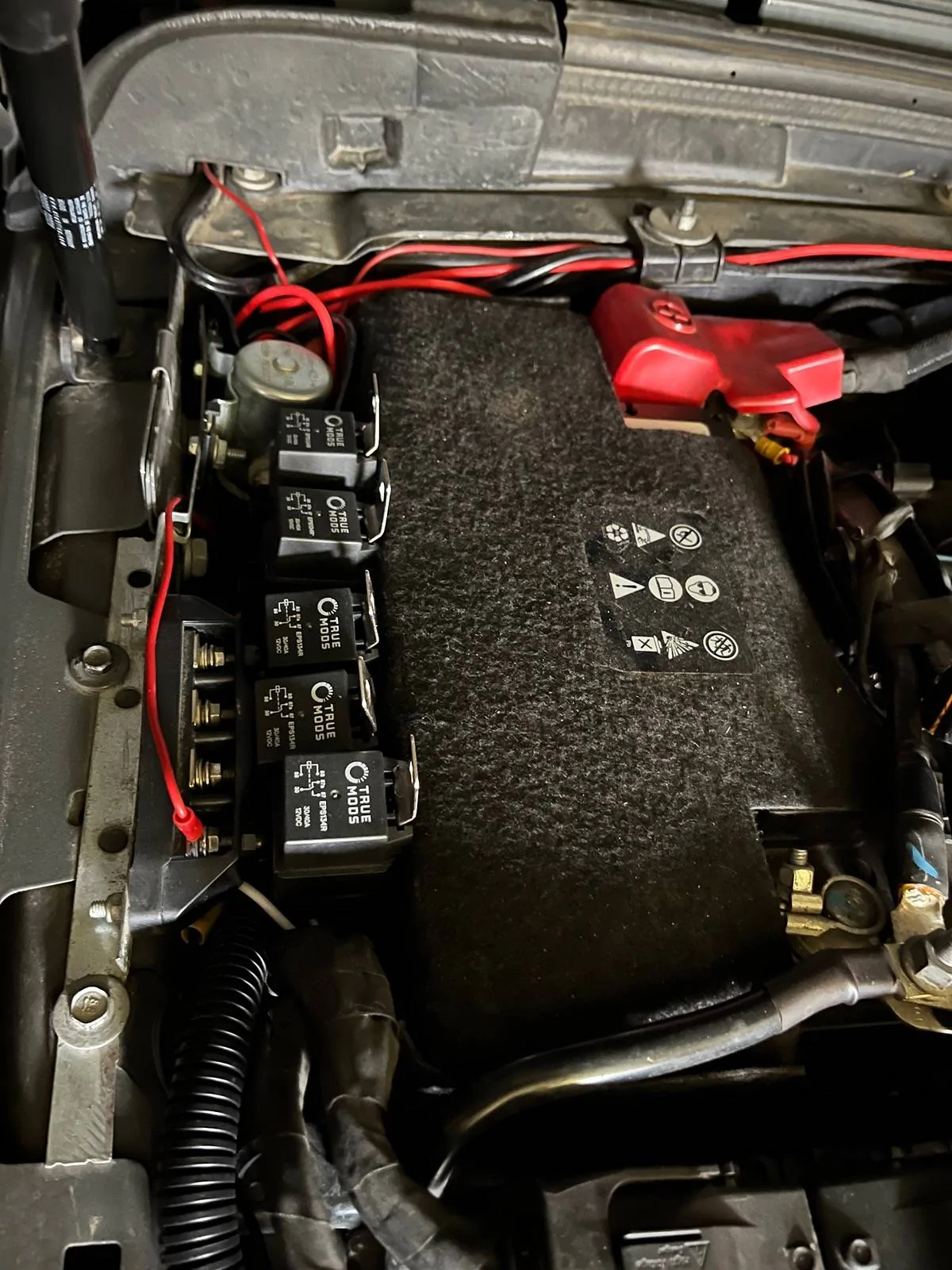

I’m doing my best to keep it clean.
I used a small bus bar from Amazon for each of my switches and then I just have my relays and solenoids coming off that bus bar on the other side
that way I don’t have to keep cutting my aux wires, smaller, and smaller each time I change something
