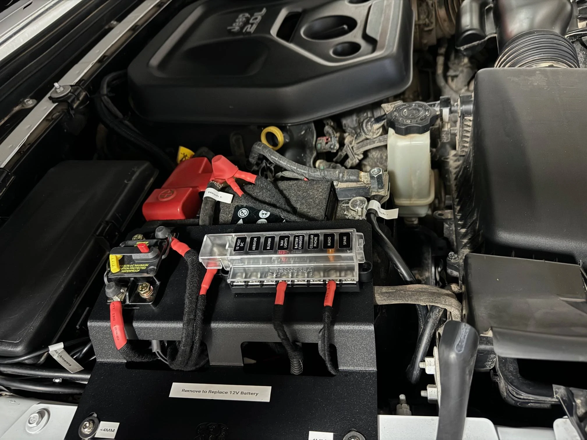

There are some terminal block options. For my fuse block/breaker, I use @813 Fabrication & Design 's mount.
https://www.813fabrication.com/product-page/underhood-electrical-accessory-plate

Oh, these look like what I’m looking for! Are fuse blocks pretty much bus bars with the added protection of fuses? Same function, correct?
GATORB8
May 30, 2021
8,831
11,726
CLT NC
21 JLURe, 06 LJ, 25 HDZR2
Yes. Basically a fuse block is a bus bar on one side. Each connection to the bus bar has a fuse location and a fuse protected terminal on the opposite side.
For the aux switches, you can use a "terminal block" which has two separate terminals for each circuit. A terminal block does not distribute the power between the circuits.
EDIT: Using a fuse block allows you to cut the fuses off each of your circuit runs (since they are fused at the block).
