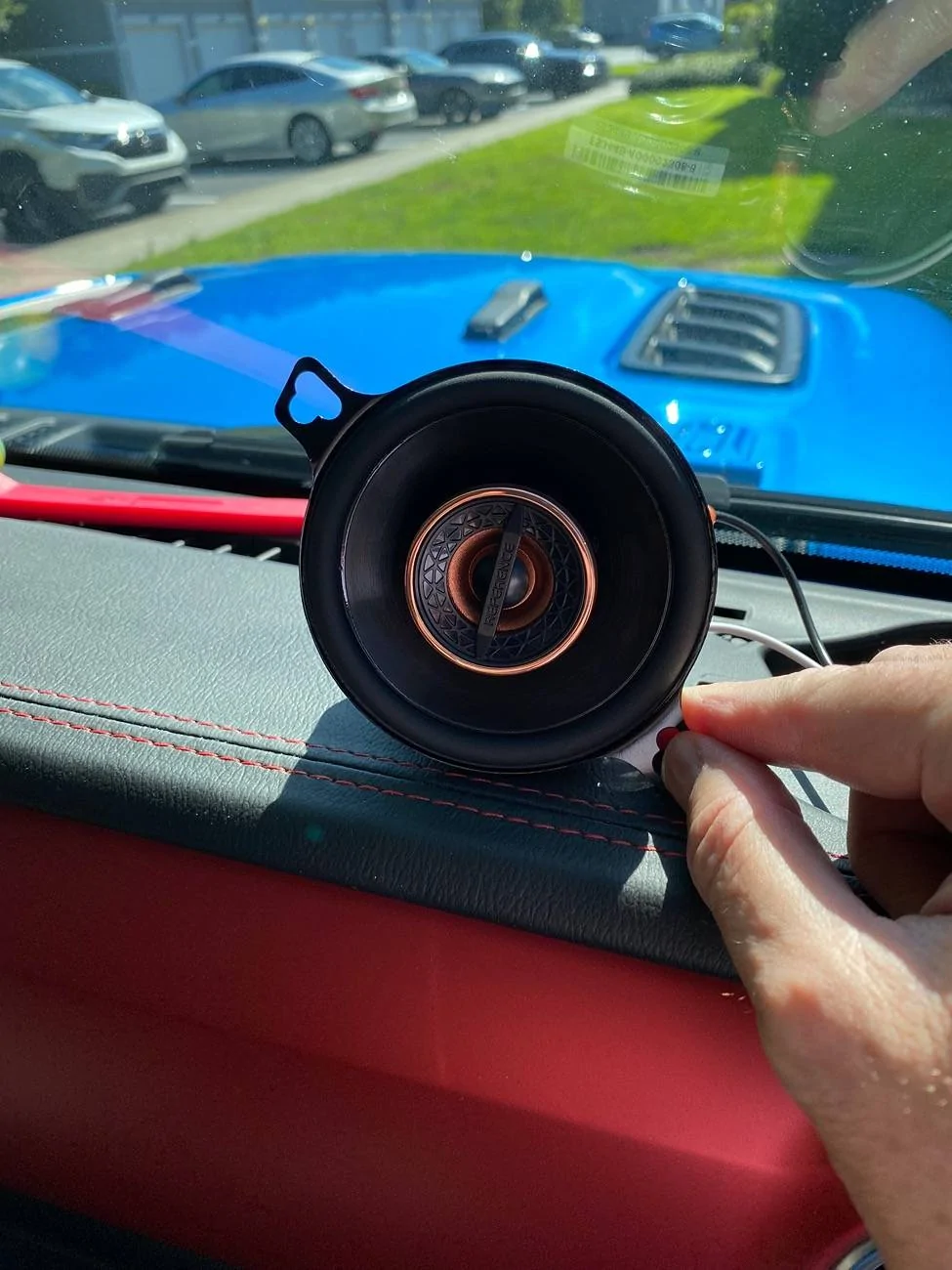

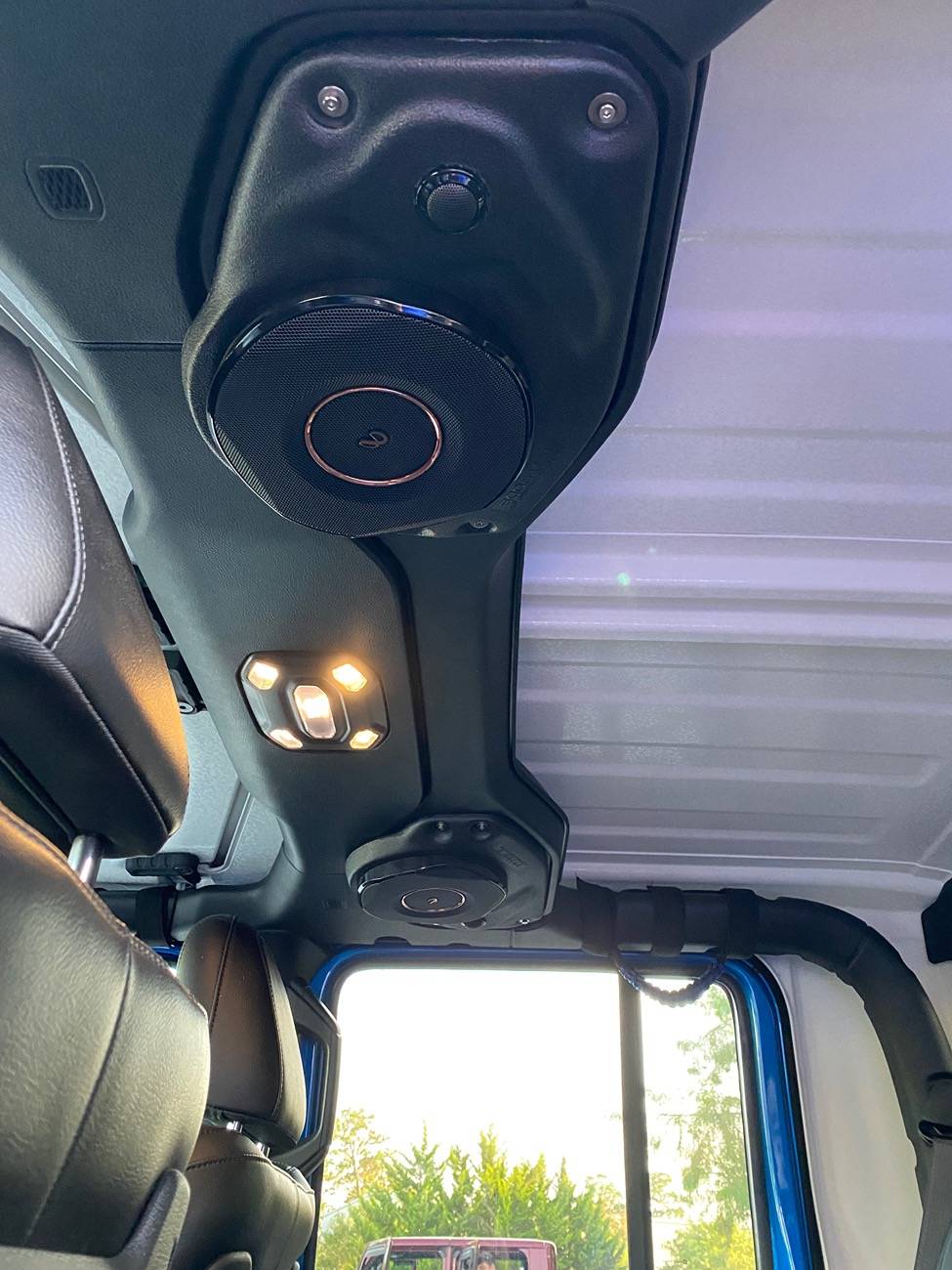

I swapped out the dash speakers with 3.5” Infinity reference. And the sound bar with 6.5” component Infinity reference. I used the JL/JT pods in the sound bar so I didn’t have to cut anything but the pods for the tweeters.
Was the sound improved ,? I’m looking for just little louder out if the rear but I don’t want to mess with changing the amp or just deleting it and adding a different sub
I did the exact same thing. I'll be upgrading the knee speakers with the Infinity coax speakers once I have a full day to take the dash apart. Sounds much better. Not so much volume but the sound quality and clarity is much better, especially with roof off or all the windows open.
Yes. It’s louder and the range and clarity have greatly improved. I installed the new speakers one side at a time so I could do a direct comparison with “upgraded” Alpine. The Alpine sounds like it’s coming through a tunnel compared to the Infinity. Plus you don’t have to use the crossovers from Infinity (included in the box) or add any amplifier. If the pods like I did you don’t have to cut anything either.
Which wire did you hook up to the 6.5, the one from the 4inch speaker? and the tweeter?
The 4” has a larger plug than the 3.5”. So the 6.5” replaces the 4”. And the tweeter replaces the 3.5”.

Thanks, I seen some where they only use the small plug
The Infinity components come with a cross-over. If you have the “upgraded “ Alpine system (bigger screen), the system already has cross-overs built in. So you don’t need to use the Infinity cross-overs. Just a simple plug and play.
