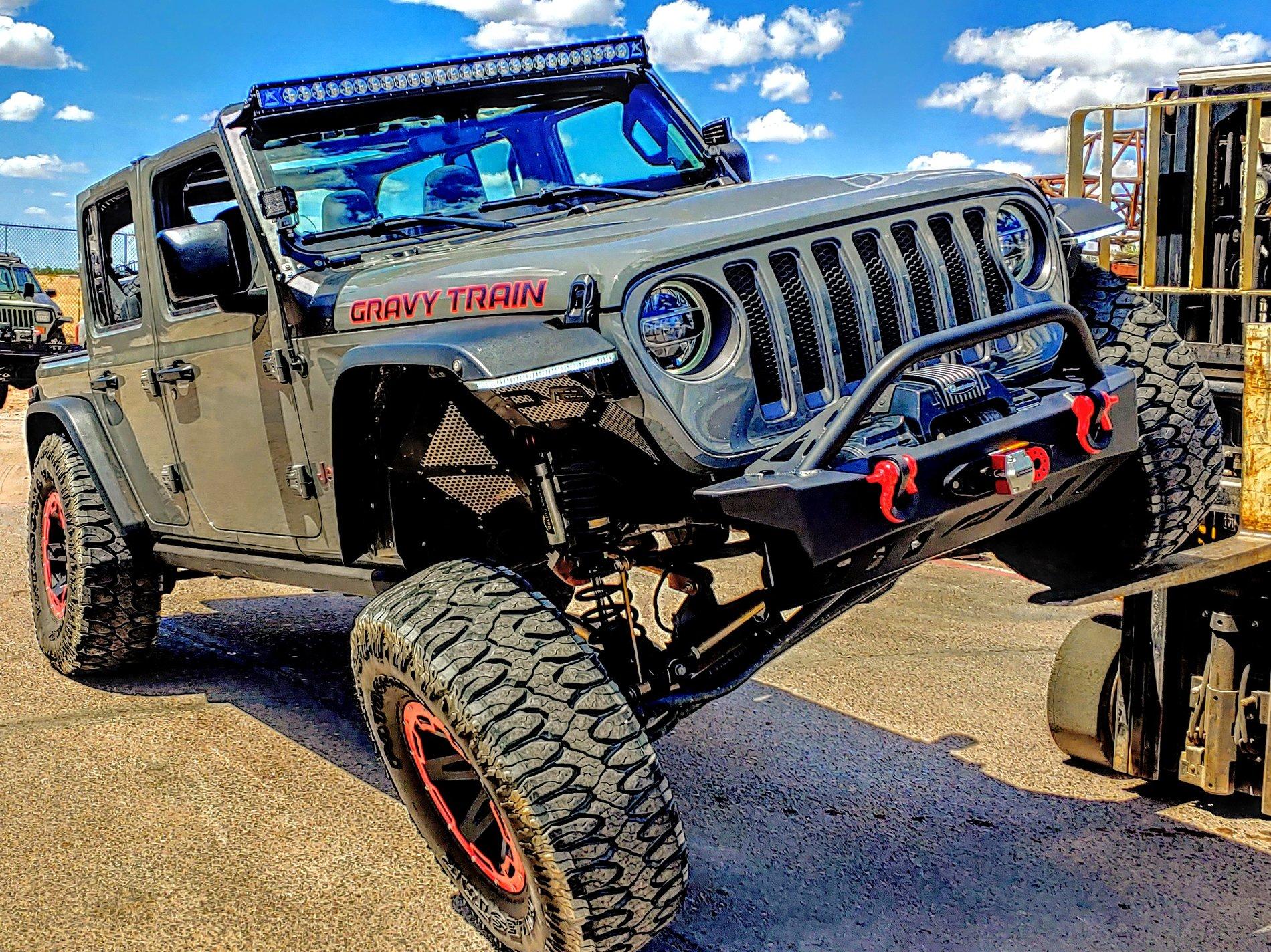

Mother's Day weekend and I'm wrenching in the garage. At least I was productive. Added a Road Armor light bar mount with a 50" Rigid Industries Radiance light bar. I also have two Rigid D2 cubes for the lower A pillar mount but will add them next weekend. Everything was wired to the factory Auxiliary Switches, simple as can be.

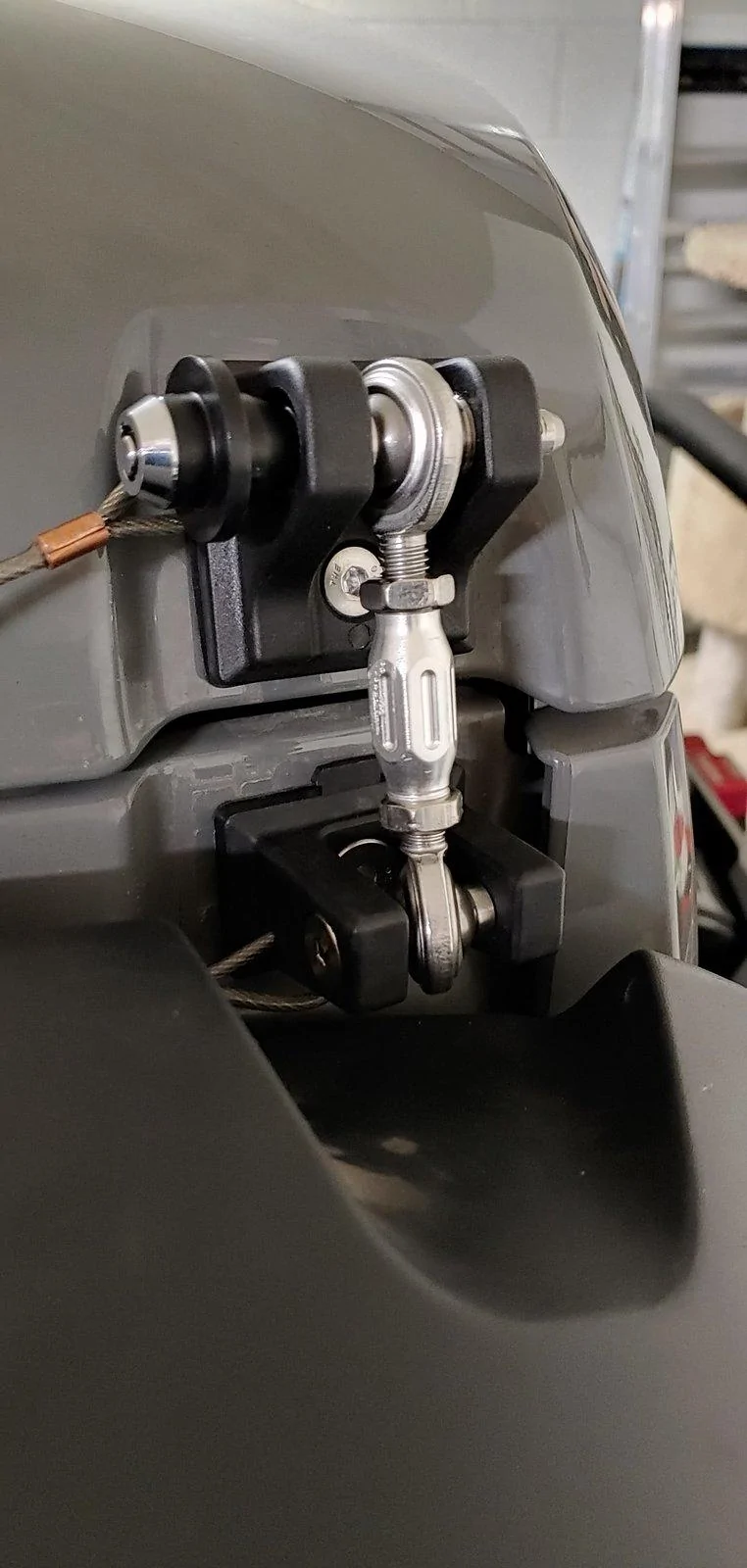

Also installed a Diabolical Slipstream for some topless security. This thing is a tank...well built and quite, thanks to the provided foam strips.

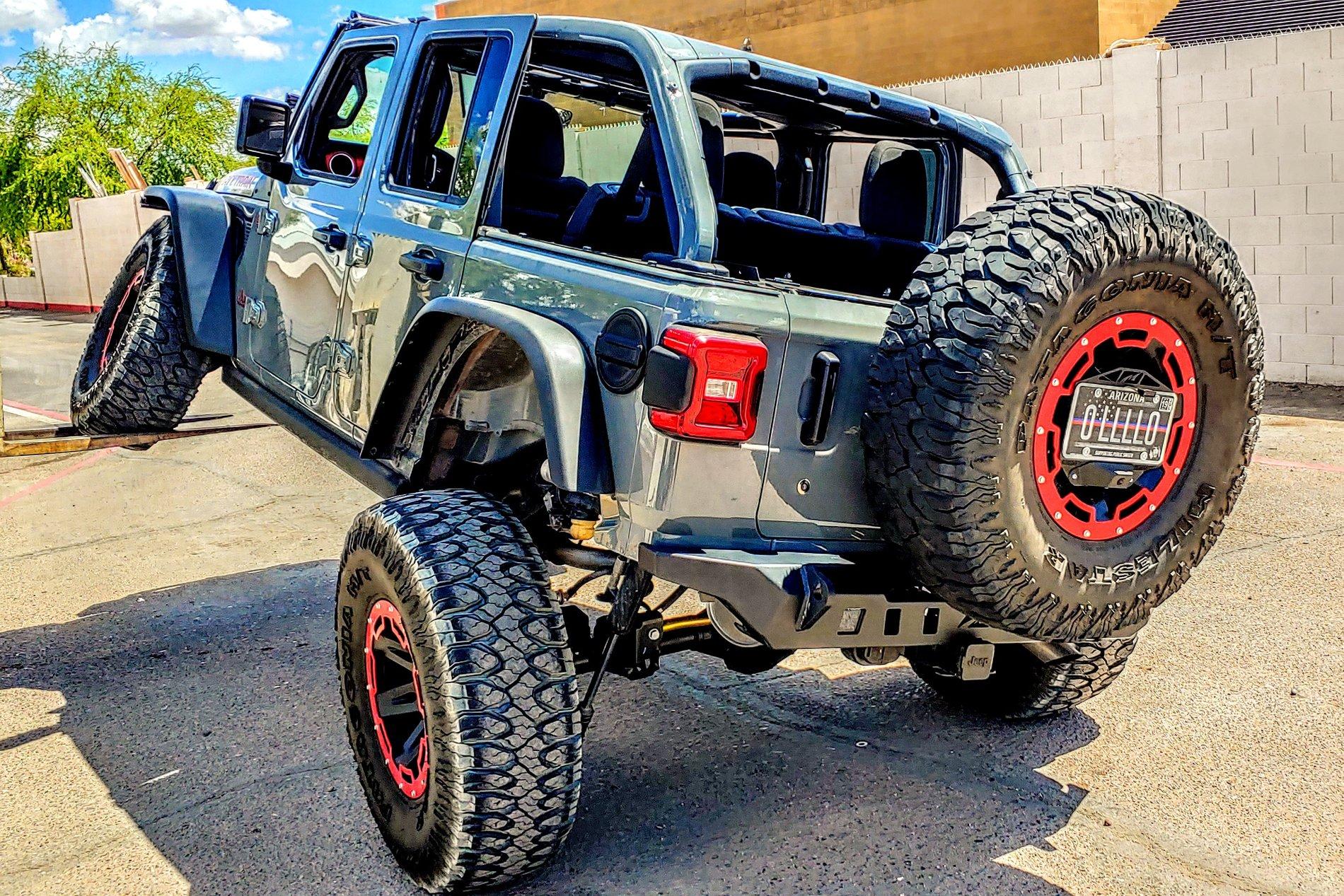

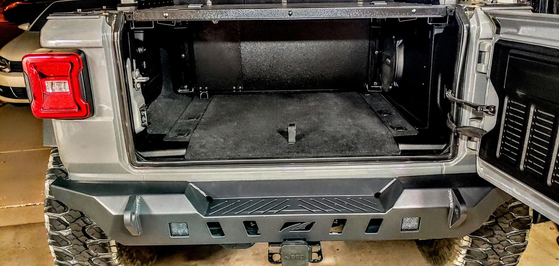

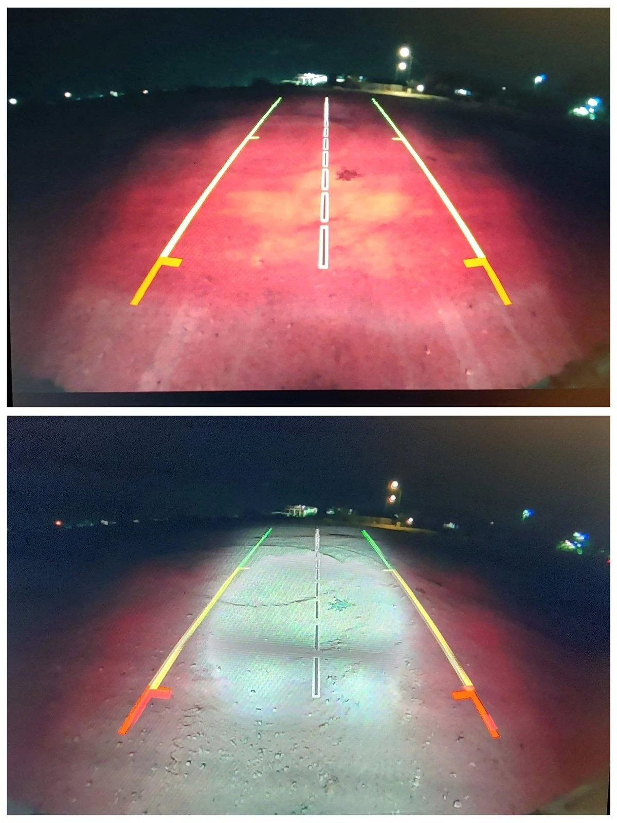

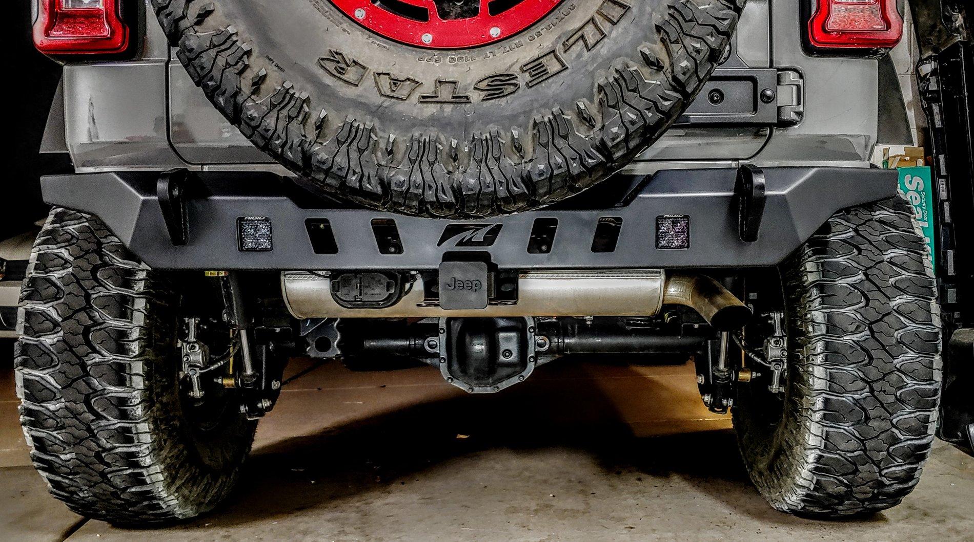

Motobilt Crusher rear bumper added with Rigid Industries Midnight Edition cubes. Perfect fit and the added rear light output is much needed, check out the rear camera shot with only reverse lights vs Rigid Industries Midnight Edition cubes. I love the smoked lens because they dont look out of place in the rear bumper.

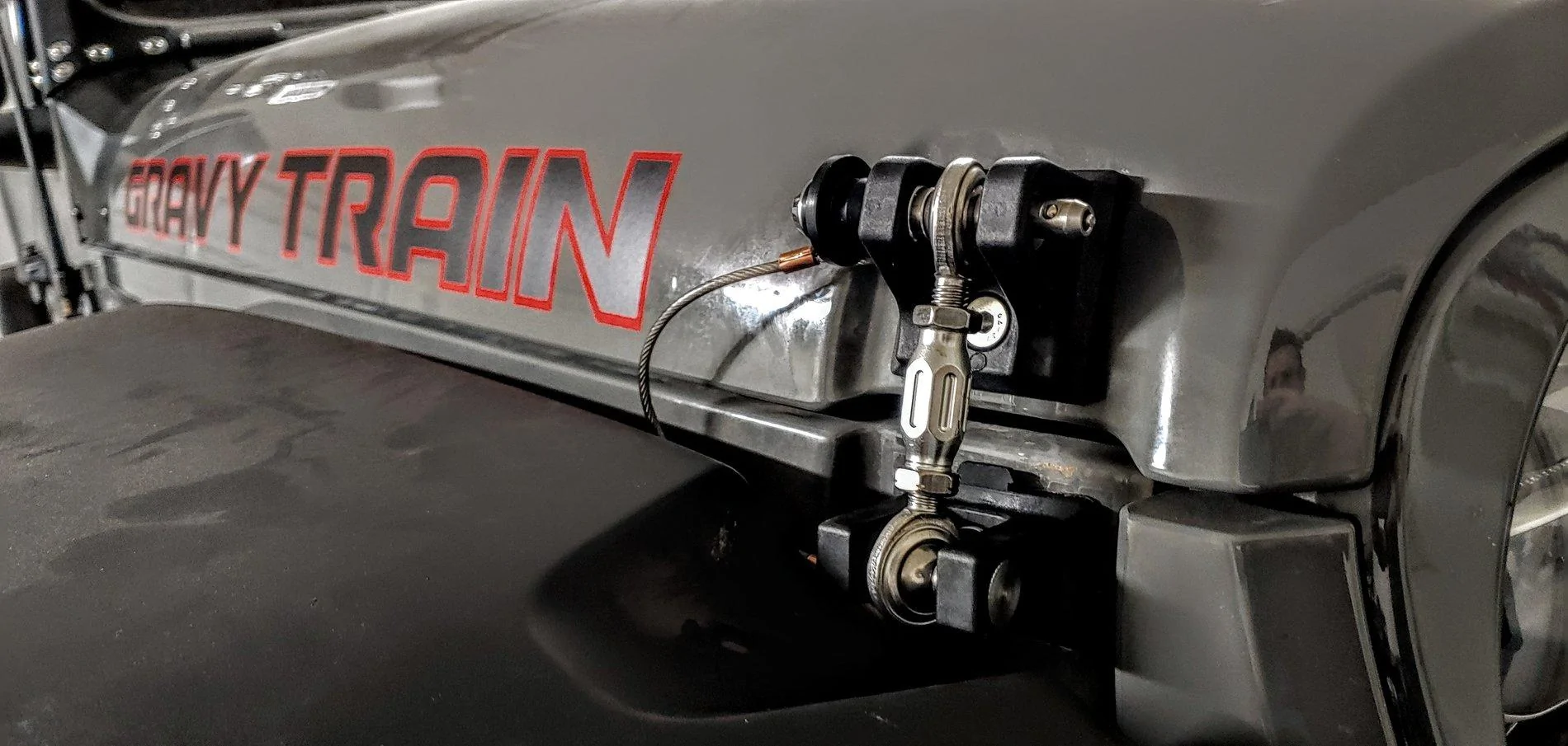

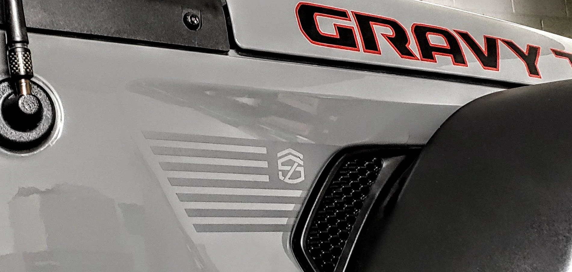

Added a vent decal to support my homie over at Seven Slot Battalion. Check them out.

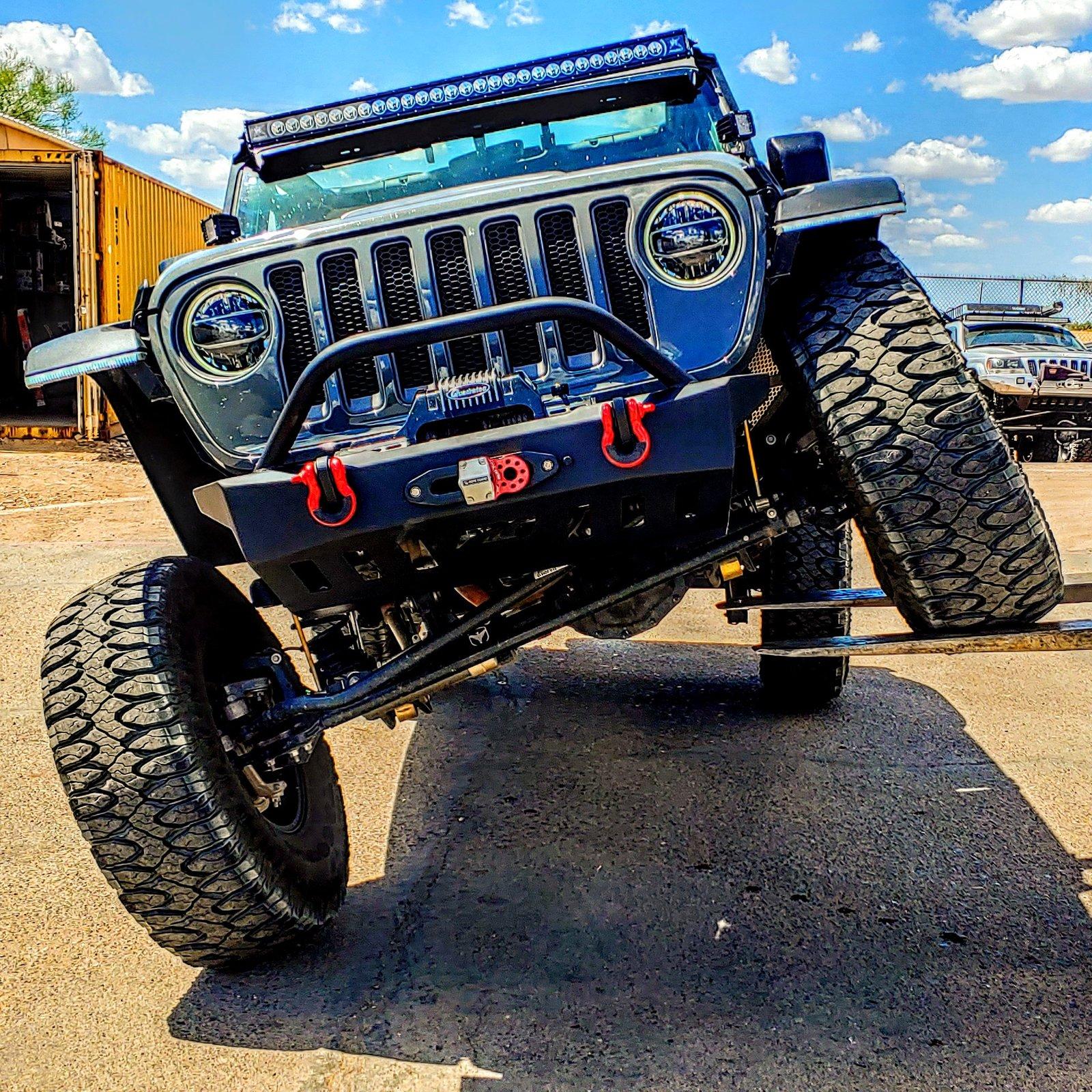

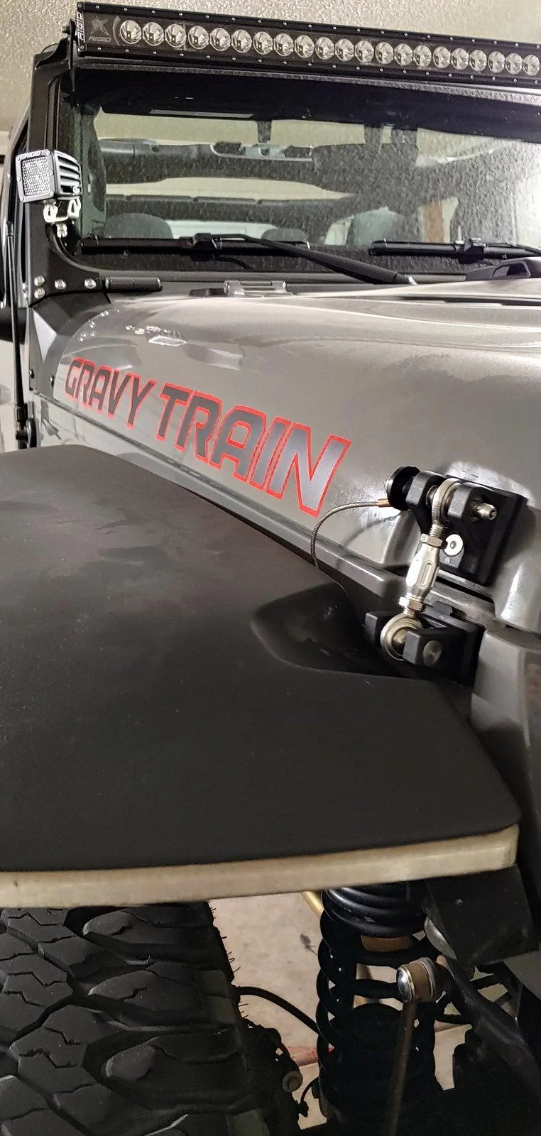

Also, removed one bump stop puck up front and stretched her out to check out for any contact issues. Only issue is minor contact from the pinch seam at the lower rear fenderwell on the tire. Some minor trimming will solve that. So, running 38s on a 3.5" lift, 3 bump stop pucks in the rear, 2 bump stop pucks in the front, minor trimming to the rear fenderwell, removed inner fender liners and doing a fender chop....good to go!
