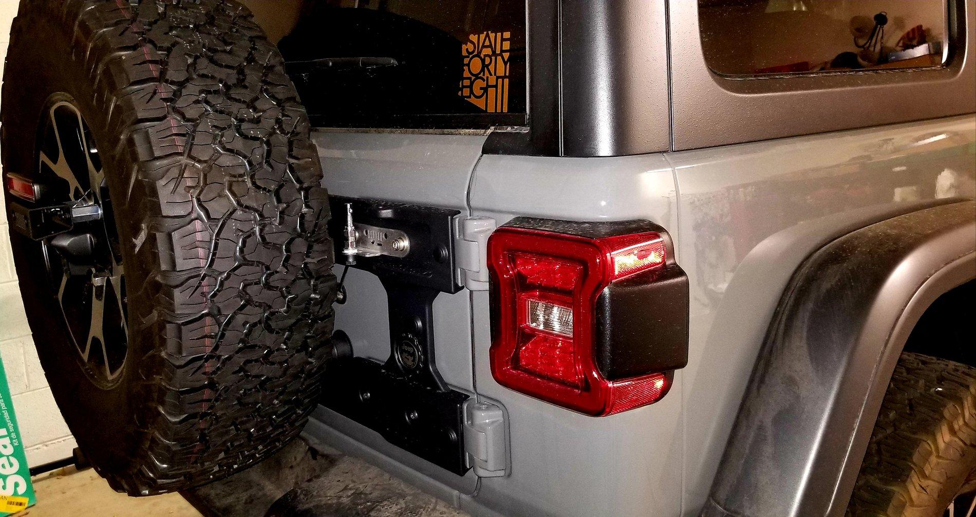

    I then added the Mopar oversized tire carrier for my spare tire and had my wheel protector rings powdercoated red.

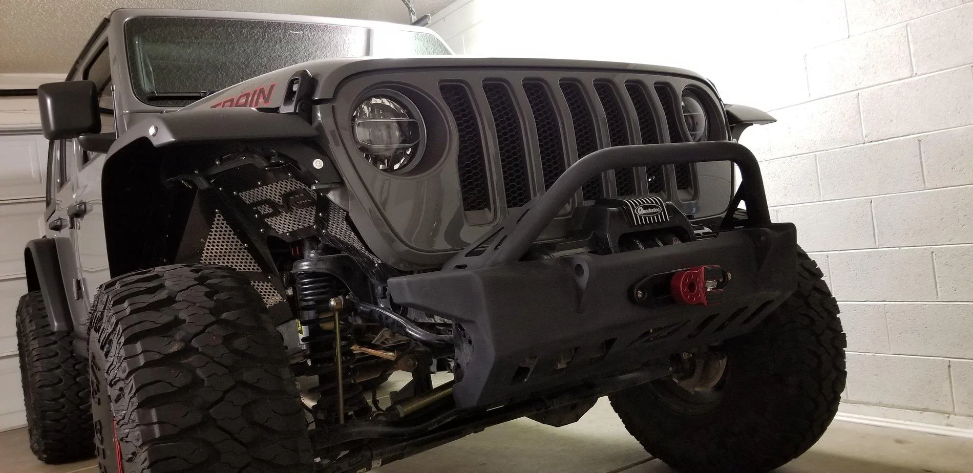

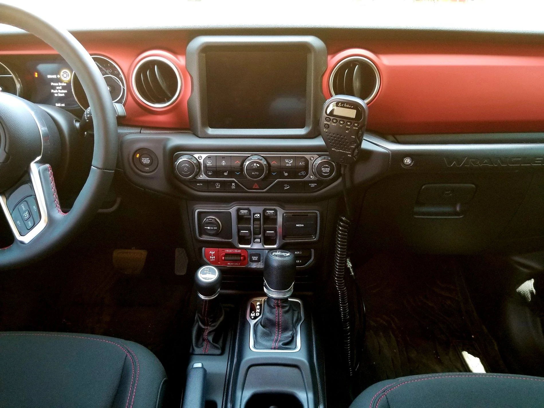

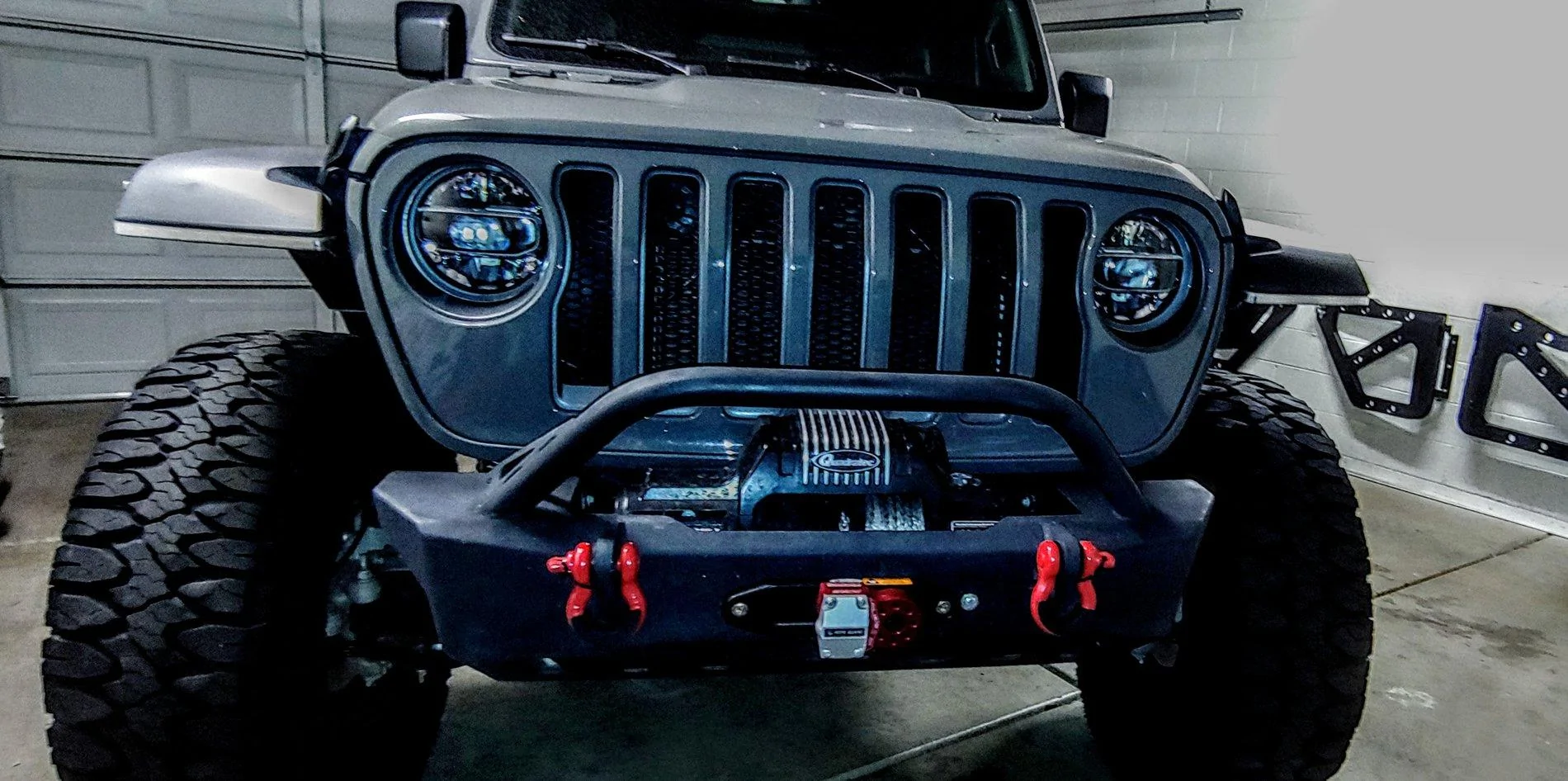

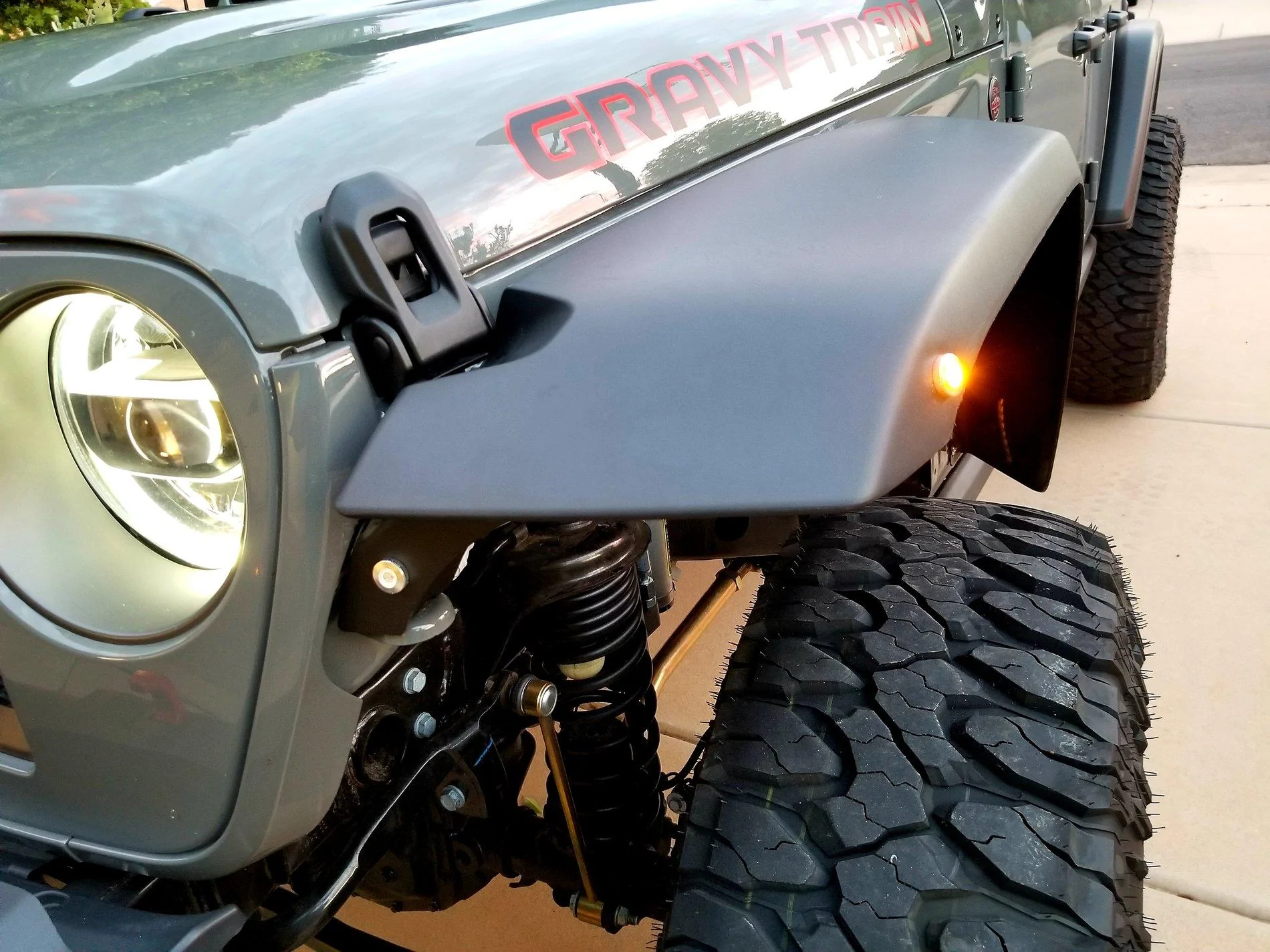

    Ok, so the biggest transformation has taken place with the last stage. Now to fix some of the issues that it has produced, an incorrect speedometer reading as well as slight contact from the 38" tires with the front bumper and front fenders during full flex.
    The speedometer correction was simple. I purchased a Tazer Lite that simply plugs in under your dash, and by using the arrow controls on the steering wheel and your dash as a monitor, you can cycle through the factory settings and change your current tire size, which in turn, calibrates the speedometer.

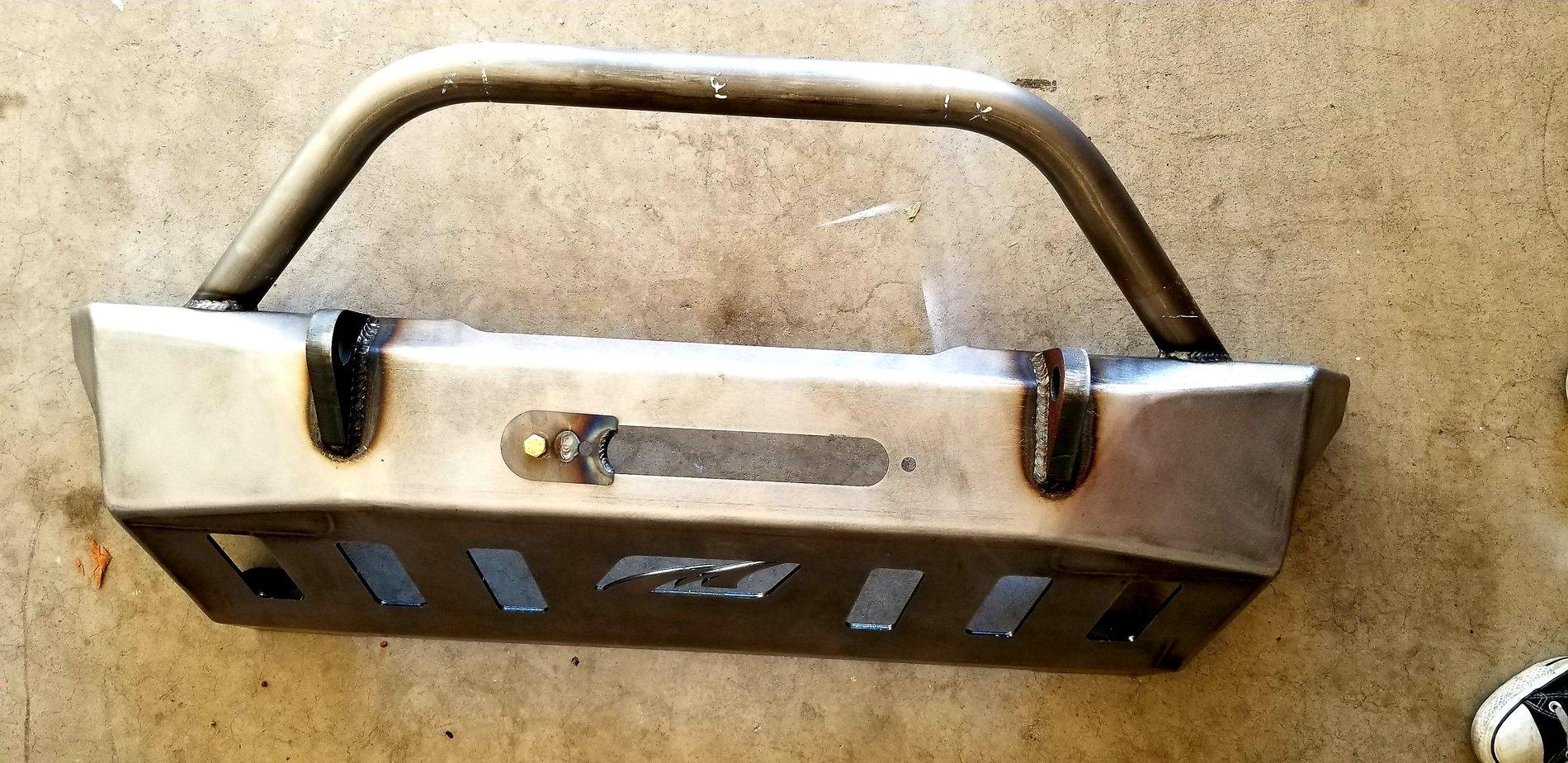

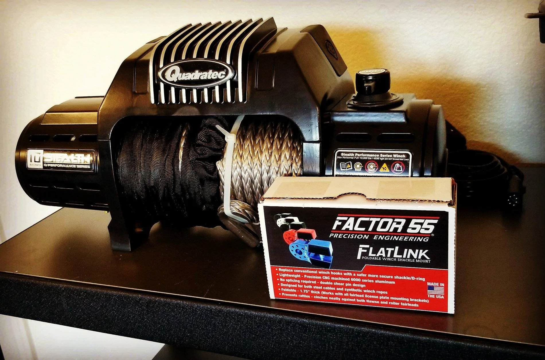

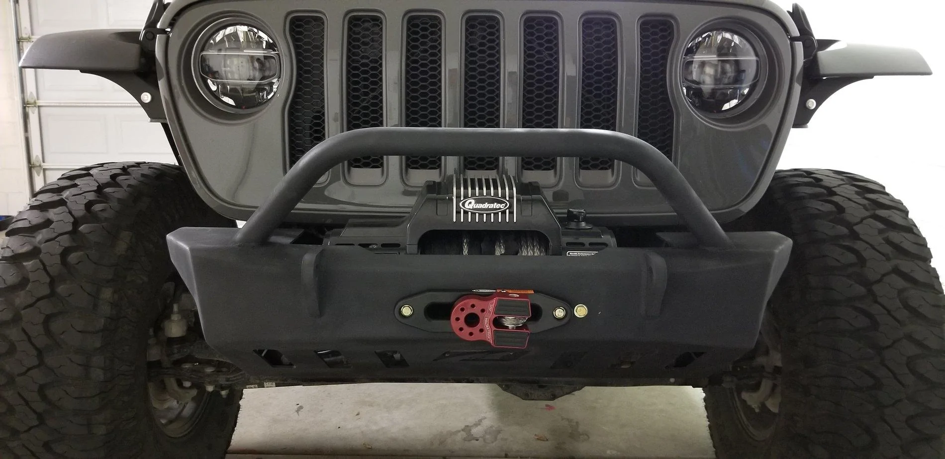

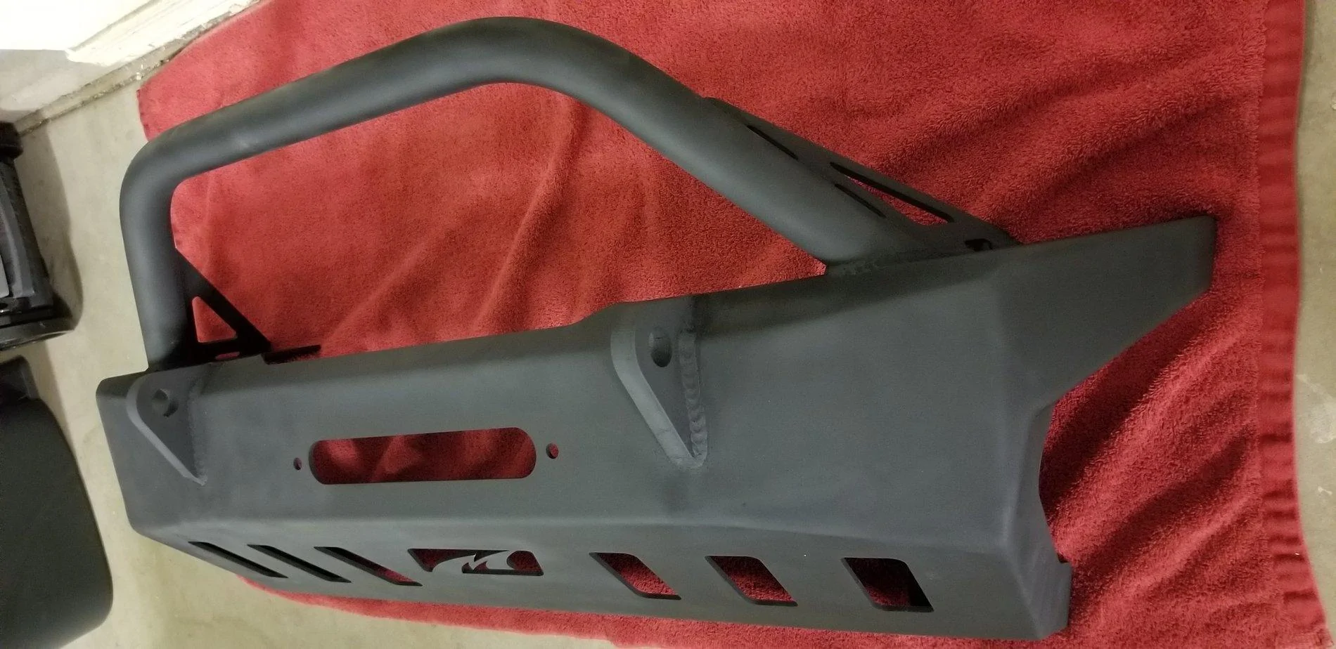

    I knew I was going to eventually get aftermarket bumpers, so when I ordered Gravy Train, I went with the most basic bumper package available. I searched and searched and searched for a front bumper that included all my must-haves......stubby design, recessed winch mount, specifically made for the JL and not modified from a JK design, fog light openings, lower skid plate and bull bar. Well, 5 out of 6 ain't bad. The Motobilt Crusher front bumper had everything but fog light openings. I live in Arizona. What the hell would I do with fog lights?!?!? The bumper was sent off for coating. I used Cerakote instead of powdercoat or paint due to it's durability and thin smooth finish. Once installed, I added the Quadratec Stealth Q series 10K pound winch with synthetic line, 3/4" red D rings and a Factor 55 FlatLink.

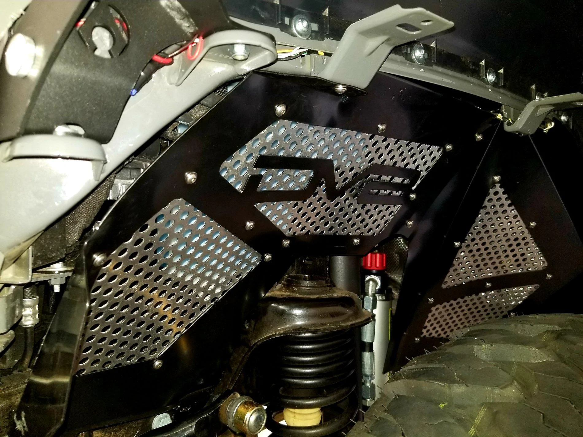

    Now to address the rubbing on the front fenders. Looking at all the aftermarket options, I could honestly say that I wasnt much of a fan with any of them. It was either the design, the price, the material or even the availability that turned me away. So I opted for the most cost effective route which also gains the most clearance, other than totally removing the fenders. Rubicon fenders are plastic, two piece units and can be separated from each other with a small amount of labor. However, you will lose your blinker assembly/daytime running lights by doing this because they are attached to the lower portion of the fender that is being removed. At the time, I had used a kit made by Artec Industries that would secure the top fender portion as well as included a LED bolt light to act as the turn signals. Soon after that, a new LED light kit was produced by American Adventure Lab. It was a LED strip that ran the entire length of the lower front fenders and would not only act as blinkers, but also returned the ability of your daytime running lights. I was sold! This kit is amazing and couldn't be any more simpler to install. Completing the front wheel well area was the addition of DV-8 inner fender well liners. Some pics below will show the before/after pics when removing the lower half of the factory fenders.

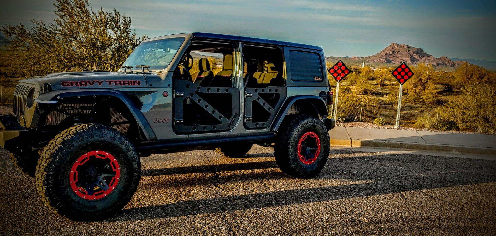

    So after 6 months of ownership, Gravy Train has made a lot of progress. Still plenty more plans in the near future.....armor, axles, gears, onboard air, and on and on and on. Just Empty Every Pocket.

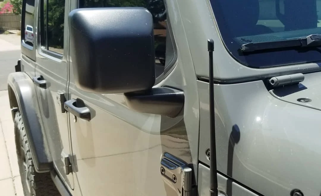

    The weather in AZ has warmed up a bit so modified up to the Ace trail doors to take in the fresh air.

    Nice build! How’s that ADS/Metalcloak ride on the road? Already know those ADS are badass off-road! Can you post more pics of the front fender drive lights while powered off. I am interested in maybe doing the same. With the inner fenders removed are you able to run 2” bumps or probably still 3”?

    Thanks!!! The Metalcloak/ADS combo was a winner with me. Very smooth on road manners. I still run 3" of bump stop but I really think I could get away with 2".
    Here are a few extra pics of the American Adventure Lab light kit without any power. You will also notice a LED light bolt in the side of the fender. Currently there isnt any power running to it, it's just left over from when I switched out my Artec Industries kit for this current kit.

    Great lookin build! Waiting for my wheels to finally come in so I can put the lift on, and our Sting Gray JLUR's will be pretty similar. Are the AAL lights a plug and play, and do they throw a code? I've been back and forth on these and the Road Armor fenders, and the AAL is winning out.
