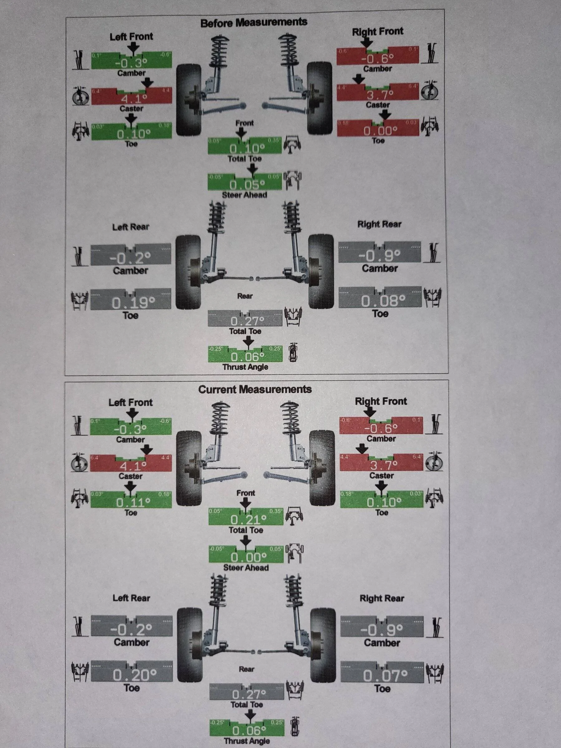

Just got an alignment done. Are these current mesurements OK?. or do I need to look at some other factors
37' tires
2.5 lift

The only thing changed was the toe on the rt front tire? Do you have adjustable control arms?

Ideal caster with 2.5” lift should be 5.5-6° IIRC. Need to adjust control arms to correct (assuming you added adjustable arms). Camber is non-adjustable, so my guess is that ball joints are starting to show signs of wear.
Correct, the rite toe changed, non adjustable control arms, think they are still stock

Everything looks ok except caster. Get some adjustable front lower control arms and get caster close to 6. It will drive a lot better.
