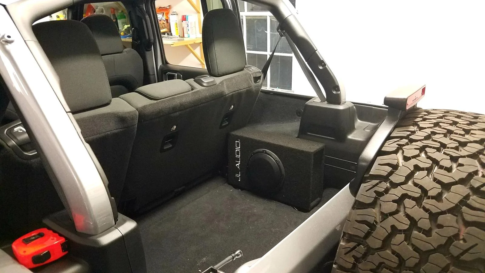

I have 3 kids and just wrestled with the same thoughts mounting a 8" jl audio self powered sub($400 new) and I ended up making a mounting board using a 2x6 and side mounting by the rear tire well this weekend instead of opting for the installer doing a custom tailgate mount. It was $250 for sub + bass knob hookup with 8 gauge wire kit. If I would've opted for the tailgate mount, the installer was going to charge an additional $250 for soldering extra wire needed to reach the tailgate + custom mounting work. They didnt like having the wiring in a door hinge area frequently bending every time the tailgate moved. They also didnt recommend a 20+ lb sub box with 1/2" MDF board hanging on a door that could be slammed shut.
By the way, I drove a Alpine upgraded JL for 2 days and my current system(8" jl audio powered sub + replaced the (4) 2.5" teeeters with 3.5" plug and play Kickers with dynamat added up front) sounds just as good if you're playing high quality music. The jl audio sub sounds better than the factory alpine sub IMHO...it's awesome. Here's the mounted sub:
