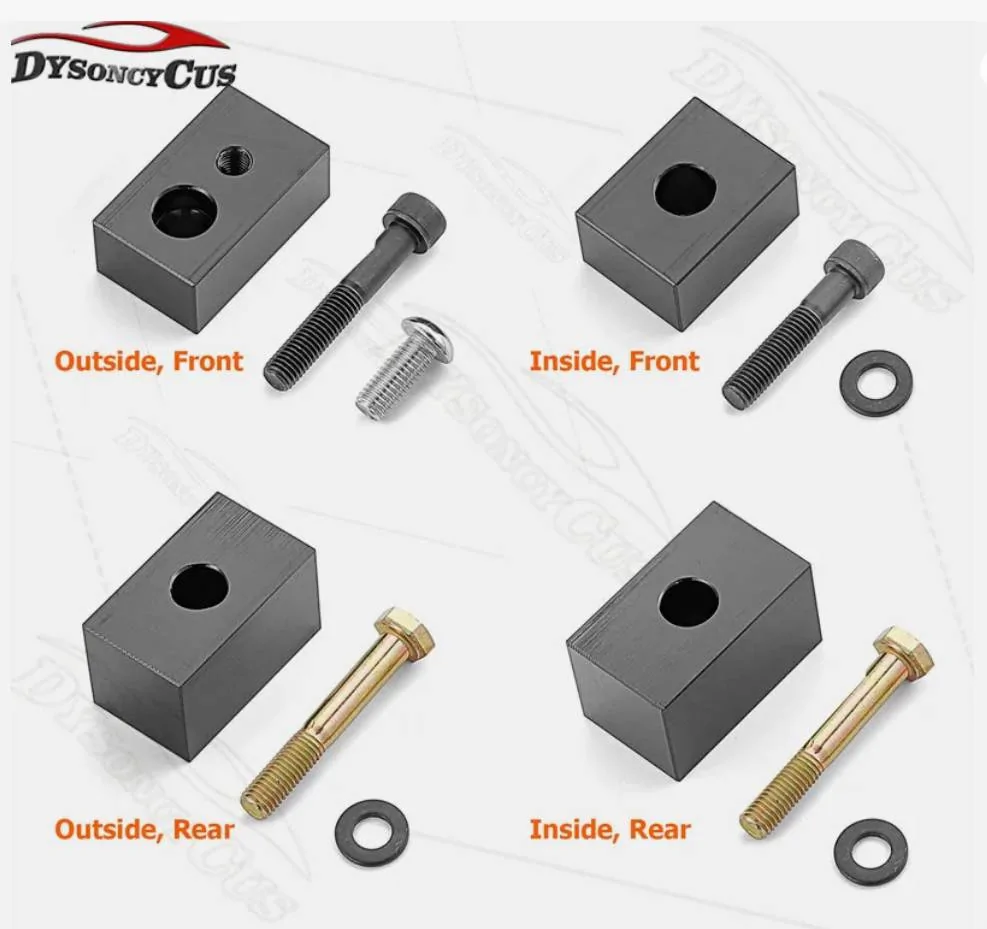

measure at the 10” height mark if you have 3” from that mark to the back of the seat then you’re good for either the Kicker HS10 or 8. Another option would be raise both seats and IMHO I would move the ARB to under the driver’s seat and put the amp & sub under the passenger seat. You can buy a lift kit for each seat for under $70 total. It took me about 30-60 minutes to install.
