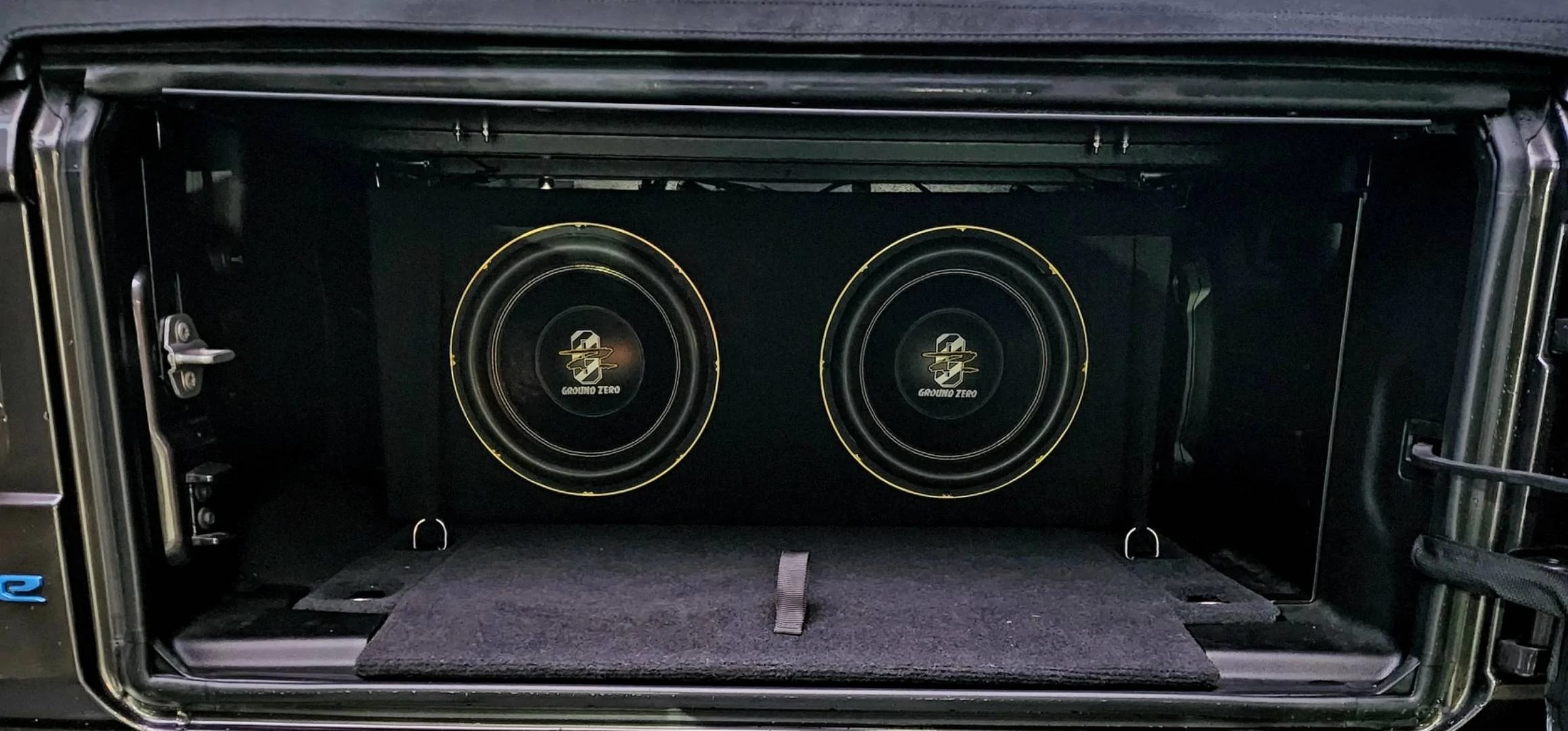

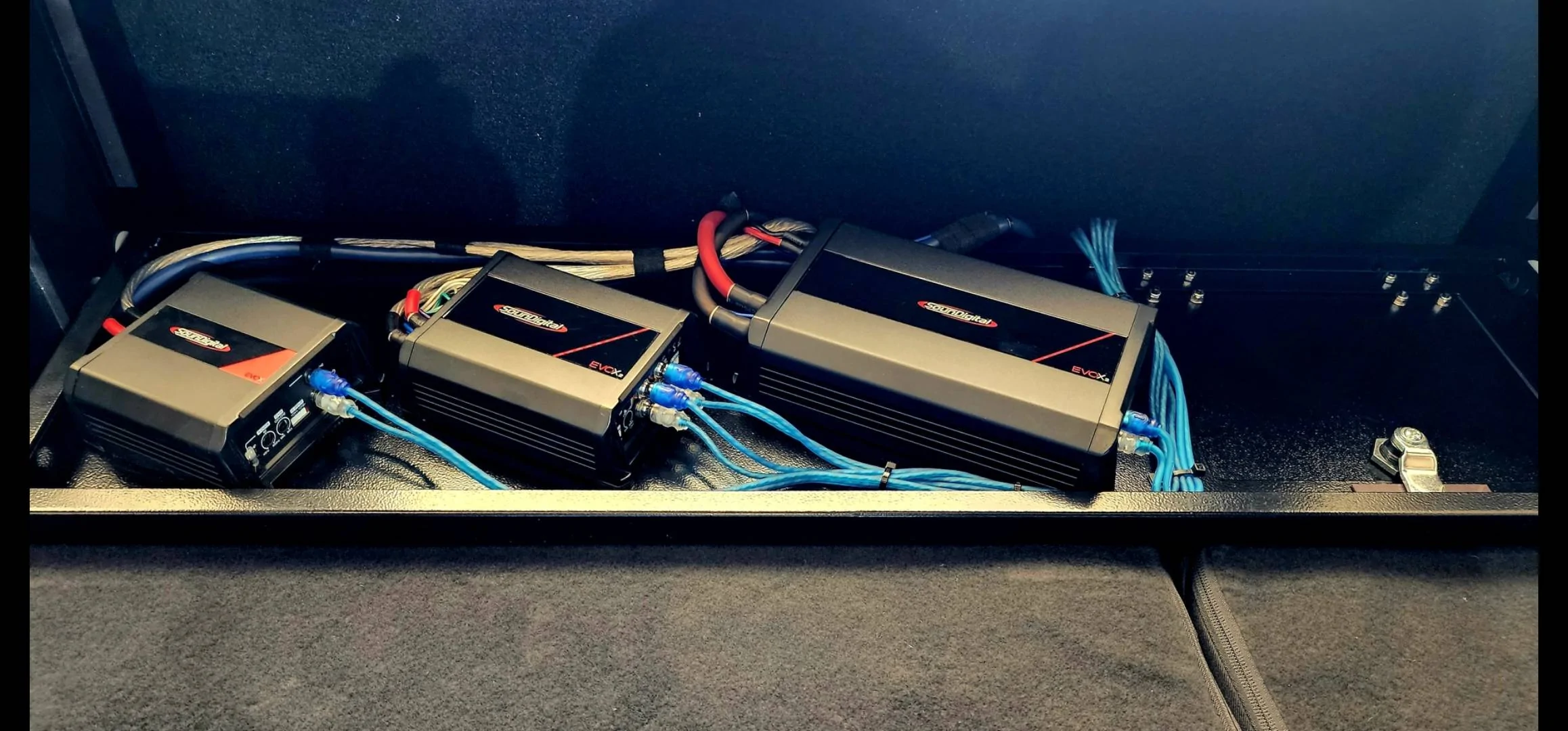

I have the Slipstream as well - l replaced all speakers and retained the factory head unit to keep a factory look. Maybe this will help you with ideas.
I mounted all of the amps, DSP and wiring on the inside of the Slipstream to keep them locked up when the top is off. You can flip down the access panel from the inside for amp access. The 12" subs are in a sealed box and sized to fit inside the Slipstream - can still open the floor storage door.
Love what you did here but I have the slide bottom with my Slipstream. I don't want to lose my storage area back there as we usually have a cooler on the slide out bottom. How did you get the equipment mounted to the front of Slipstream? I assume you didn't bolt it through.
