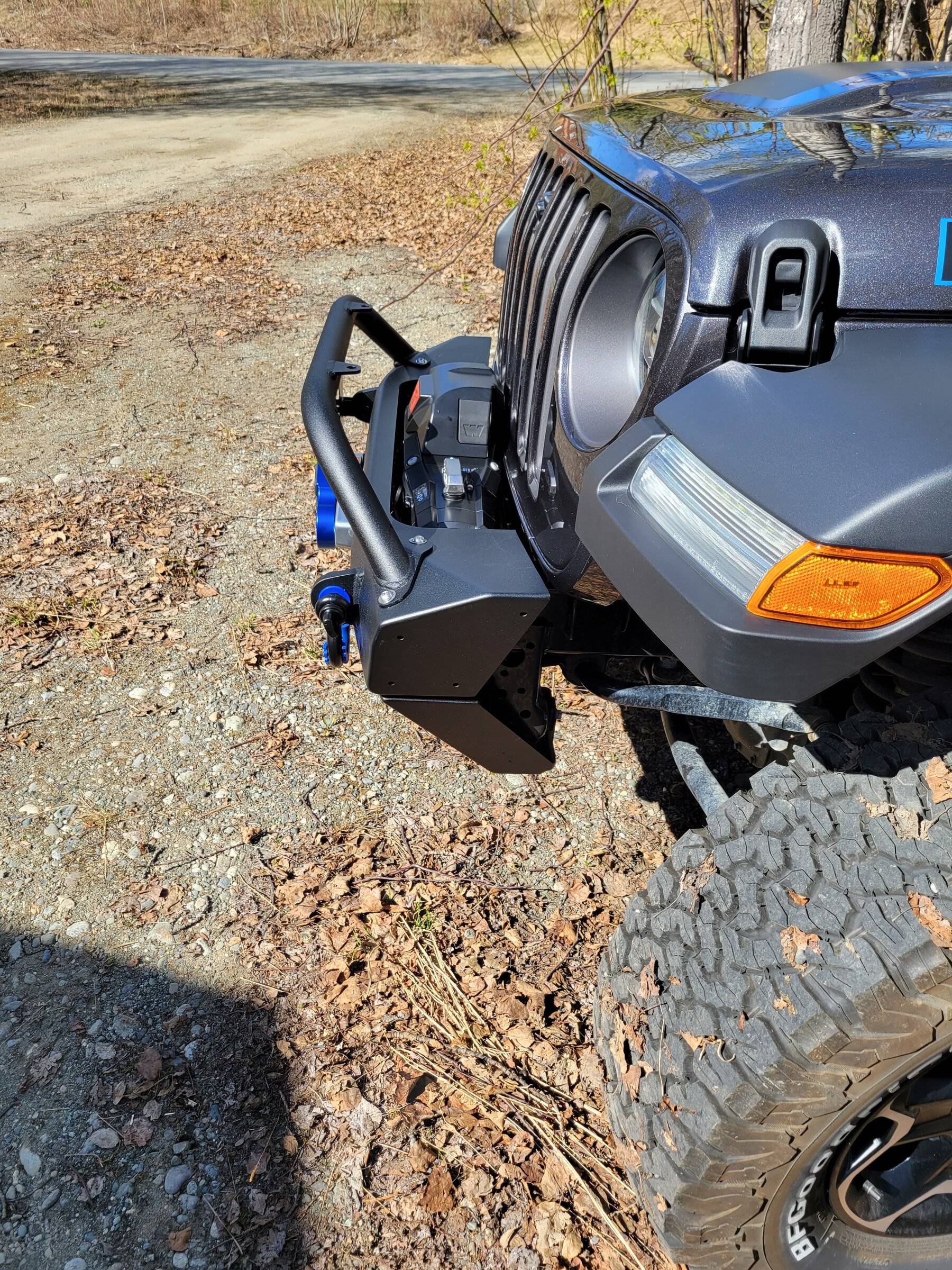

Carhauler
I removed my grill to install my winch in a recessed mount bumper. It definitely interferes, but the grill is also surprisingly flexible plastic. Put tape or a cardboard spacer in there if you want. After removing the push pins in the top, the bottom clips do need to come forward. Grab the bottom corners and give a pull and it'll pop right off.
Jeep Wrangler JL Aftermarket Bumper Interference with Grill Removal 20220507_154842
