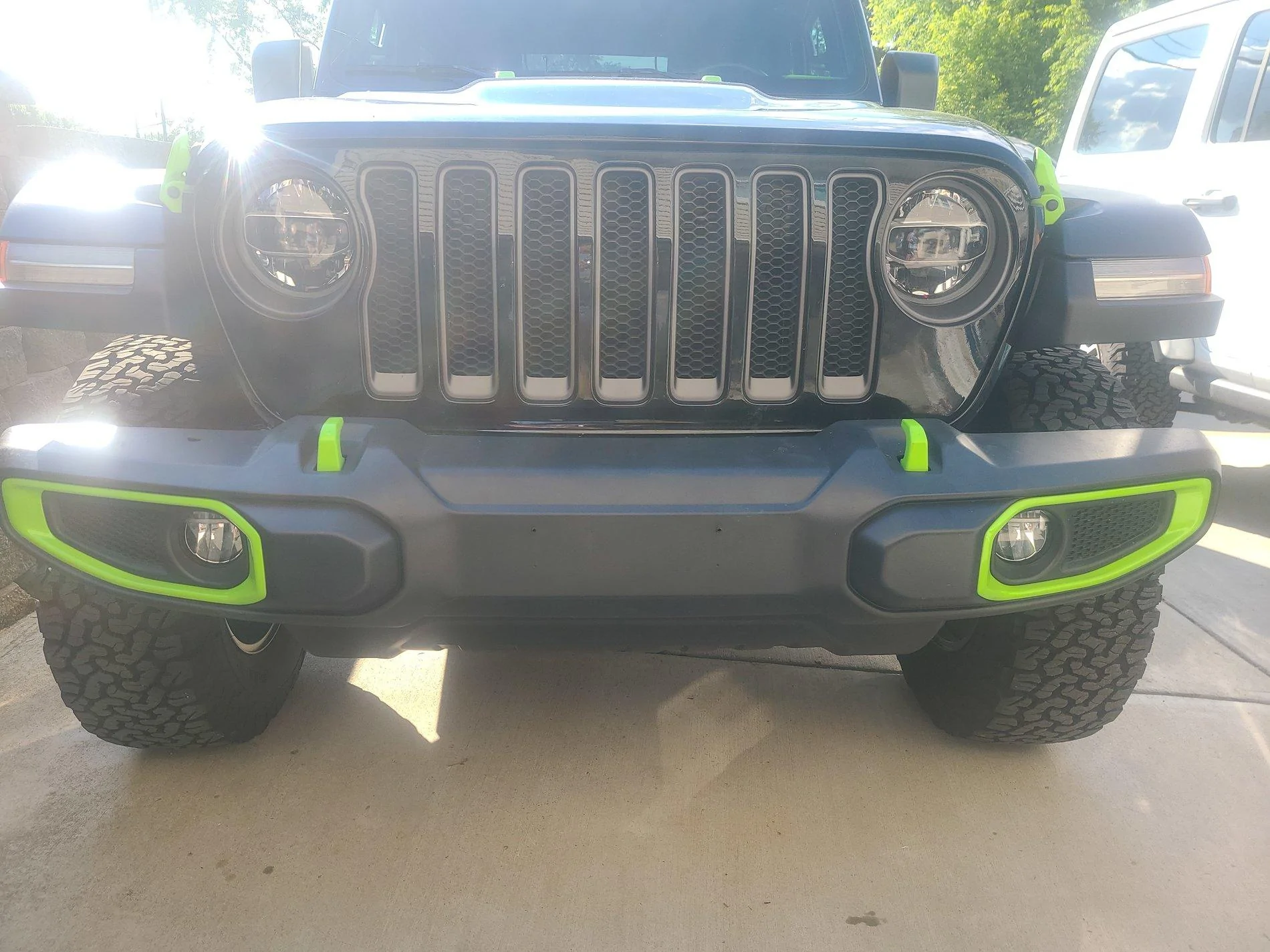

I bought the grill insert and the bezels. Swapped out the grill inserts pretty easily. Is there any way to swap out the bezels without taking the entire bumper off?
Yeah, it's actually really simple... you only need to take off a few of the fasteners holding the back of the splash guard, bend back, use a socket to get one bolt out, the rest prys out pretty easily. I did both of mine in less than a half hour.

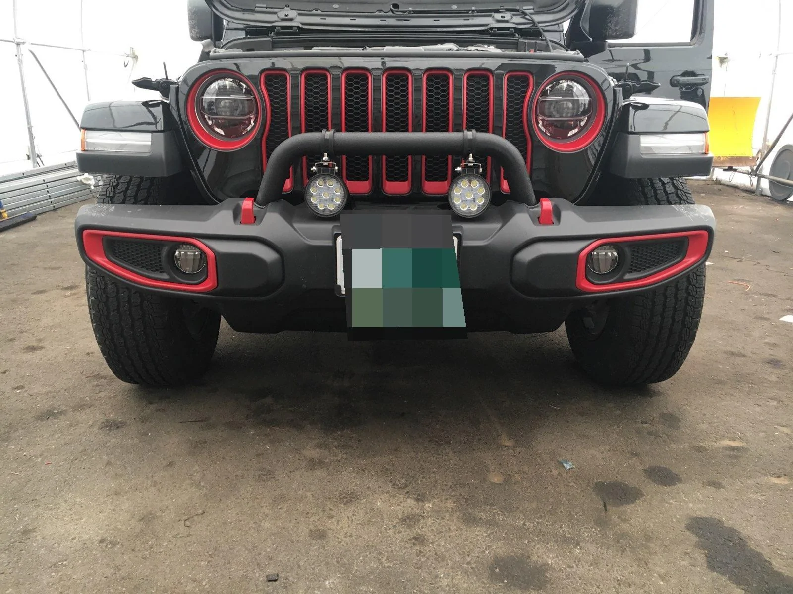

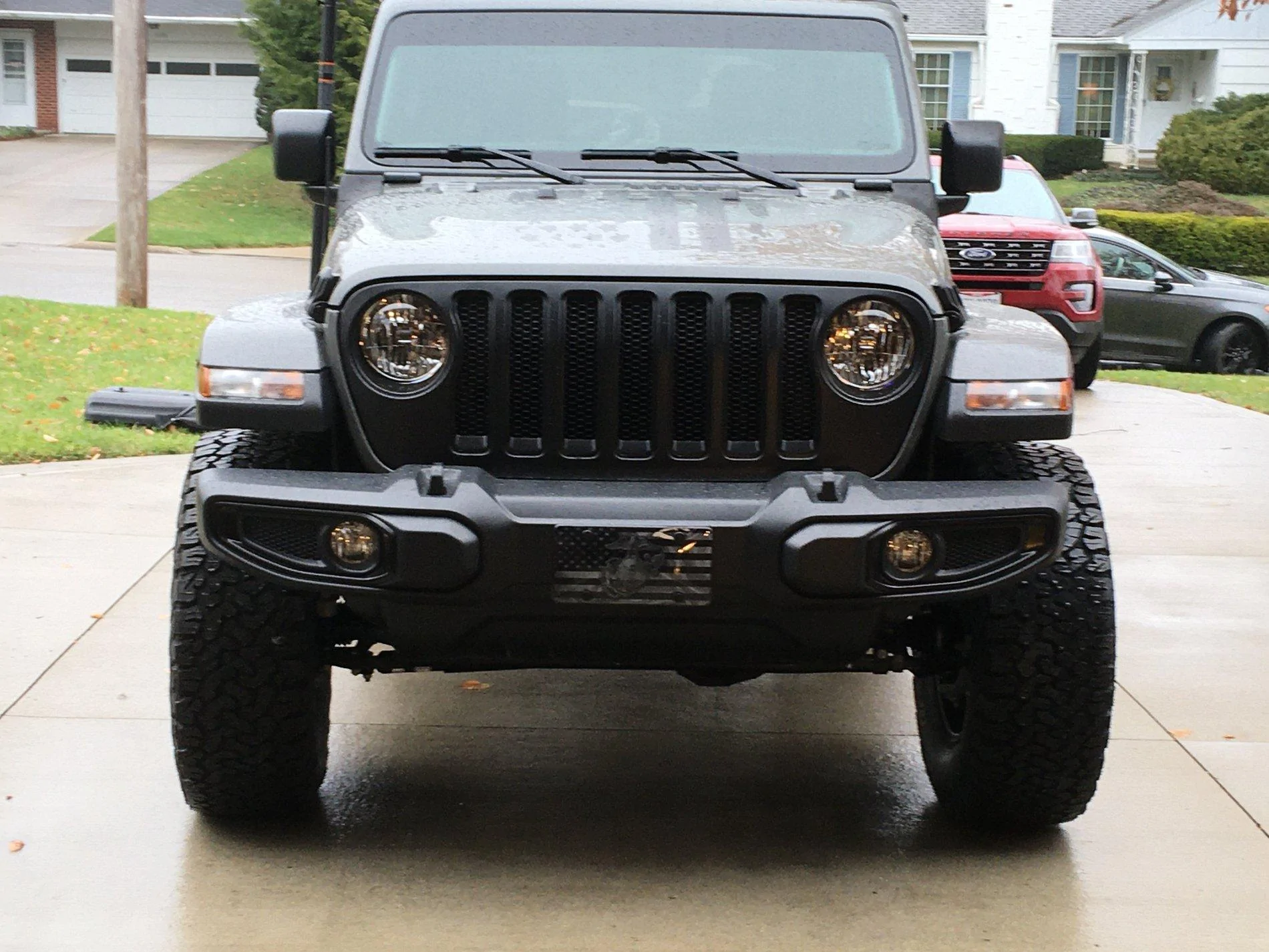

That looks dynamite! I really contemplated the MOPAR satin grill. I think it looks awesome on your Sting Gray. Mine is Granite, and I was worried it wouldn't have the contrast. I installed my new OEM grill insert + bezel today. I posted to the thread below where I found some tips that really simplified the whole process on the bezels (though probably better for changing than painting - since I cracked both)
https://www.jlwranglerforums.com/fo...erts-and-fog-light-bezels.25225/#post-1095518
Jeep Wrangler JL Fog Light Bezel Removal and Grill Inserts IMG_9984
Replaced front grill w/Matte black and removed fog light bezels and painted matte black. Easy to do just takes a little patience.

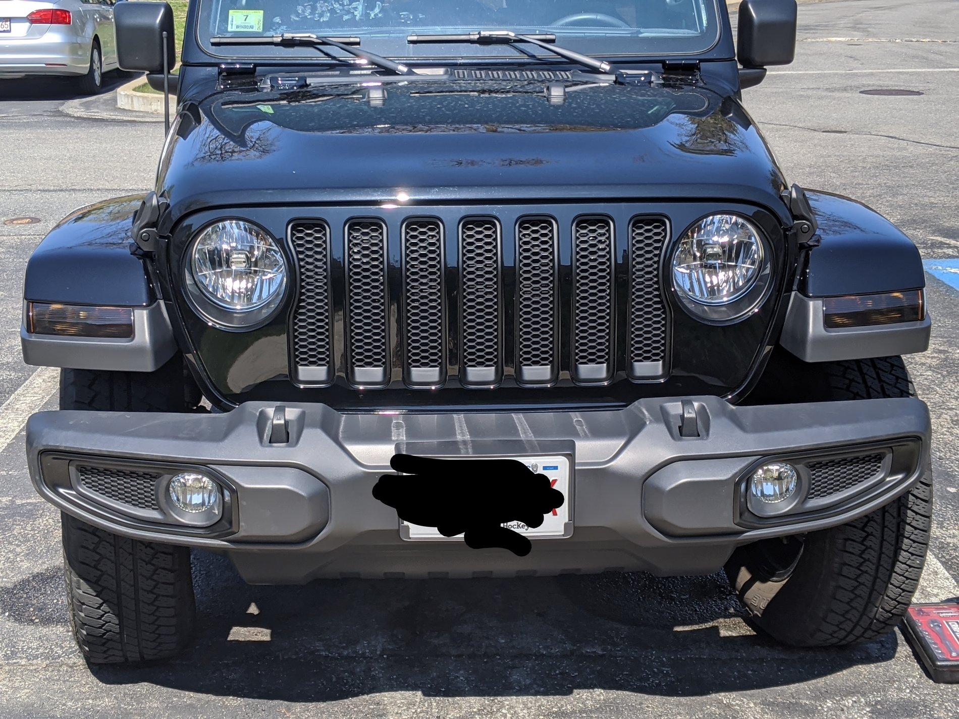

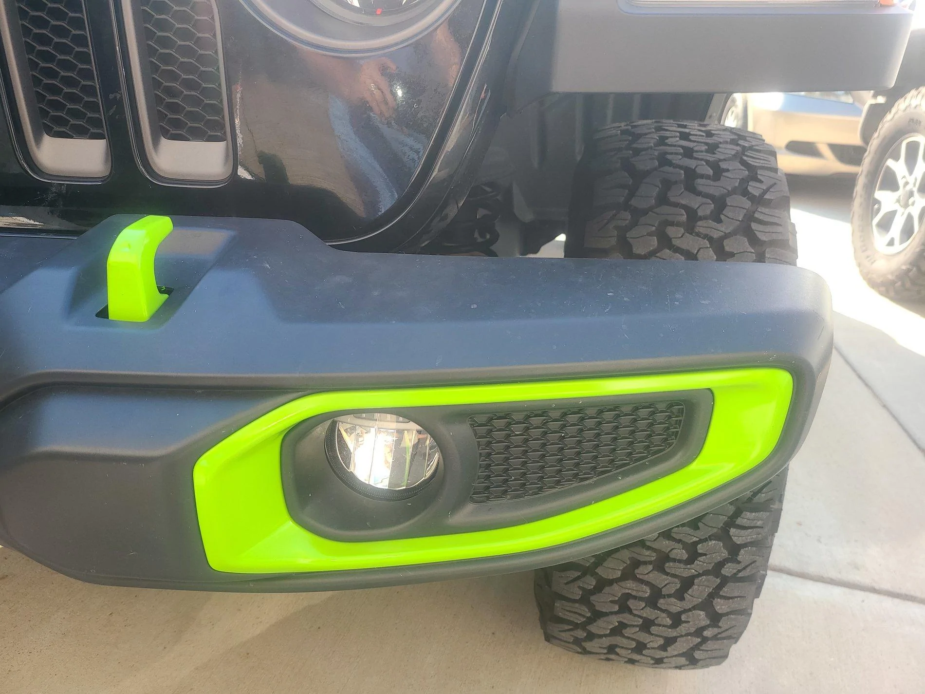

Finished product! Glad the chrome is gone. Thanks for everyone's help. These threads were very helpful. Only additional advice I can give is 1) use a kitchen knife to pry out the chrome (old) piece and go around the piece slowly, making sure you pop every clip before pulling on it. I pulled prematurely and snapped the piece. No big deal since I wasn't going to keep them but just thought I'd mention. 2) getting the metal screw clip out of the old piece was a bit difficult so I just snapped the plastic (see photo) and then removed with needle nosed pliers. [GALLERY=][/GALLERY]

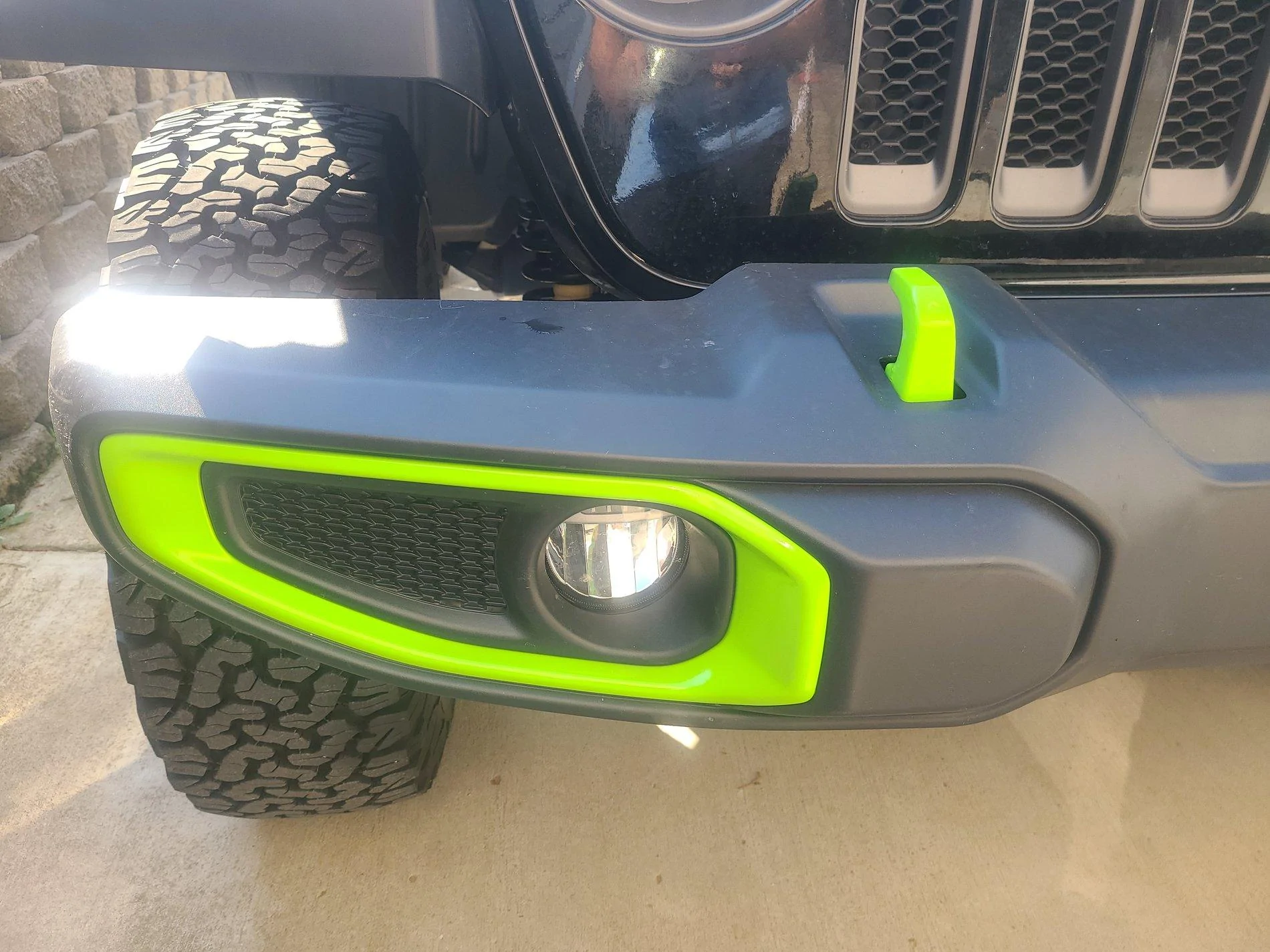

Thanks for all the good info on this thread. I followed the leads here and Michonne turned out great!
