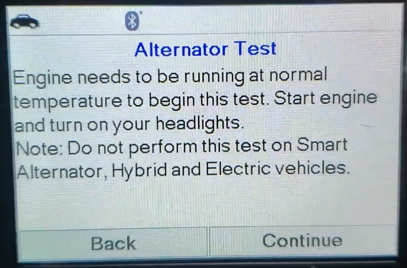

The tool I was using is an Innova 5610. It’s supposed to be pretty skookum. Maybe not?
I don't think the Innova 5610 alternator test is compatible with PWM alternators.
"Note: Do not perform this test on Smart Alternator..."
There is NO tool that can just clip on to a battery and tell you if an alternator is bad based on a charge/no charge condition. At best, it can tell you whether or not it is currently charging. Now testing for AC ripple, yea that works, but that’s very rare anymore.
Technically, the tool he has plugs into the OBD-II, so theoretically it could assess smart alternator performance to some degree. But I believe all it does is monitor voltage while the user switches on the headlights and revs the engine, so in most cases it doesn't actually collect meaningful information about a JL alternator.

Technically, the tool he has plugs into the OBD-II, so theoretically it could assess smart alternator performance to some degree. But I believe all it does is monitor voltage while the user switches on the headlights and revs the engine, which means it doesn't actually collect any useful information about a JL alternator.
That’s even worse then, the measured voltage at the obd port is unreliable as hell. Our scan tools regularly read a half volt low. Retrieving the system voltage data pid from the PCM is better, if it’s doing that, but then you’re totally losing the ability to measure for AC voltage.
