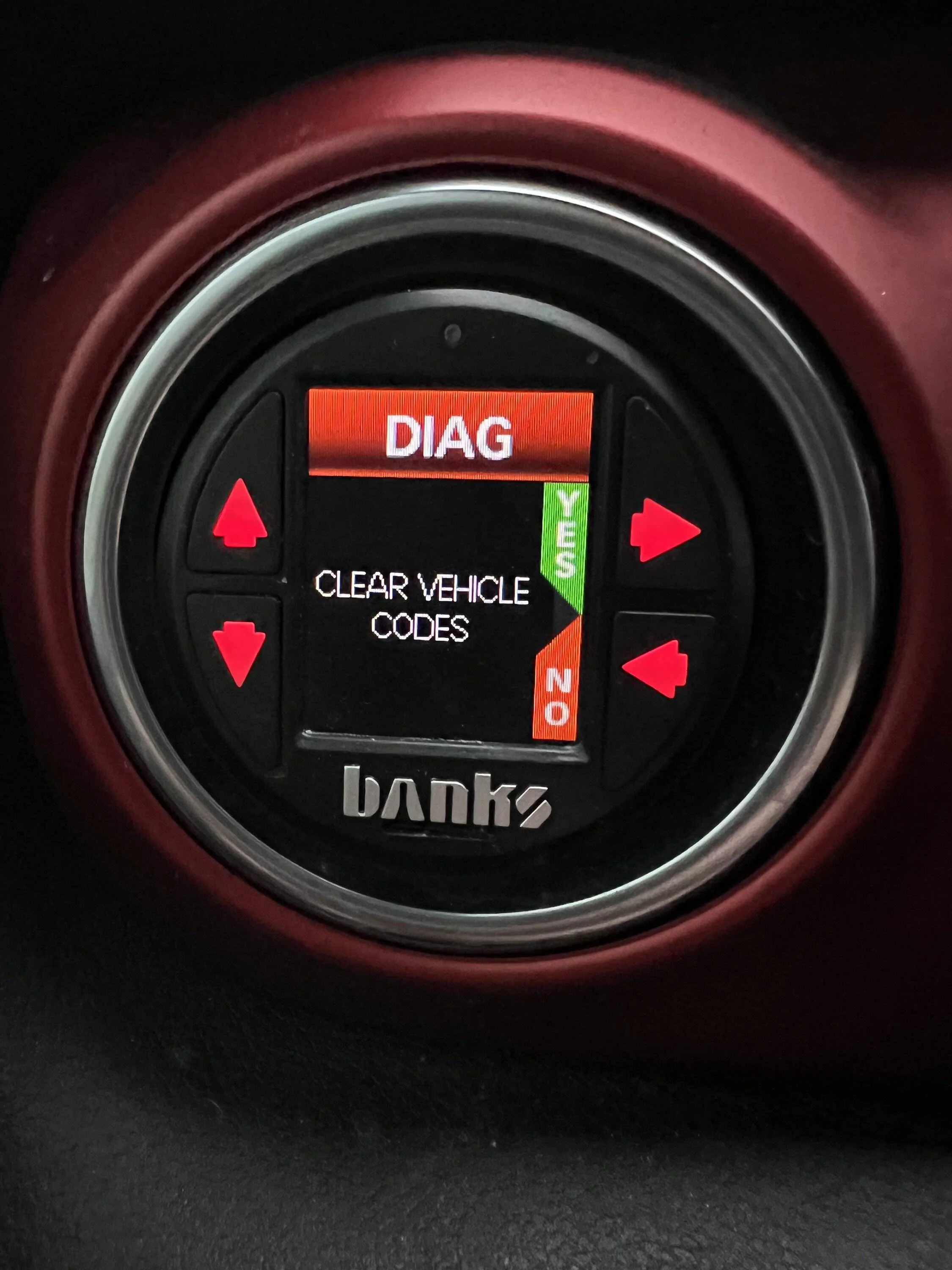

So I spoke too soon. Code came in today on the way back to work. Dammit lol. So if I’m reading all of these posts correctly, my options are turn the snorkel inlet around, ditch the k&n filter or run that mushroom deally? Lucky for me the Banks iDash can clear codes on the fly lol.

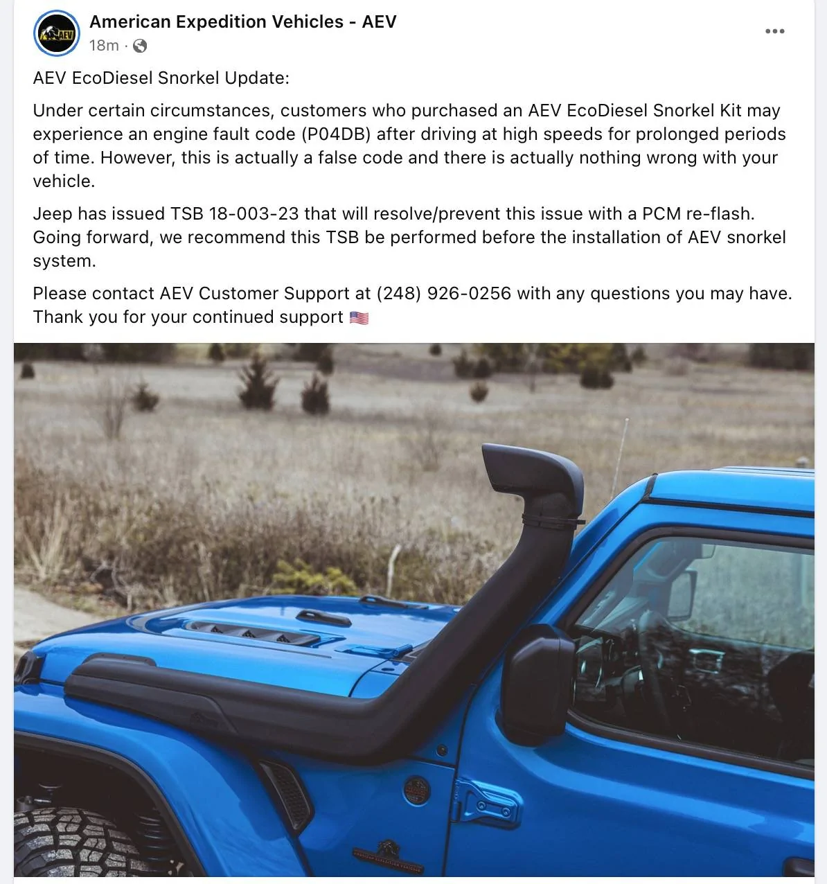

I wouldn’t call the two miles on the highway that tripped my CEL “prolonged”, but nice to see Jeep stepping up to the plate with an answer. I’m fairly certain the low pressure behind my reversed ram air cut a solid 1.5mpg off my average.

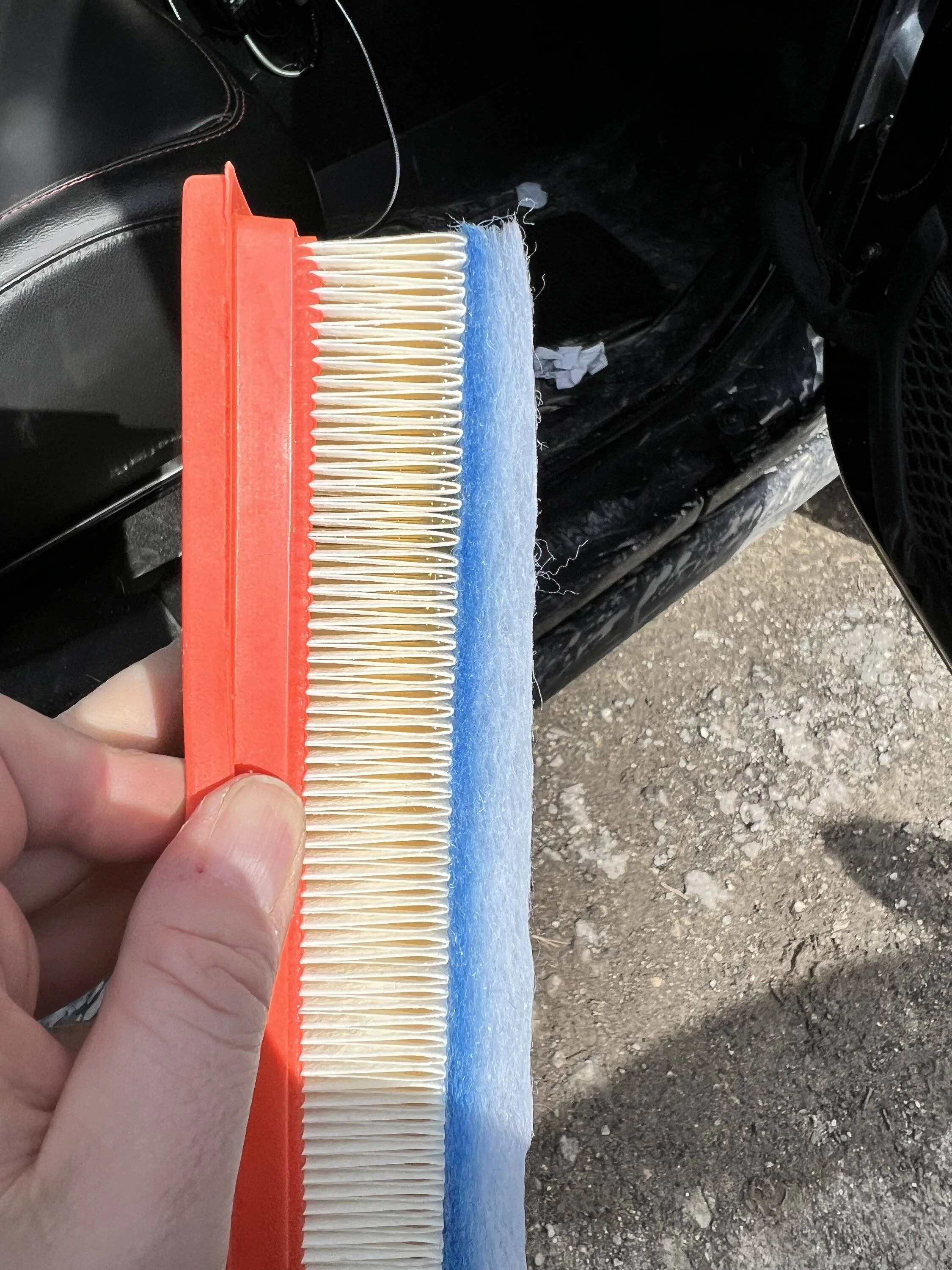

I now have 6 drive cycles with the oem filter and no cel. 4 of those are about 100km each. Fingers crossed that’s fixed it. I marginally lost mileage, went from 9.5 L/100 to 9.8 averaging 80-100 kph. I’d have to wait for the tsb, there’s a recall out for the DEF system I think and there is one for the injection pump but they don’t have parts. I need to get all the pcm flashing out of the way at the same time, then drive back over to Michigan to GDE to have it re-tuned.
i should have just glued some foam filter media on the bottom of the k&n, wouldn’t have been much different
