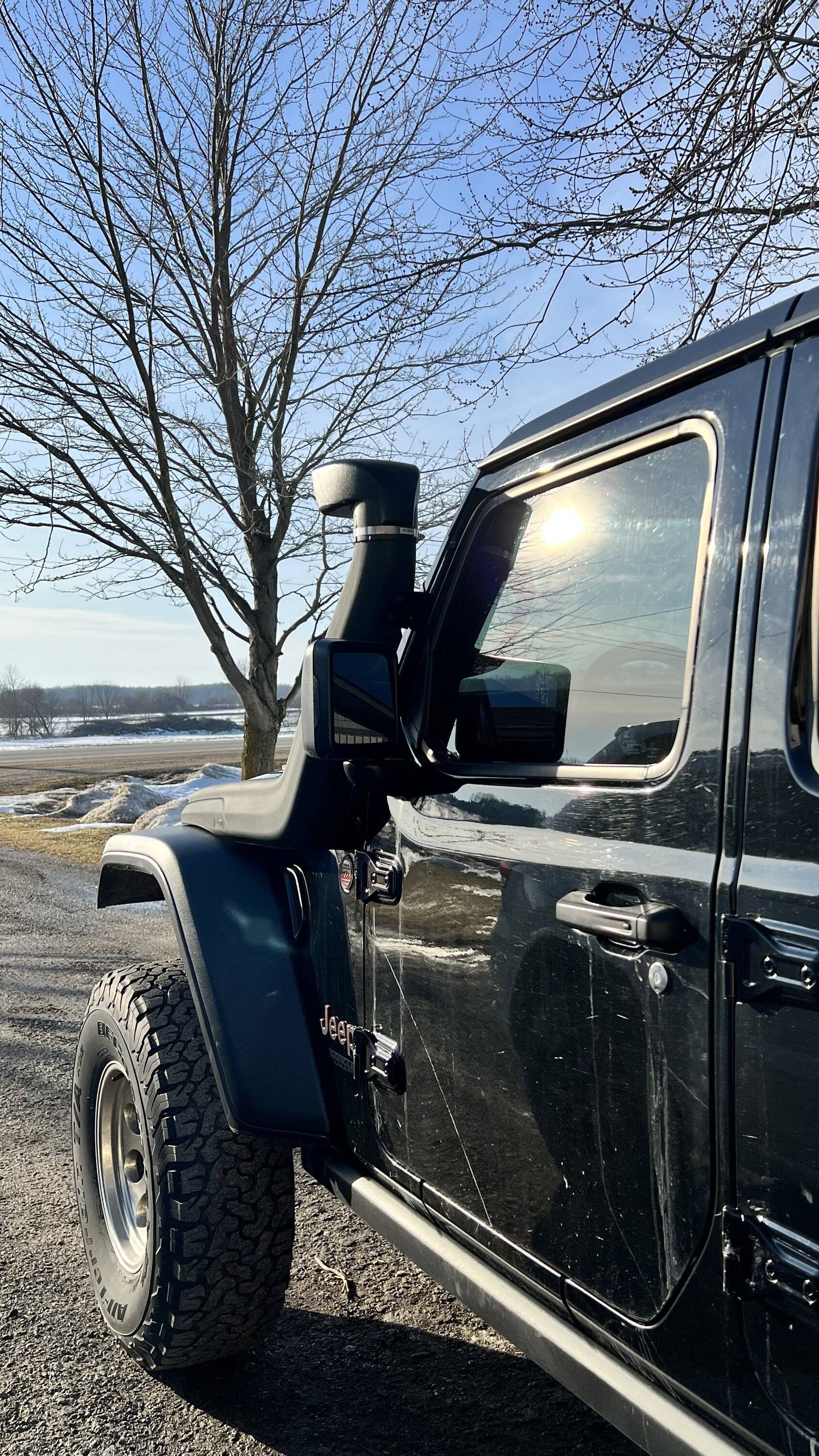

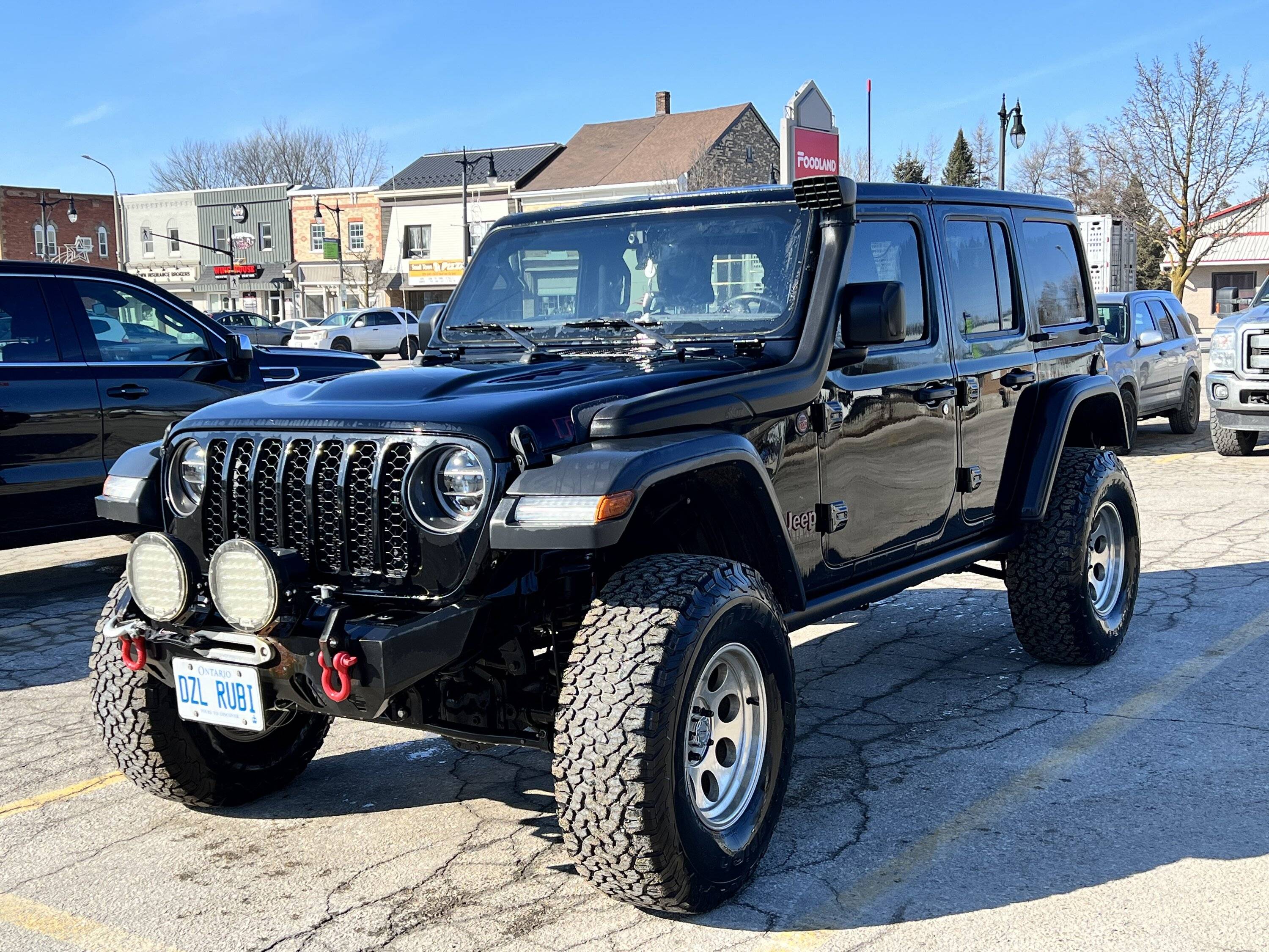

Got mine in and installed it yesterday. Looks great. A couple quick runs to town and back at 100kph and no code thrown yet. JLURD, how long of a drive and how fast were you going when it threw a code?

I’ve now run almost 200km with no CEL. Ran to work and back at various speeds between 60kph and 120kph. I wonder tho, because I’m running the GDE tune if the crankcase pressure threshold could be increased as part of the tune?
