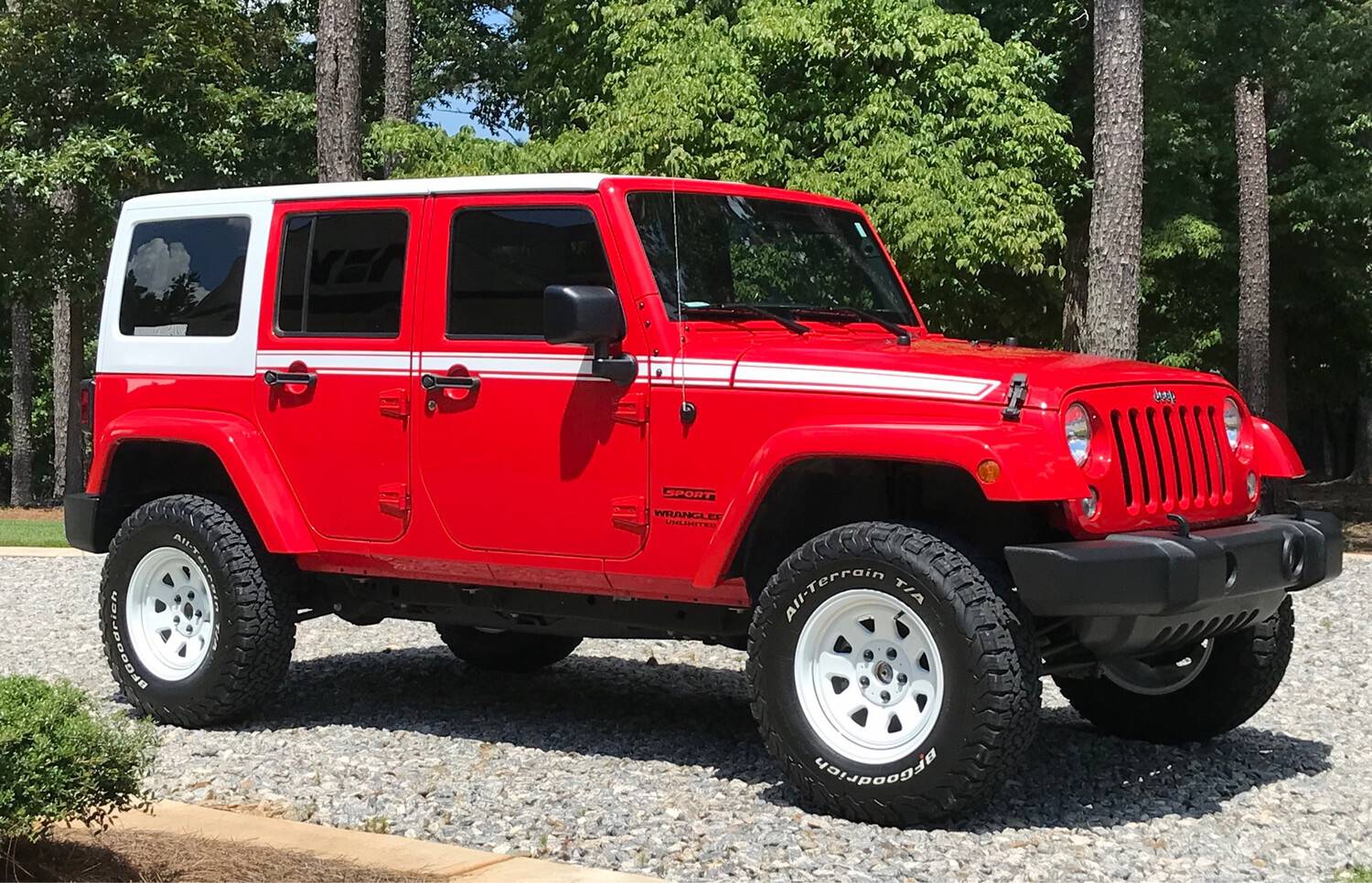

That is the exact Jeep that started my love for what I want to do. Red is my favorite color, though I was very close to buying a chief blue chief edition.
My build is more aesthetic. The way I want it to look, I just don’t want it to be just that though. I want the parts and build to function well, not just be pretty to look at. I do plan on a stubby bumper, either the OEM steel one since I really like it or the AEV RX. I enjoy my jeep as it is now. I just want to make sure what I plan to do I end up doing it right and understand it. Mpgs aren’t a concern, I’m getting just over 19 mpg doing my daily city miles commute. Which is better than I thought. Going to 33s is for the look and to get me started to try off-roading, nothing too serious.
That jeep is sexy! I think you would be a healthy candidate for the @Opus Sexy jeep contest next year.
