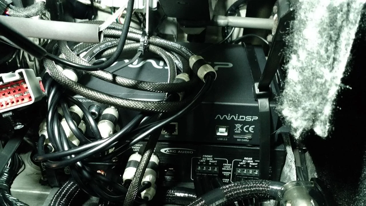

There is quite a bit of room under there for a smaller amp or even two... In my JK, I put a 4 channel amp and a dsp there. It's toughing working under there, but it's a great spot to keep electronics safe from weather and potential theft.
Here's a pic

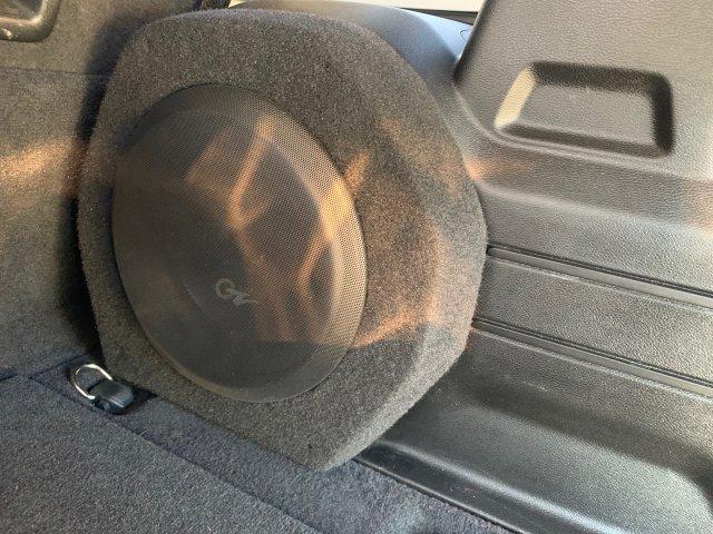

But, I found an under-seat box, wonder if anyone has tried them? I won't post a link because it'll be gone someday, but Google "Jeep Wrangler JL Unlimited 8" or 10"Subwoofer Box Enclosure For UNDER REAR SEAT" and here's a pic.
That looks great! Lucky 4 door guys... :)

Just what I was looking for. I'm debating removing the current sub and building a slightly larger box.
I'd seriously question whether the JL's rear seats would be able to fold down without crushing the box and speakers. To test it for yourself, try placing a small, empty cardboard box under your seat, and then fold the seat down. The JL's rear seats compress more than the JK's.
I can barely fit my hand and arm under there when it's folded down, and it's worth noting the pictures on the eBay site also look like they're of a JK. I do wish it were possible.

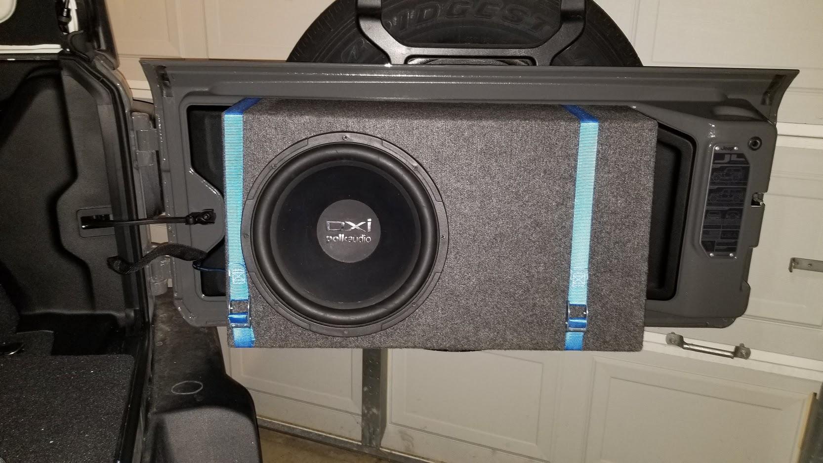

This is my temporary setup:
Jeep Wrangler JL Adding under-seat subwoofer 286218-84195214a07250d51cbf7da9526085e3
I had this same box and sub in my JKU for 3 years. Attached a HIllman 18in Picture Hanger found at Lowes to the trail rail bolts (had to drill some new holes to get them to line up) and used some spacers on the three bolts. Attached a 12in picture hanger on the back of the sub box. Cam straps are there to keep the box from flying out when hitting a bump and at this point are just held in by the clips on the cover panel for the tailgate.
The box is a Metra Slim Ported Truckbox:
https://www.bestbuy.com/site/metra-...cks-and-suvs-charcoal/4845811.p?skuId=4845811
The amp is mounted under the passenger seat. I used a 8x10 sheet of plexi to mount the Kicker 400.1 and used some 1" spacers to raise it off the floorboard. Should be somewhat protected in the event of a rain storm, at least off the carpet, but its not an expensive amp so not to worried. There is plenty of room under the seat for a small/medium amp and I am not the least bit worried about heat buildup. I ran an old Rockford 350.1 under the passenger seat of JKU without issues and I've done 100's of other amp installs in underseat and cramped locations, it will be just fine.
My end goal is to have a custom box on the tailgate that barley extends into the cargo area. I've done the mock-up just don't have time to build it currently but plan on Rhino lining it to protect it from the elements and to find a more secure method to attach the cam straps.
