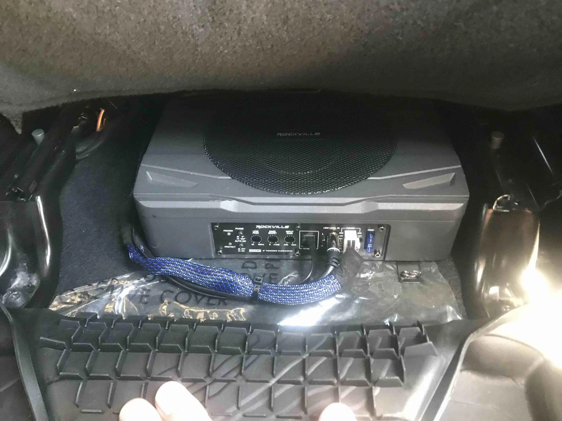

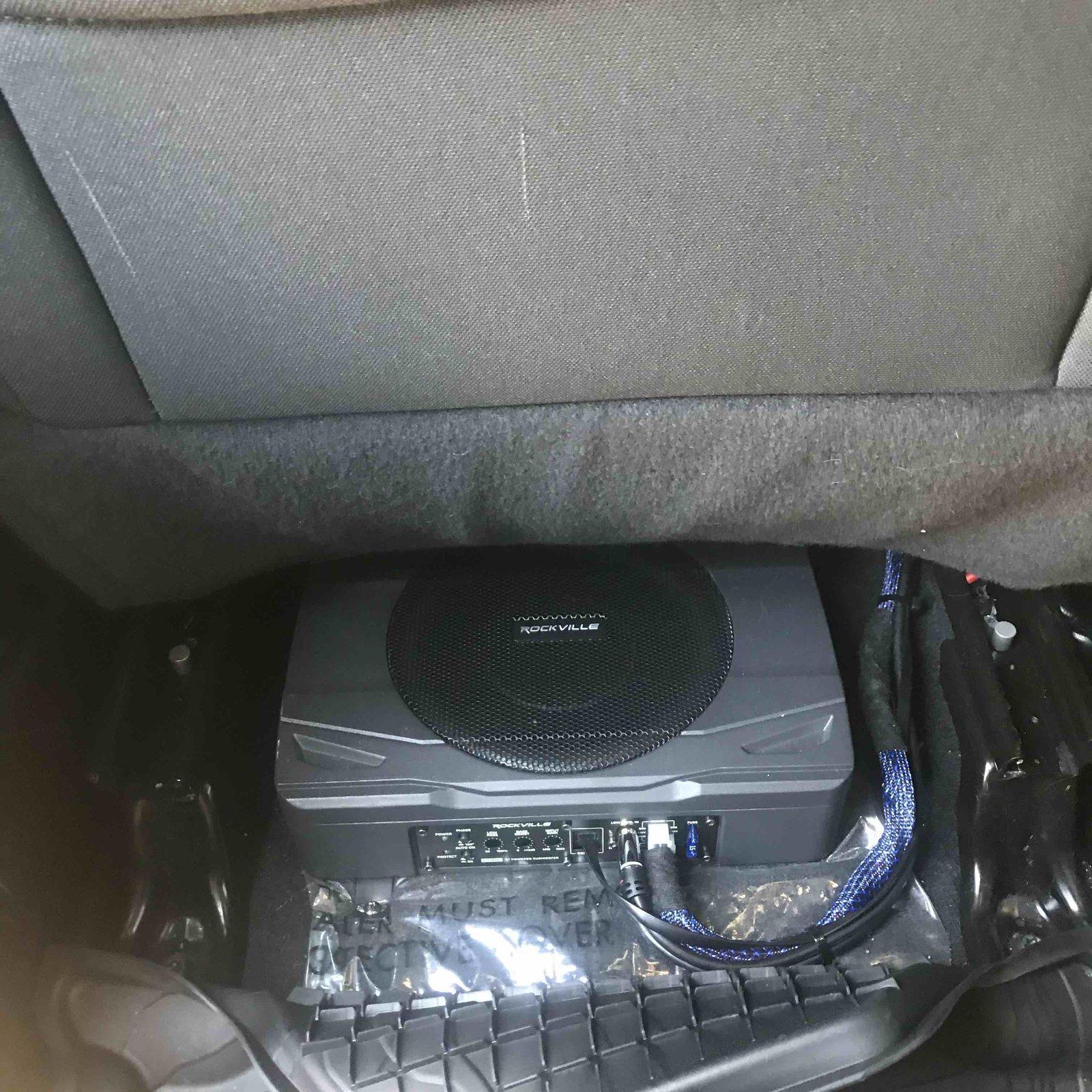

Starting point: Sahara, 7" head, non-alpine. Did not want to go full PAC, external AMP, etc, etc, and also wanted to keep it under $500. I wanted better high and low response. I installed the MOPAR Dodge Dart kicker speakers in the dash and sound bar, and installed an 8" powered subwoofer under each front seat. I did all the work myself.
Parts list:
Dodge Dart kicker speakers - $60 a pair
https://smile.amazon.com/gp/product/B008I2UYPI/ref=ppx_yo_dt_b_search_asin_title?ie=UTF8&psc=1
Rockville powered subwoofer - $85 each
https://smile.amazon.com/gp/product/B079PRCP9W/ref=ppx_yo_dt_b_search_asin_title?ie=UTF8&psc=1
Kicker Line out converter - $20
https://smile.amazon.com/gp/product/B00I4EF1BC/ref=ppx_yo_dt_b_search_asin_title?ie=UTF8&psc=1
25' of 8 gauge power wire w/ fuse - $30
RCA patch cords with splitter - $25
Various wires and connectors - $35
Total - $400
It sounds much better, especially what I was looking for - more high and low end response.
Wiring consisted of running the power from the battery, thru the grommet in the firewall (behind the glove box), over to the center console and back to the powered speakers.
Remote turn on power wire from the back of the cigarette lighter, thru the center console back to the powered speakers.
High level L and R signal tapped off of the bottom of the passenger pillar and then run to the kicker line out converter under the passenger front seat. From the LOC, split the RCA signal and sent a pair to each powered speaker.

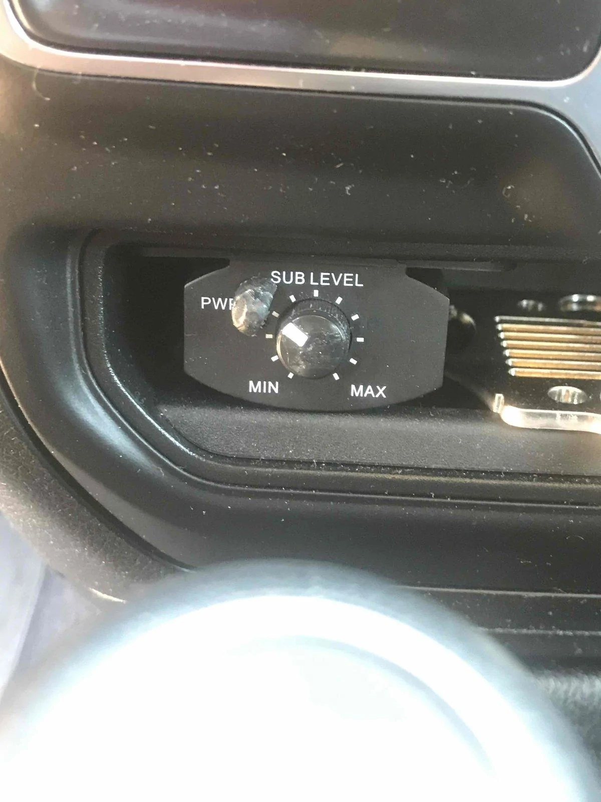

Finally, I combined the bass control wire of both amps into a signal wire and fed that back to the cubby just under the cigarette lighter.

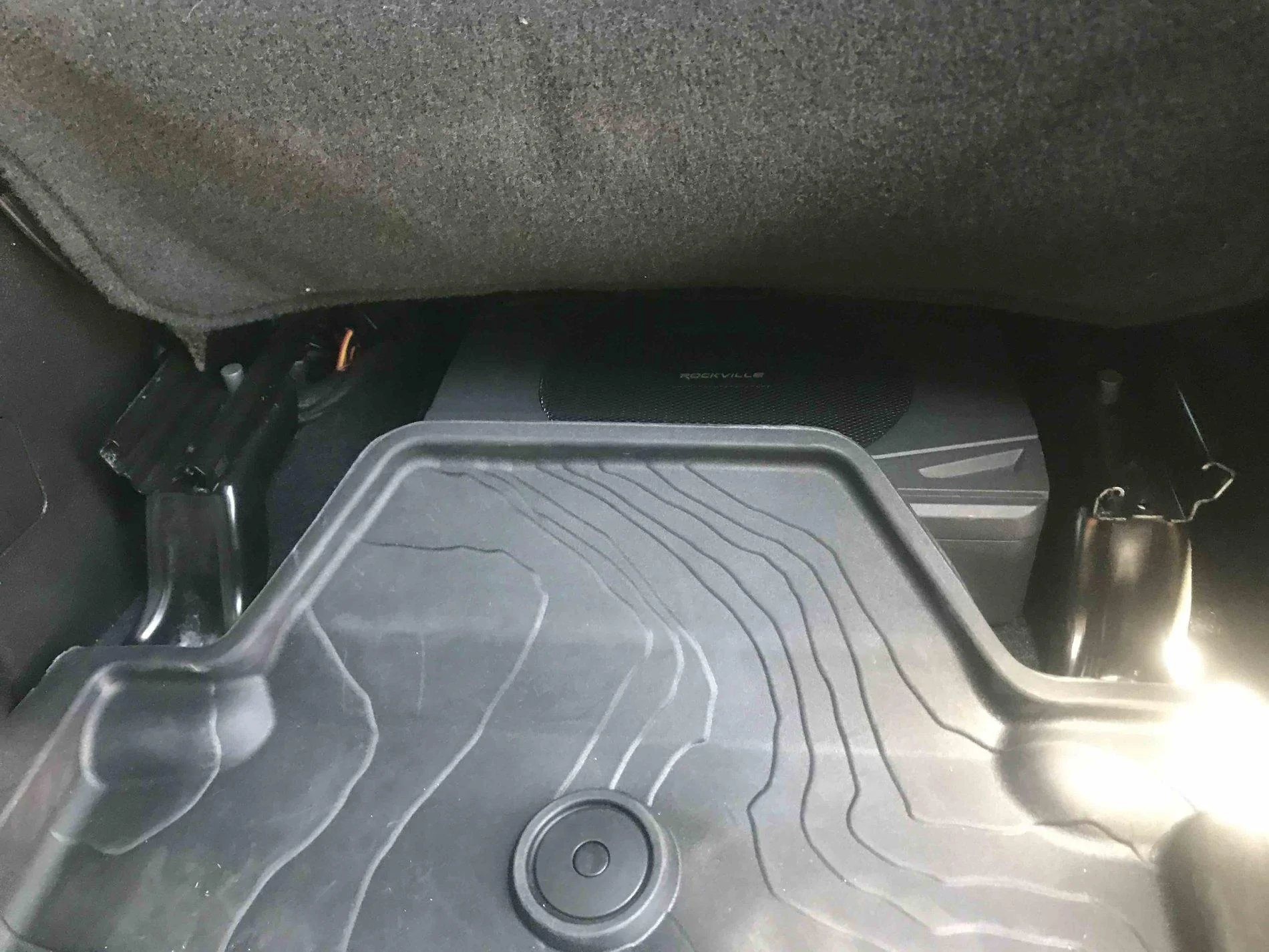

These powered speakers are thin enough to allow the underseat vent to be pulled up and blow over the top of the speaker for both the driver and passenger.

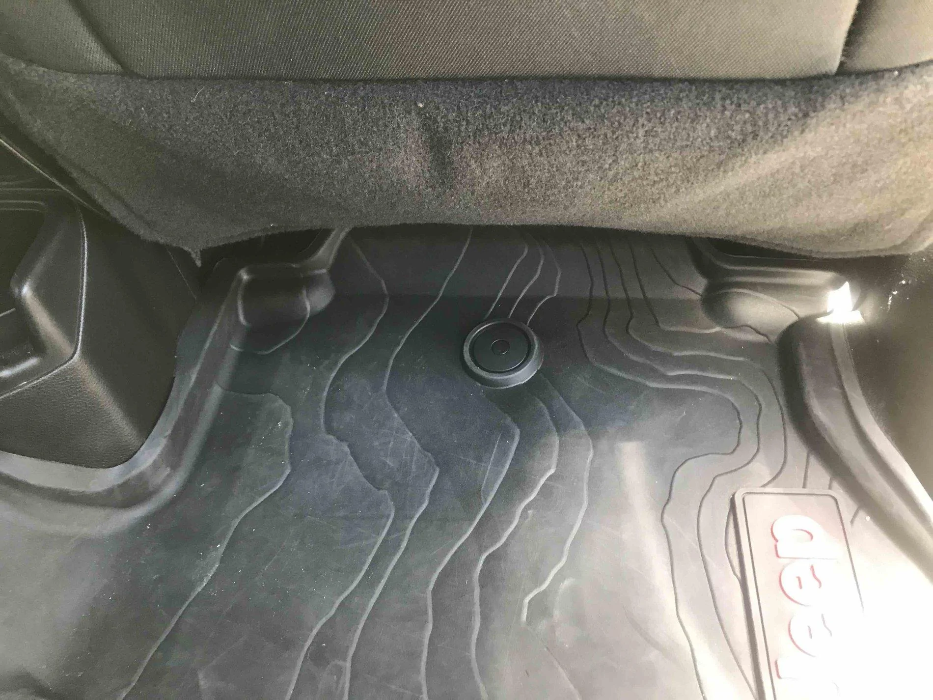

I pulled both front seats and also the center dash and right side of the center console in order to run the wires and get the powered speakers screwed down. The jeep rubber floor mats fit perfectly over the edge of the powered speaker - which keeps any rear seat passengers from kicking them and their connections. With the front seats fully back, you would never know the speakers are even there.
Time spent: 8 hours. Hardest part: fishing the power wires thru the firewall grommet.

Also, the picture of the bass knob shows the mods I did to it. I superglued a white piece of plastic that sits about 1/16 of an inch above the knob so I can feel and see the knob better (the knob is smooth and black and hard to see where it is pointing out of the box). Also, the blue power LED on the knob is WAY too bright at night. So I made a little hood and superglued it as well. Both changes work great.
