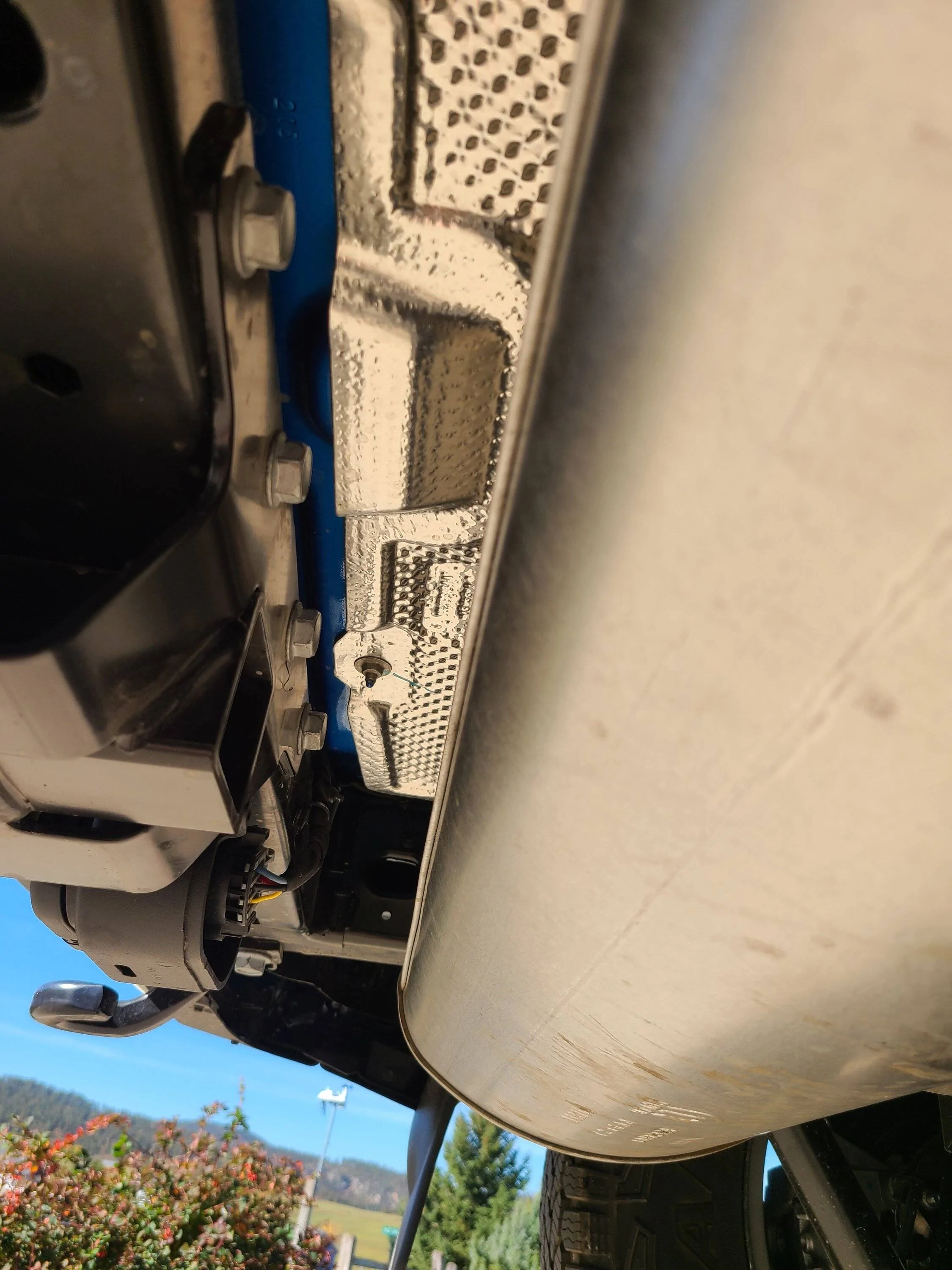

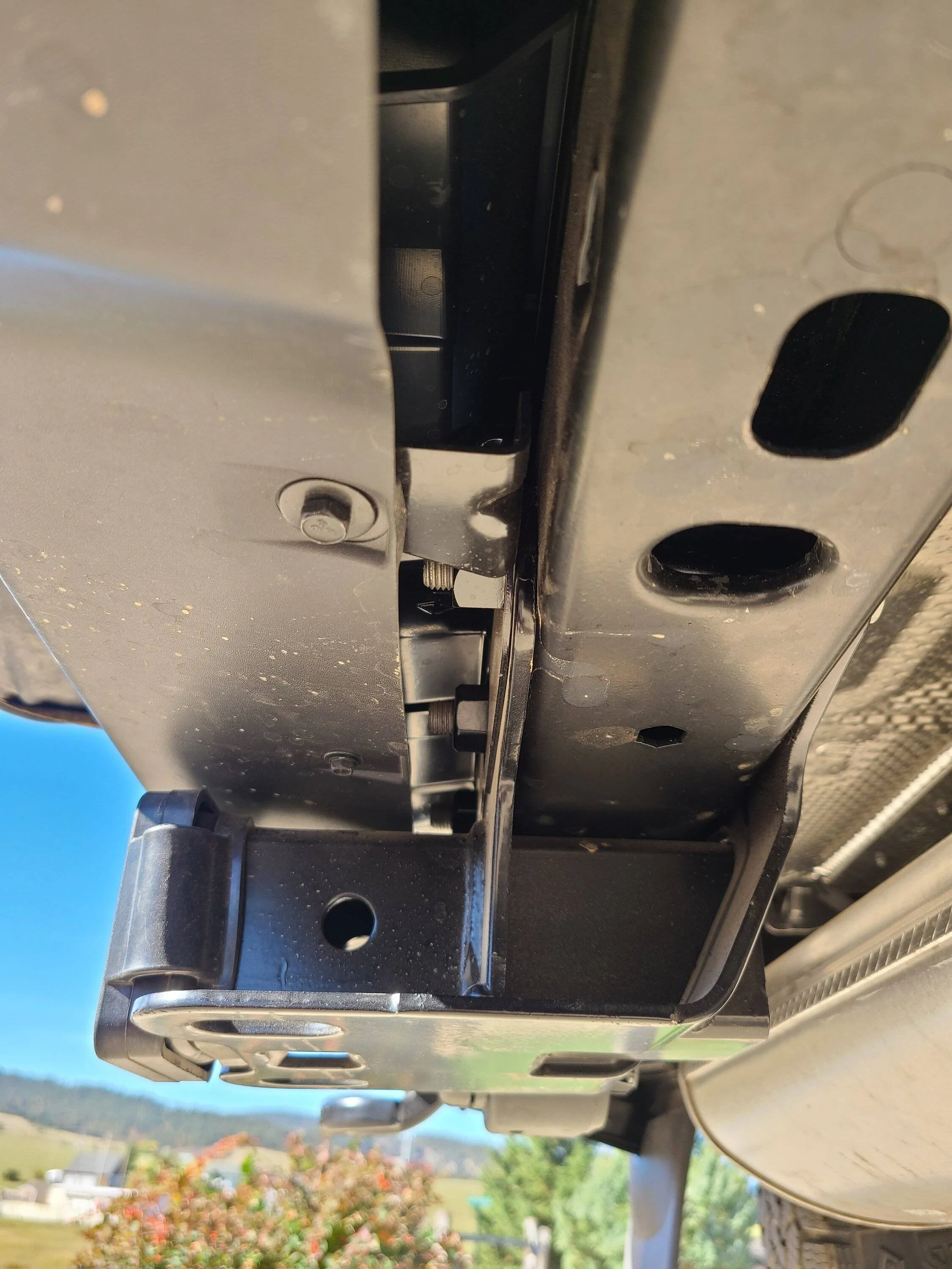

If I recall correctly (this was on my 2020 which I no longer have), there was two bolts already installed. I removed them and installed the hitch with no problem. I know the hitch was secured with 4 bolts once it was installed.
I just added a MOPAR hitch to my 2024. It also had 2 long bolts holding the bumper support bracket in place. I removed those two and the two small lower bumper support bolts, slid the support bracket away from the cross-member and slipped the hitch into place. I secured it with the 4 new large bolts and then reinstalled the two lower bolts to the bumper support.

The 2024 Sahara has an assembly on the cross member that the hitch attaches to.
I will take a photo later. but its bolted to the cross member and the nuts do not come off.

The photos above are from my 2024.

So what I did was take the spot welded nuts off the hitch receiver.
Once they were off, the receiver slid up and I was able to attach it
with the bolts from jeep and two bolts and nuts previously used.
Thanks for all the help.
