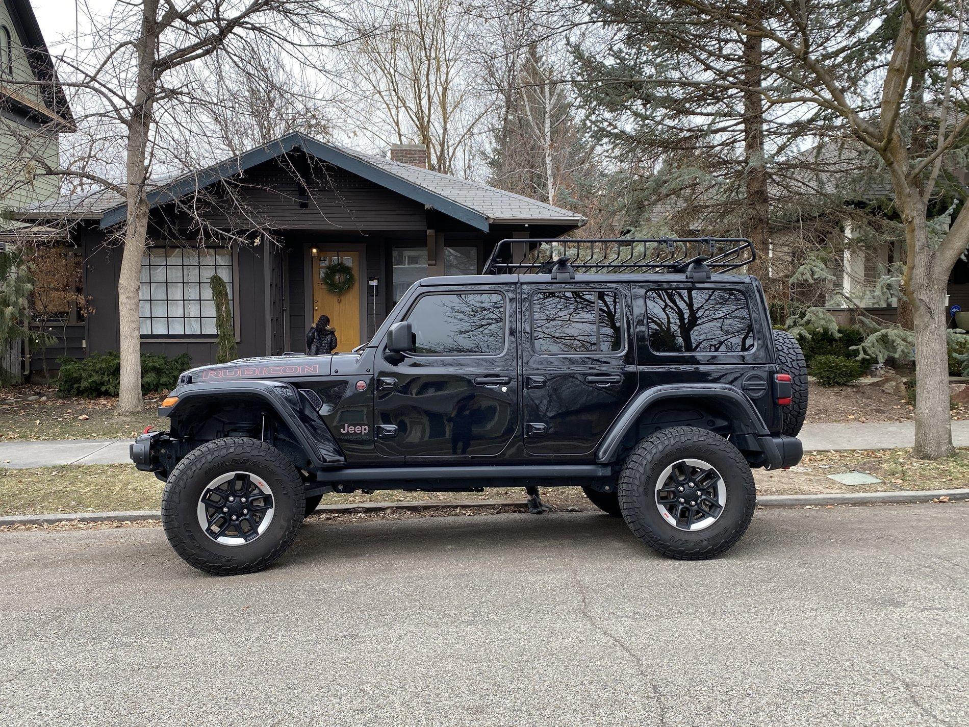

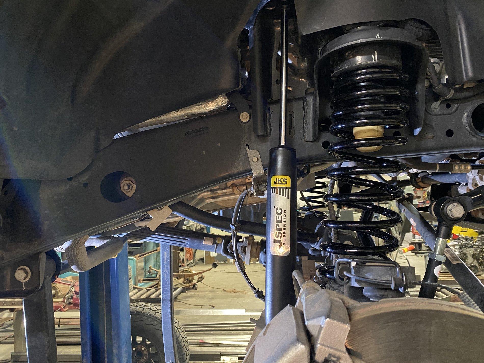

I just installed a JKS Jspec 2.5" lift on my 2018 JLUR w 35s and it previously had a leveling kit on it, which was a shock extension bracket and a 2" coil spacer. I left the spacer on cause I didn't have the stock spacer. Everything else I installed per the instructions. Not sure if my Jspec shocks will be ok with this. Any ideas? It does rake upward just a bit too much in the front. I'd love to just put an inch spacer above the rear coils to balance it out. Thoughts on this?
