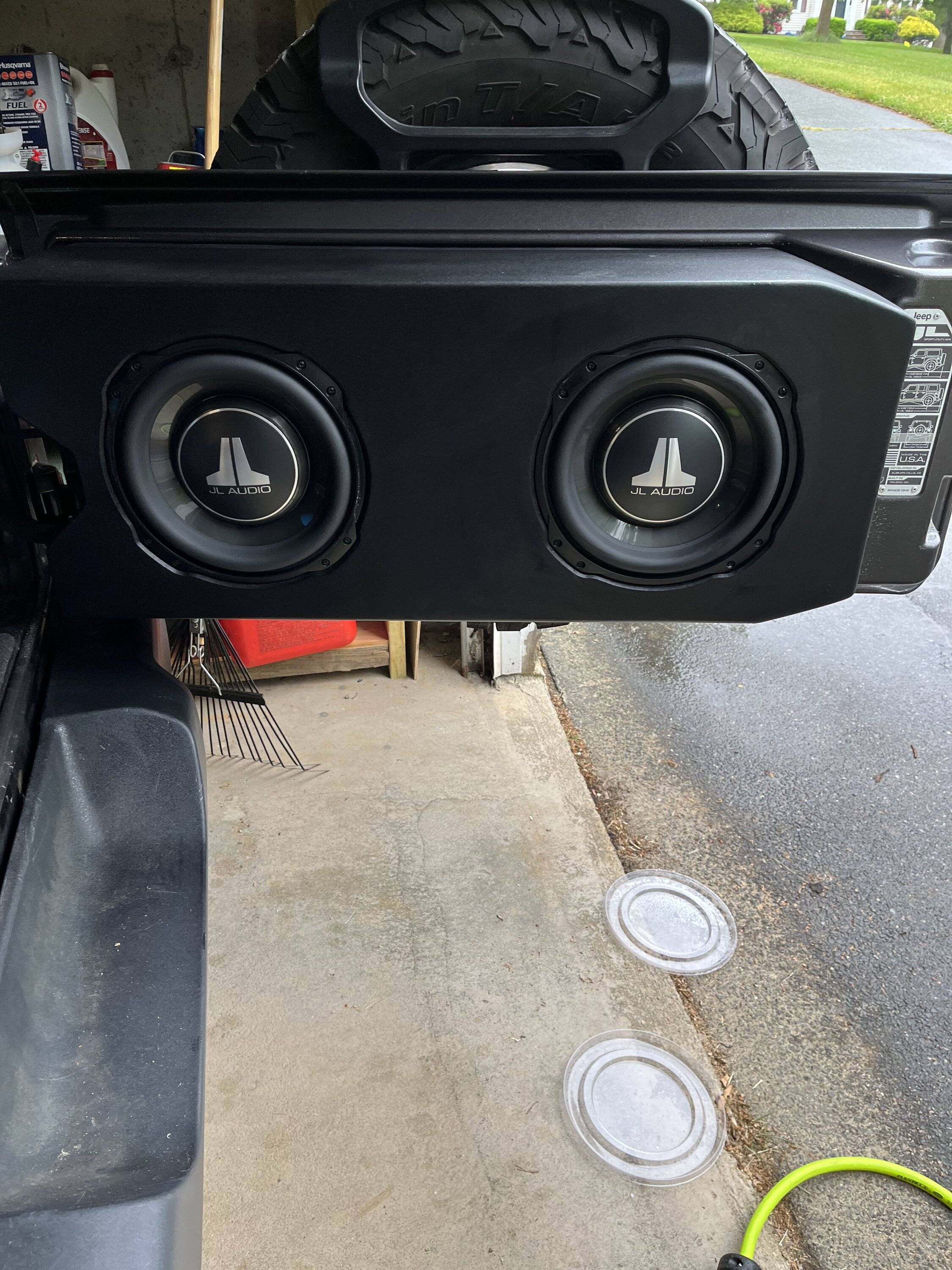

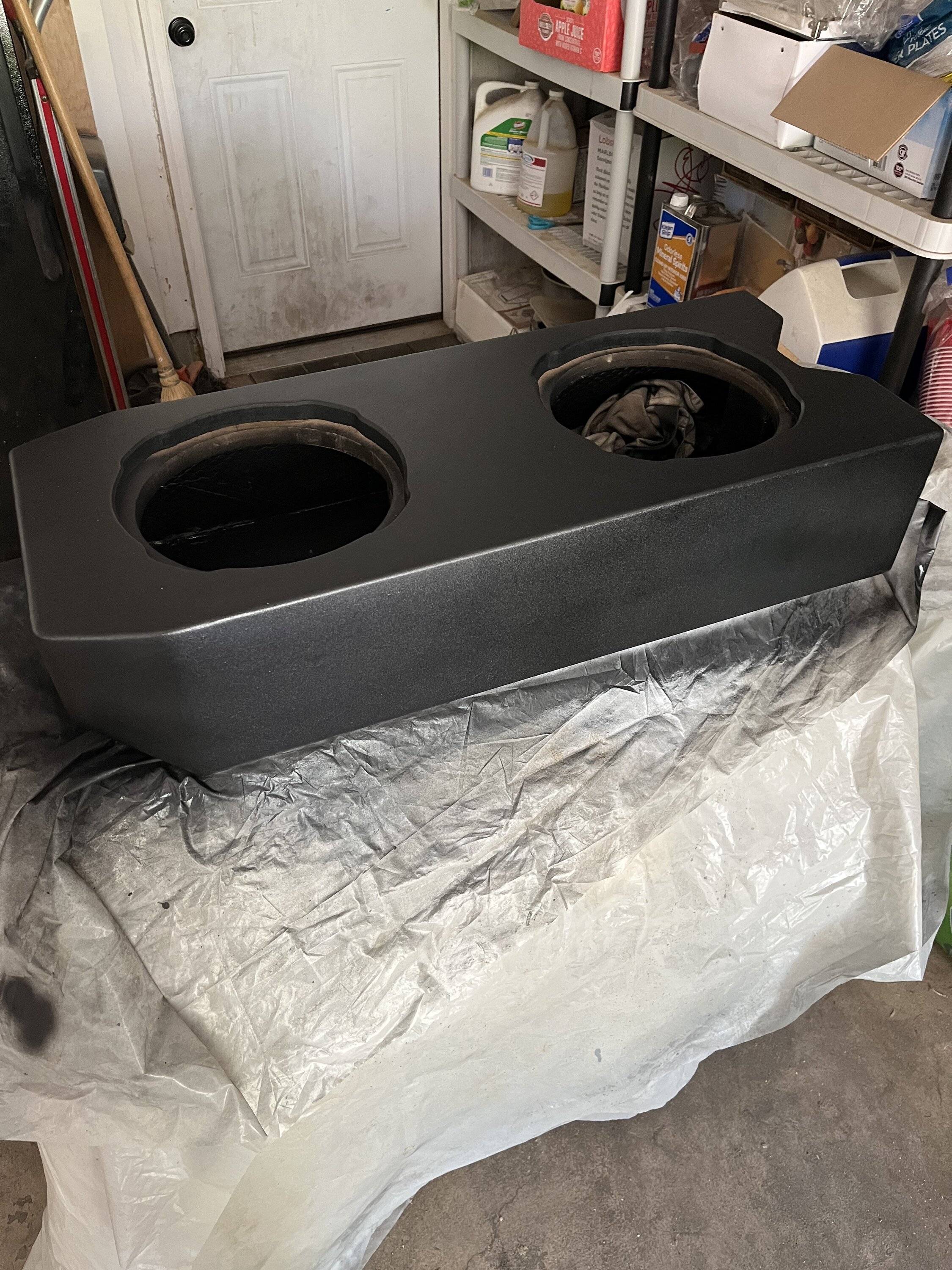

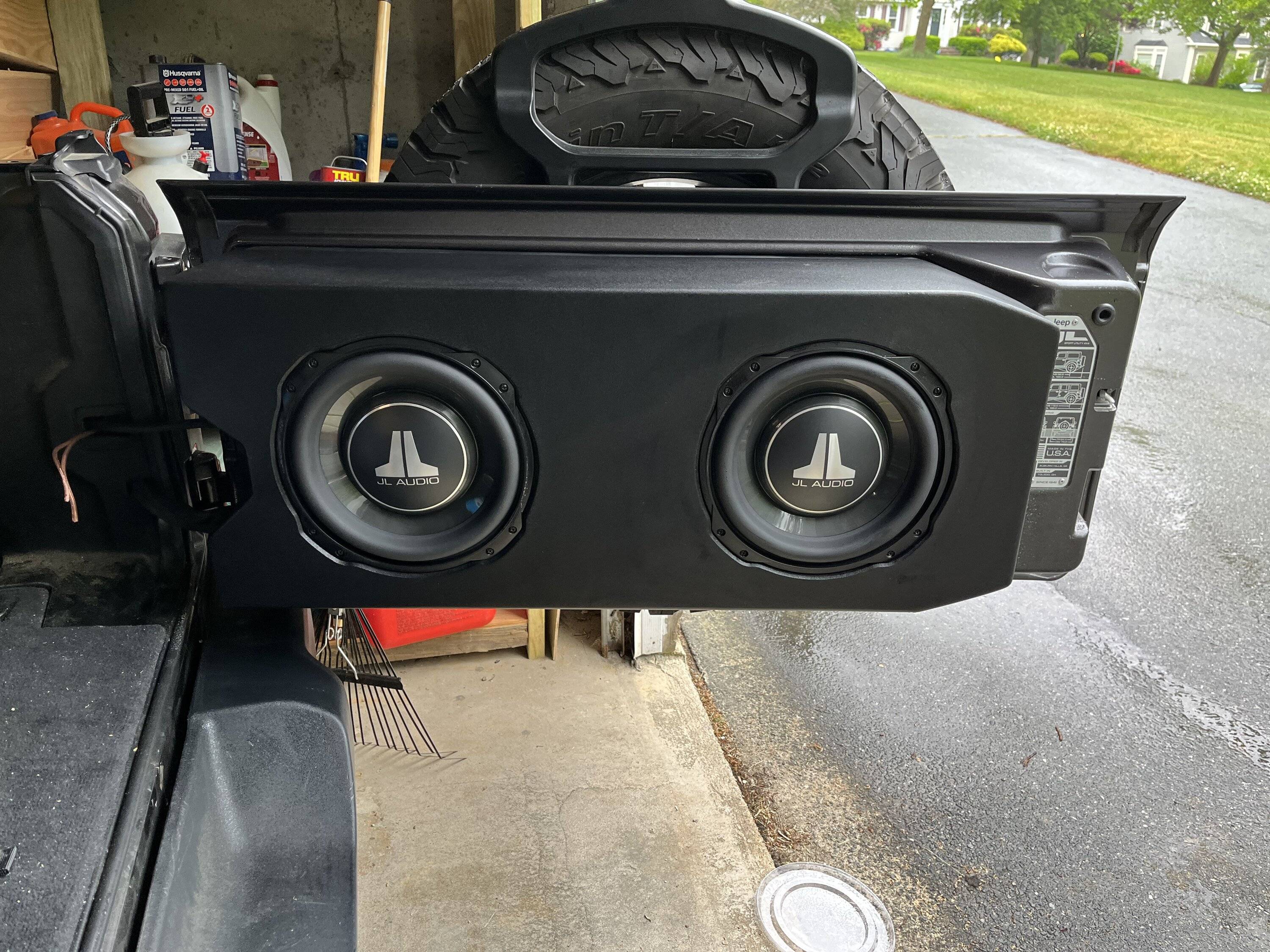

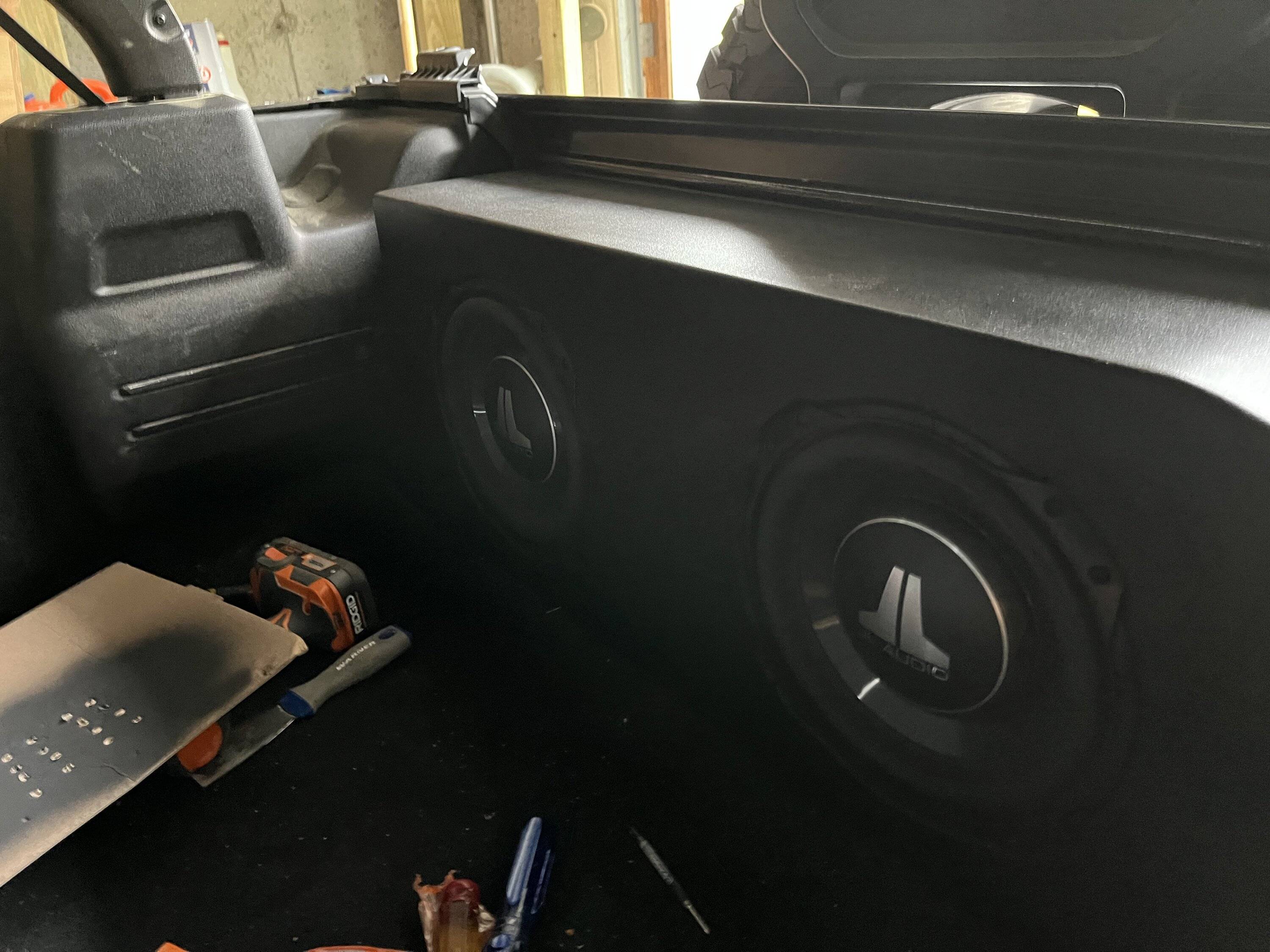

I just dropped in 2 JL 10Tw3’s in a sealed net 1.1 and they sound amazing running off 600w rms Hertz hdp1. I sprayed the mdf box with rhino liner
This looks awesome. I'm pretty sure it bumps too. That said. Does it rattle?

The tailgate doesn’t rattle at all because the box is flush to the floor. The top does rattle at higher volume.

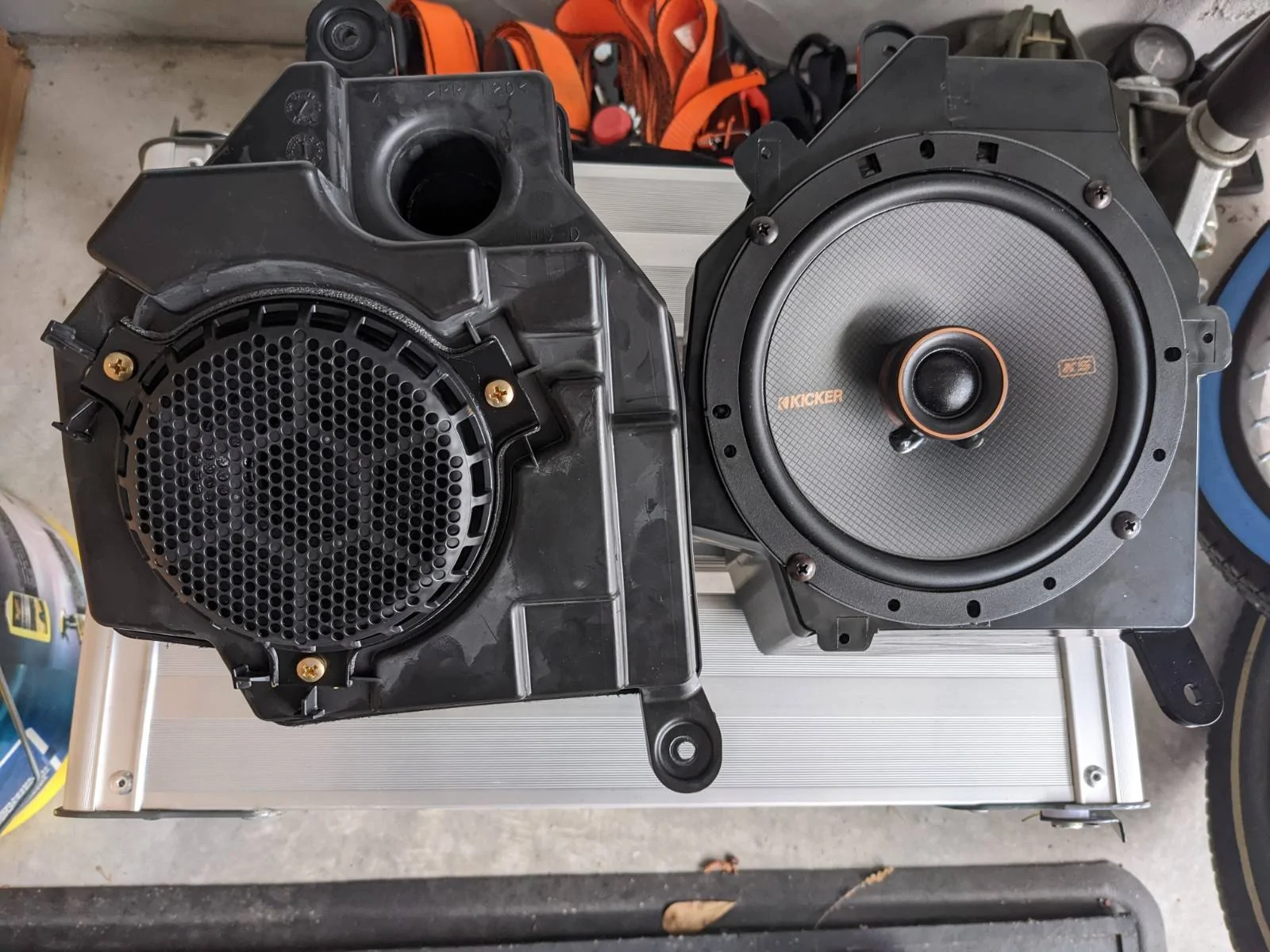

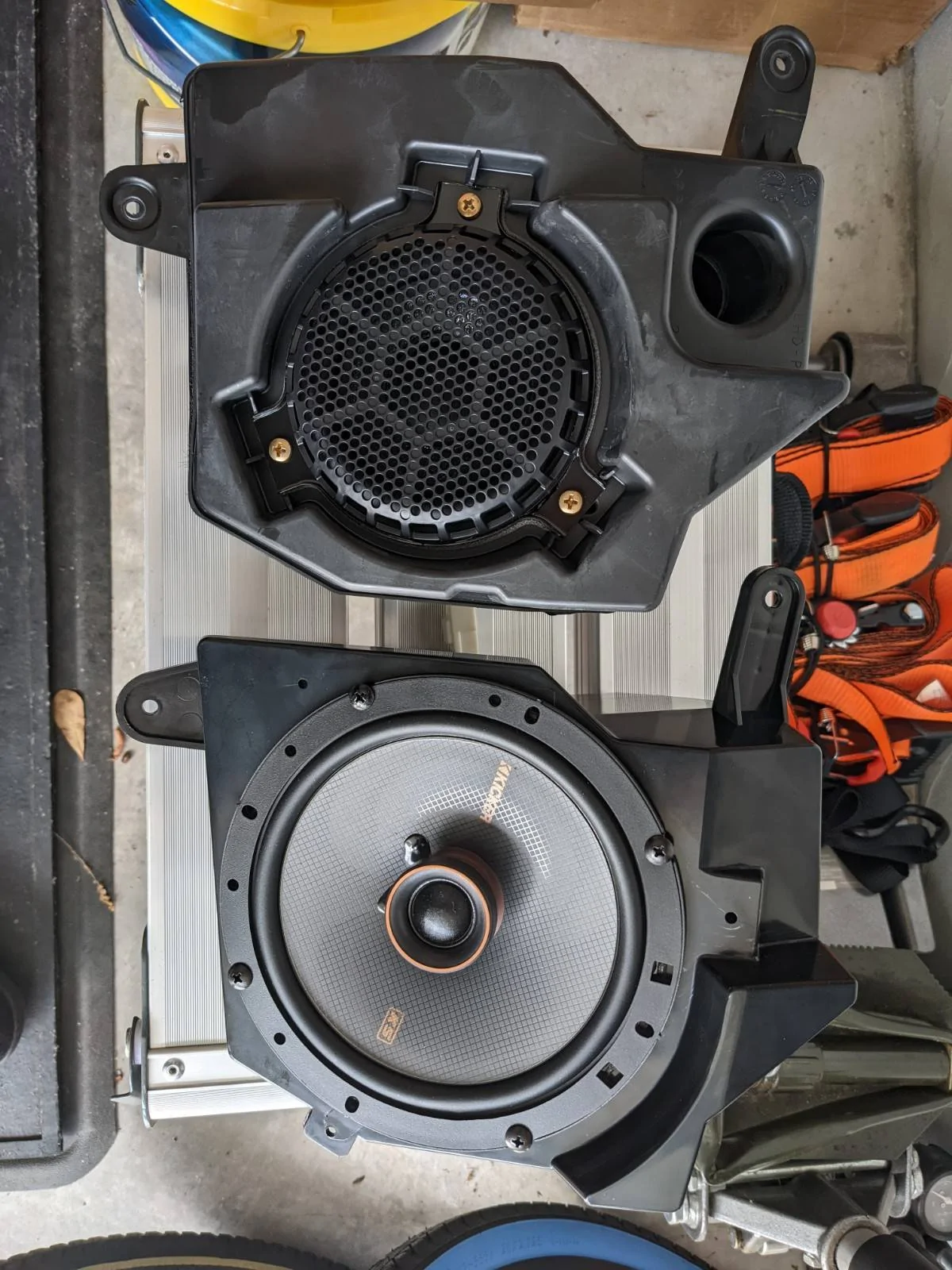

Sting NC USA, the information provided worked great regarding the shortcuts for installing the driver-side lower speakers. This was quicker then when I installed this setup in my 2021 JEEP Wrangler Willy's 2 Door without the Alpine System.
I used the Metra Electronics JP1014 JL Wrangler Front Speaker Pods and Kicker KSC 6704 6.75" Coaxial Speakers with some polyfill in the speaker pods in my new 2022 JEEP Wrangler Rubicon Recon Unlimited with the Alpine System.
The next upgrade will be the factory Alpine subwoofer or adding an additional 12" subwoofer and Sub Amp.
I also found a new amp wiring kit that includes a fuse mount and amp mount(s) that are specific to the JEEP Wrangler JL. Depending on which kit you purchase from Metra. JP-18AMP-1 JEEP JL 2018-UP Single Amp Installation Kit Metra Electronics | Jeep® JL 2018-Up / JT 2020-Up Single Amp Installation Kit (metraonline.com) and JP-18-AMP-2 JEEP JL 2018-UP Dual Amp Installation Kit Metra Electronics | Jeep® JL 2018-Up / JT 2020-Up Dual-Amp Installation Kit (metraonline.com).
