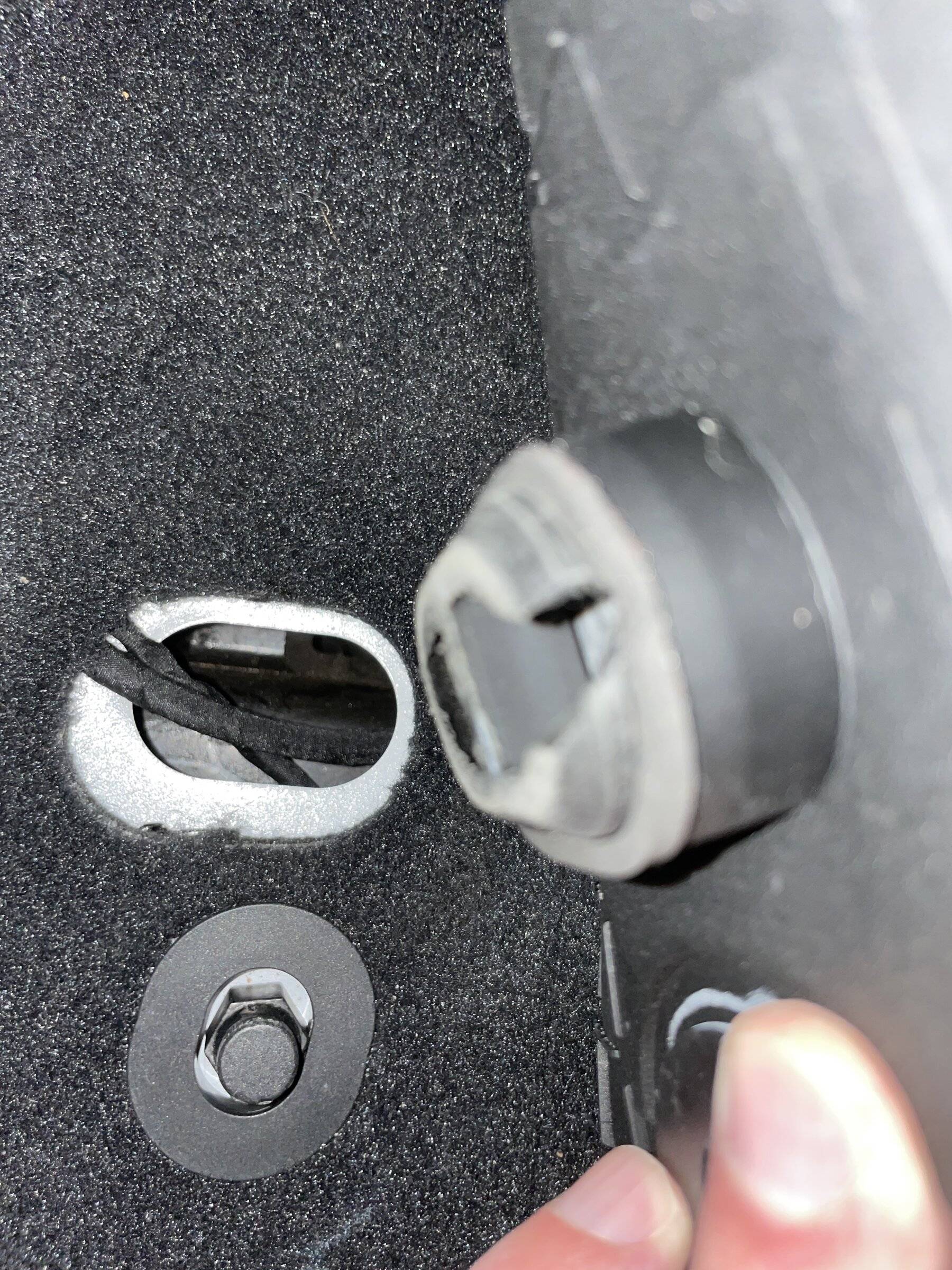

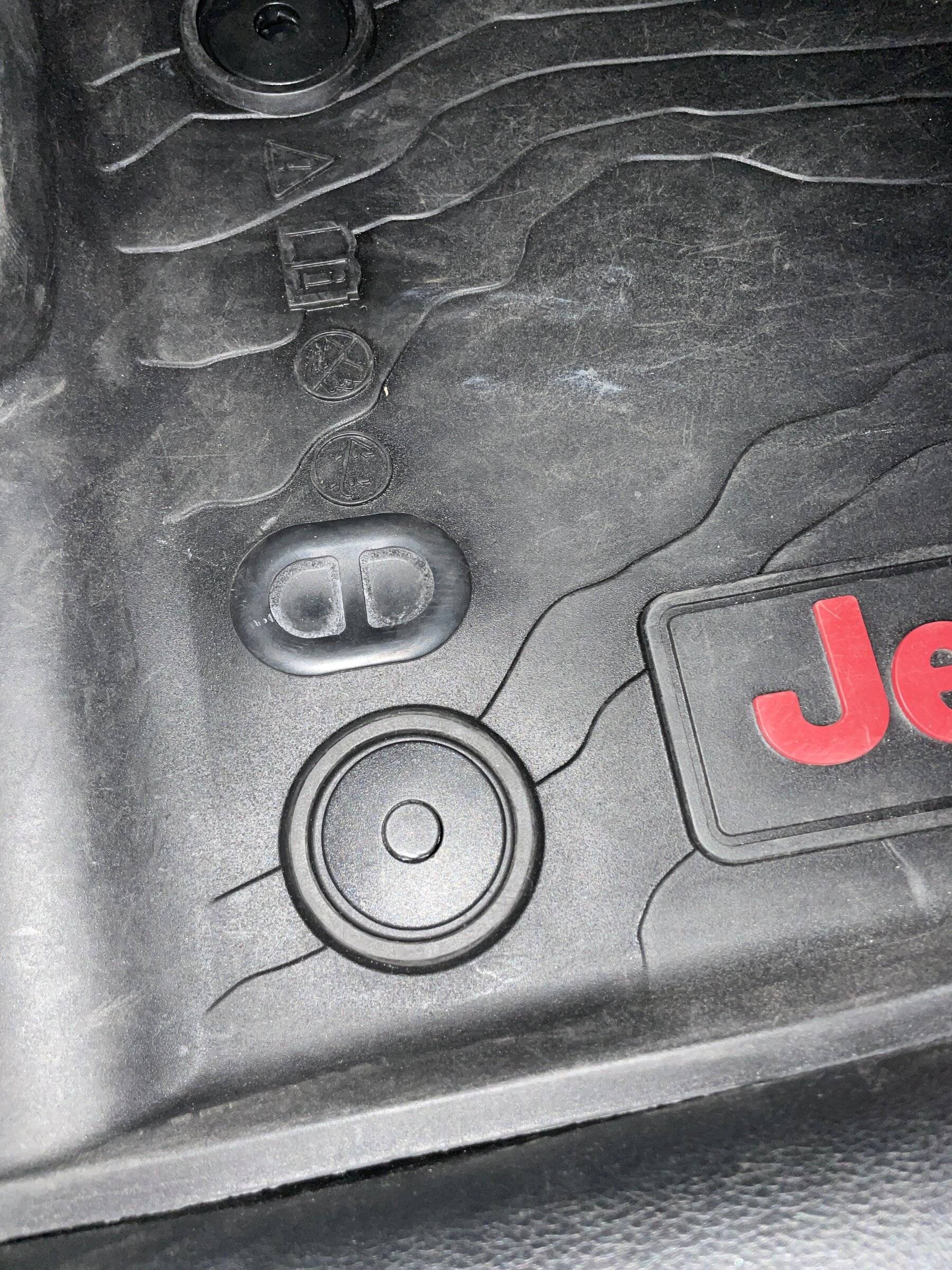

Thanks for the pic of the glovebox grommet. Was hoping there was an option to the drain hole for power wires. If I end up adding a sub under the front seat I plan on going through that drivers side grommet.
You can run through the drain hole under the carpet on the passenger front hole. I actually ran my MB Quarts power through the passenger front drain hole as they suggested in the instructions. It was pretty easy and I snaked my power wire and tie wrapped on top of the frame toward the engine and then went up to the battery. The wire is out of the way for off roading and not visible at all. There is another wire or cable running along that frame that you can tie wrap to until going up to the engine. If I would have known about the drivers side firewall plug hole at the time and how easy it was, that would have been my first choice. I don’t remember if there was enough wire length to use the MB Quarts Kit power though the drivers firewall plug, so might want to check that.Thanks for the pic of the glovebox grommet. Was hoping there was an option to the drain hole for power wires. If I end up adding a sub under the front seat I plan on going through that drivers side grommet.

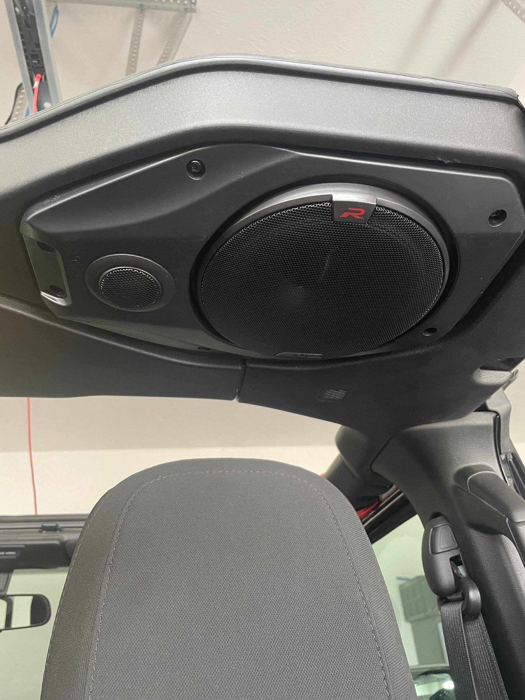

Yes, components in the front and in the rollbar. I know the tweeter placement up front isn't ideal but it works for now. Used a dremel to cut a hole in the stock grill and they screw into place.I bet that sounds awesome! Did you do a set of the components in the front + roll bar? I"m thinking about buying the same set.
That actually doesn't look bad at all. Is that the SSV Works adapters in the sound bar?Yes, components in the front and in the rollbar. I know the tweeter placement up front isn't ideal but it works for now. Used a dremel to cut a hole in the stock grill and they screw into place.
Metra JP-1015, purchased at local car audio shop.That actually doesn't look bad at all. Is that the SSV Works adapters in the sound bar?
