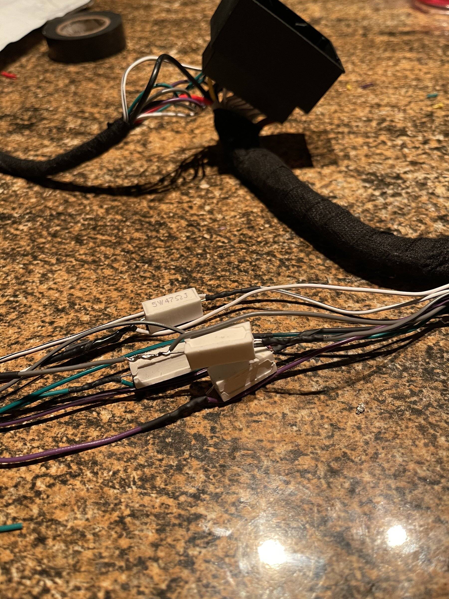

It’s looks like the resistors in the link aren’t available anymore, will any resistor with those specs work? I’m halfway through upgrading all the speakers in my car and adding an amp and I didn’t realize I had to trick the uconnect with the resistance until tonight. Thank you so much for the help!
Hey Nick, yes the specs are the key for choosing resistors. If you are using the PAC, you don't need to use them. Good luck with your install!

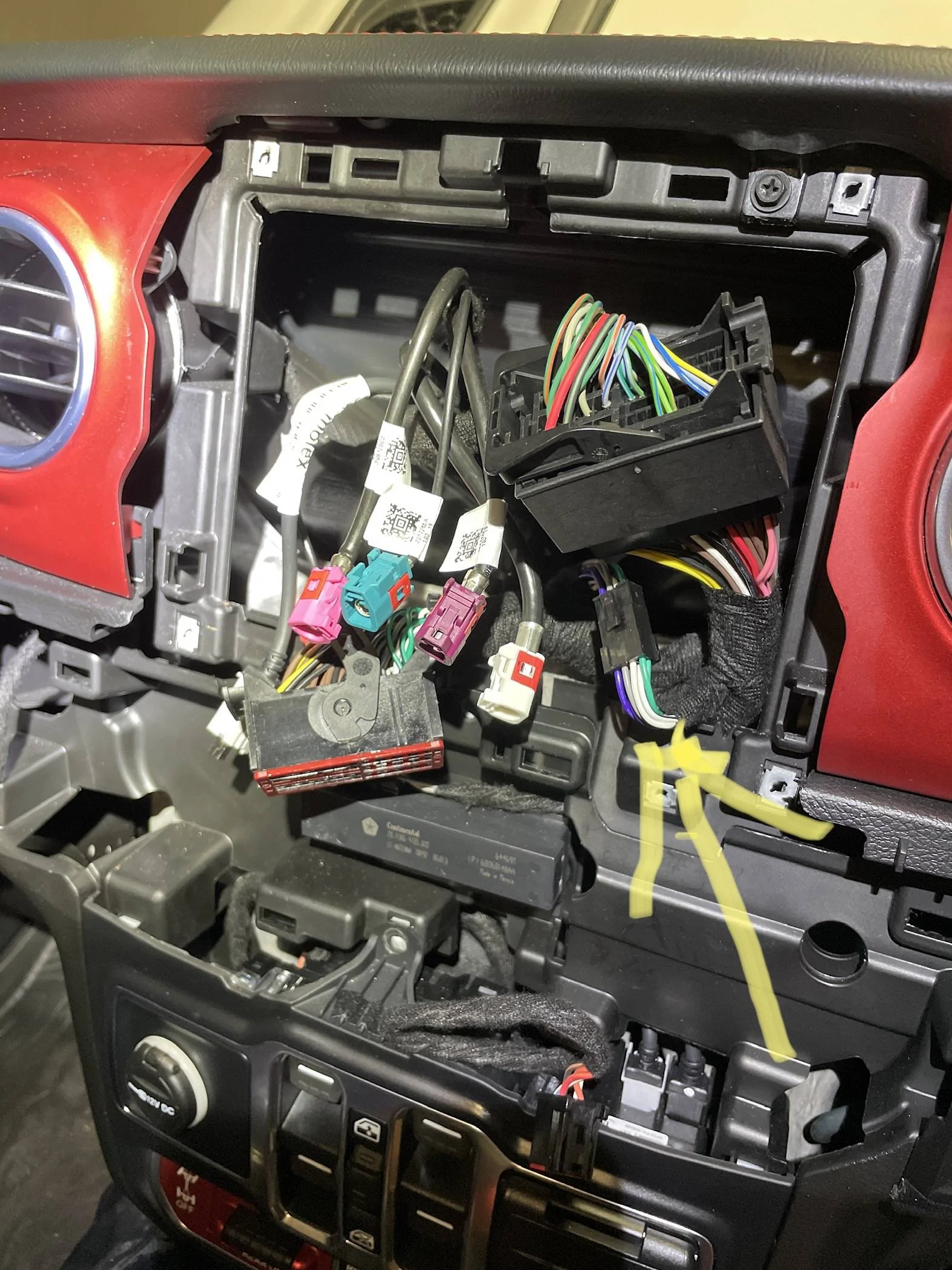

When using the pacamp, if you don't use a channel, will the oem speakers still receive signal and play?
For instance, I only plan to plug in kicks and soundbar.
Tweeters in dash will stay as well as oem sub.
Sting_NC_USA
Sting_NC_USA
Michael
Mar 25, 2018
1,041
1,031
Birmingham, AL
2018 Jeep Wrangler JL Unlimited Rubicon
I believe the PAC comes with a wiring harness that allows you to pass a signal back through the stock speaker wires. Haven't done that myself, but check the manual, and you'll see what I'm referencing. The thought is, you would simply pass the stock signal back into the appropriate wires in that harness. Maybe someone else here has done something similar that can contribute.
RSK
May 16, 2019
91
76
SC
2016 Wrangler 2015 Renegade 2020 Gladiator Rubicon
Senior Director of Engineering & Facilities
Yes, that is correct. Pac Audio harness will also allow you to use the OEM signal and speakers. I’m still running the OEM Sub and a Kicker HS8 Sub signal off the existing amp and signal from the OEM wiring, while running two amps to other speakers through the Pac harness to the Ampro module. You just connect the smaller plugs on the PAC harness and the OEM smaller plug. Not to be confused with the bigger plugs.
The yellow arrow is pointing to the smaller plugs to connect to retain the OEM speakers and signal.
I hope this helps answer your question.
