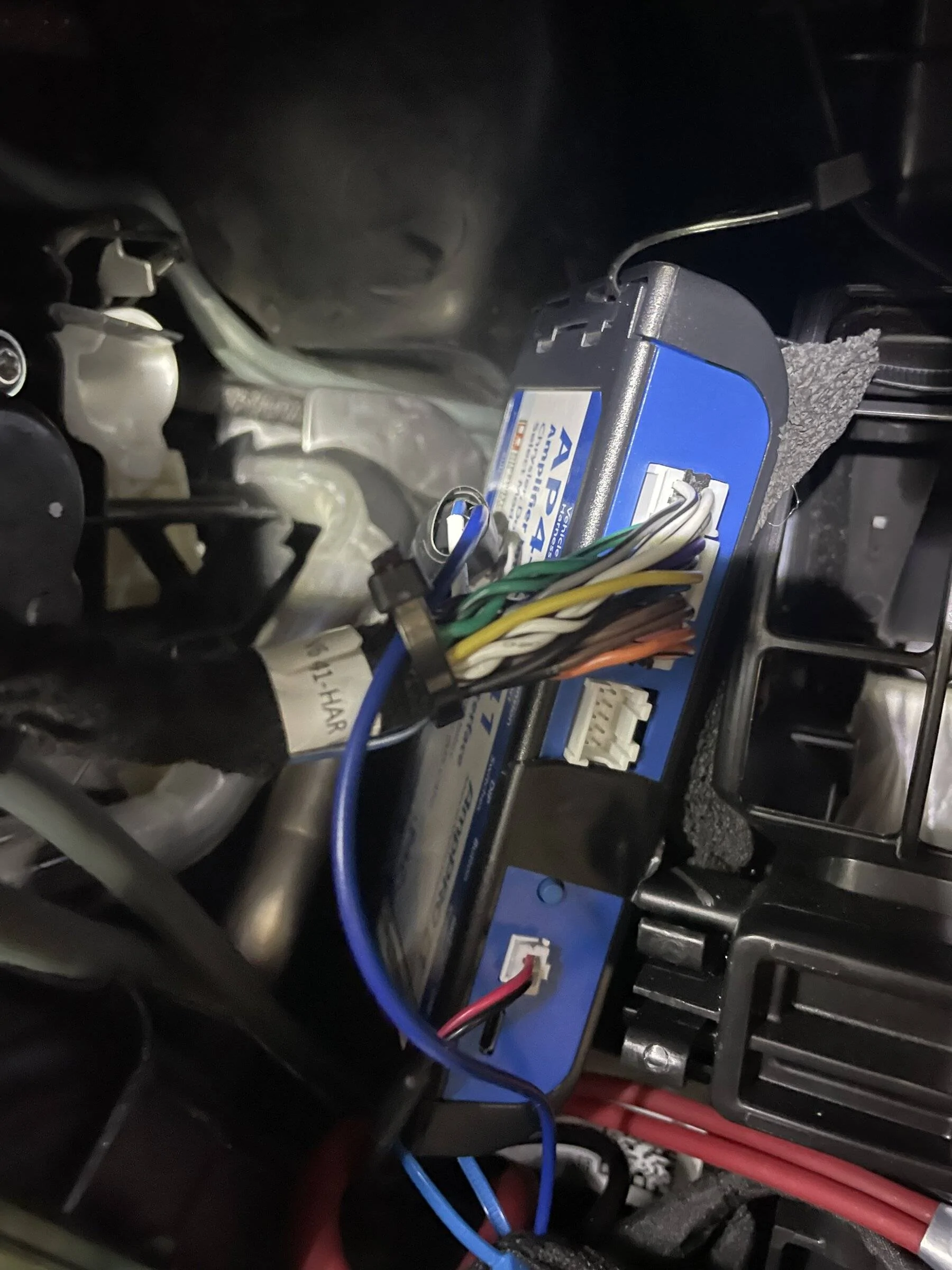

Keep the Ampro a couple inches away from these two pipes when mounting inside the glove box. These pipes get pretty hot.

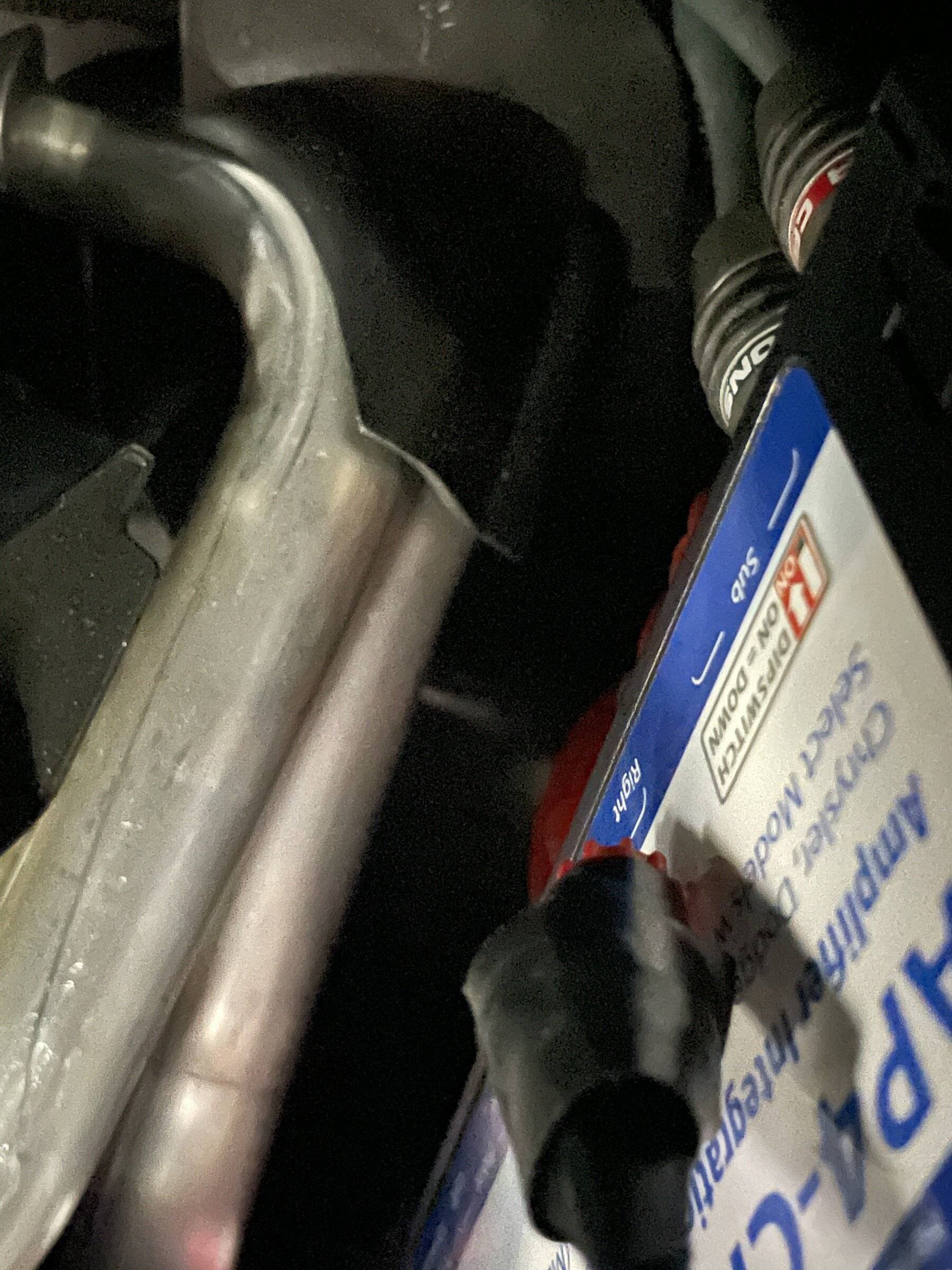

I faced the Ampro update data port outward in case there are future firmware updates and will be easy access. Note: The blue remote wires will need to be spliced.

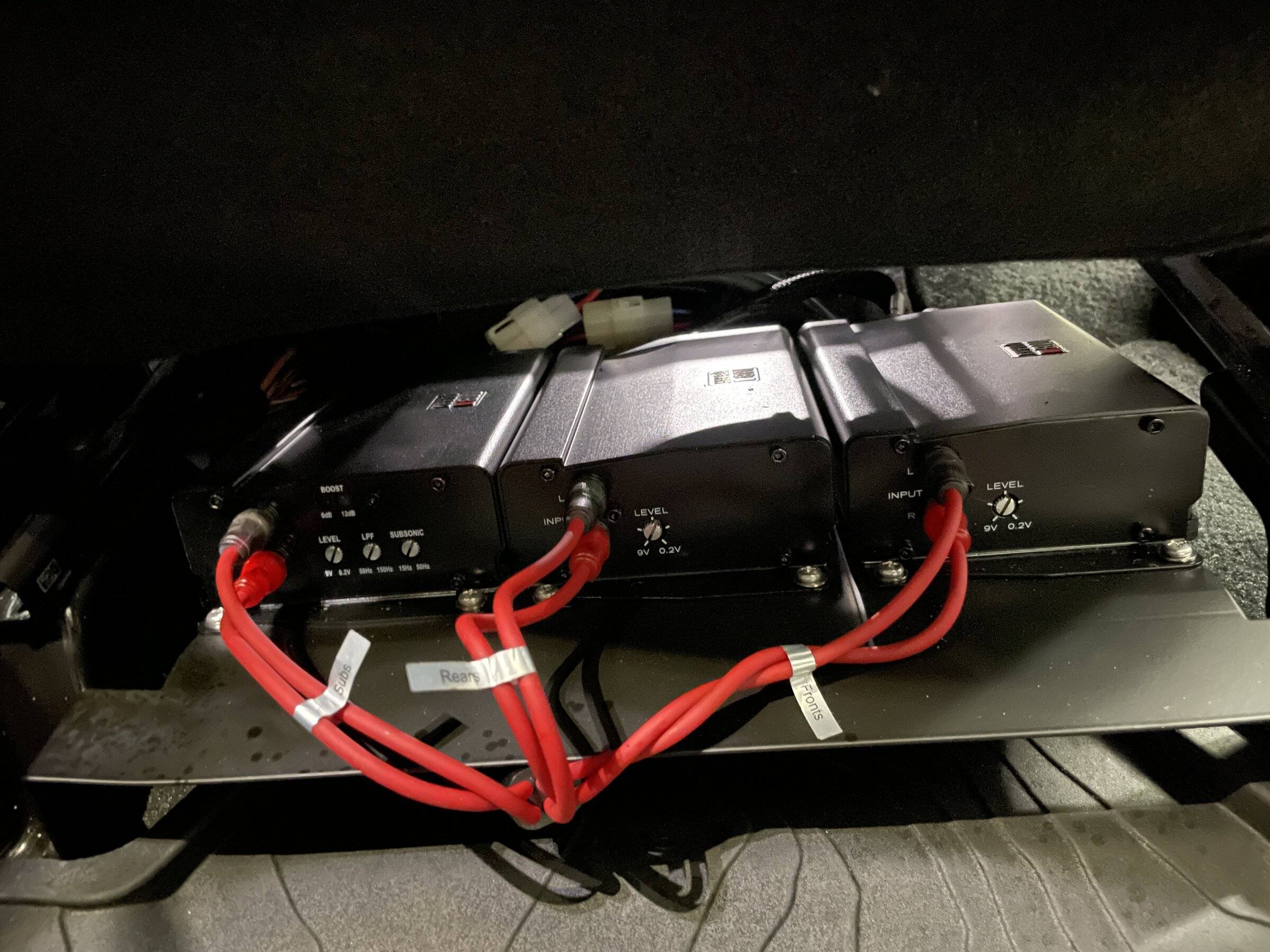

Went ahead and added the MB Quart additional sub amp, wiring and making it ready for another sub in the future.

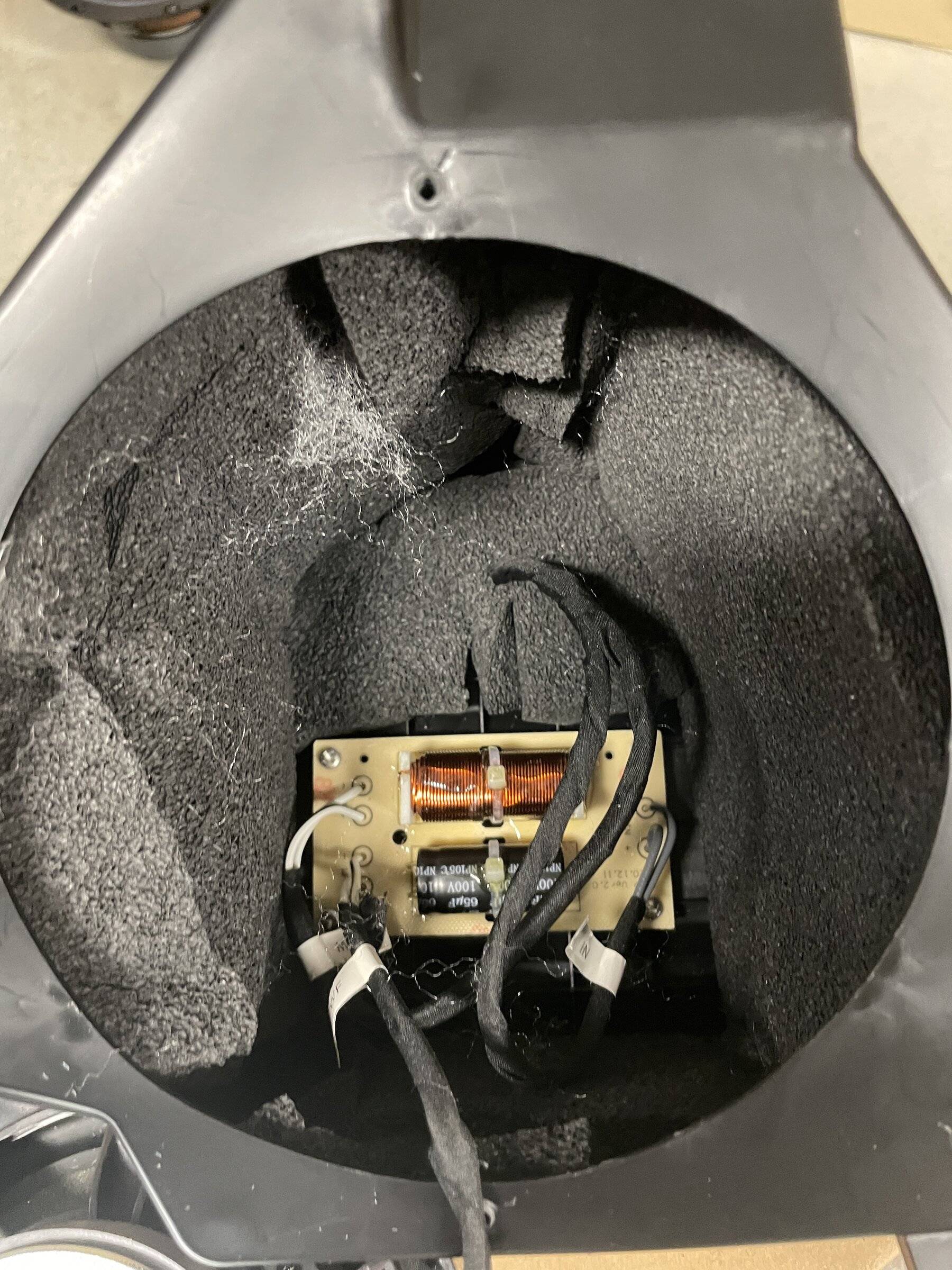

Hush Mat added to the new 6.5” pods

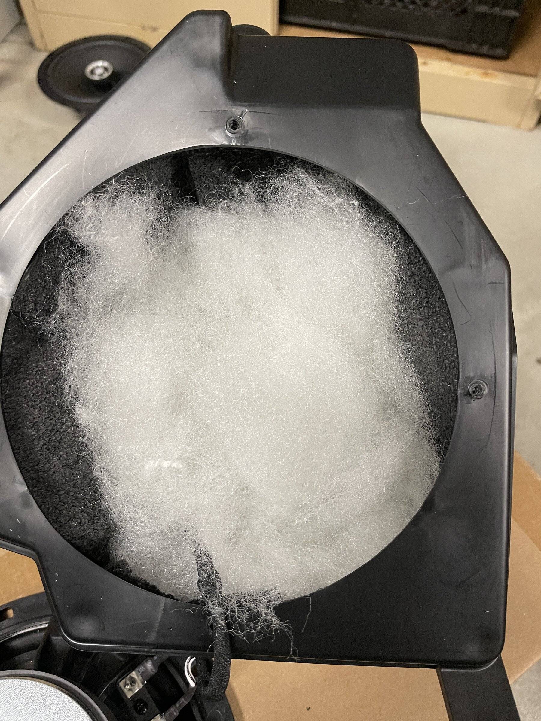

Polyfil too.

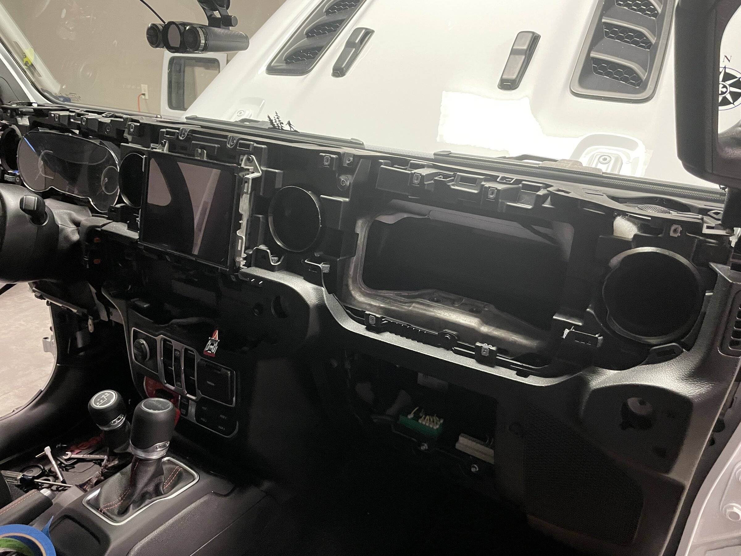

Major dash disassembly, but very doable.

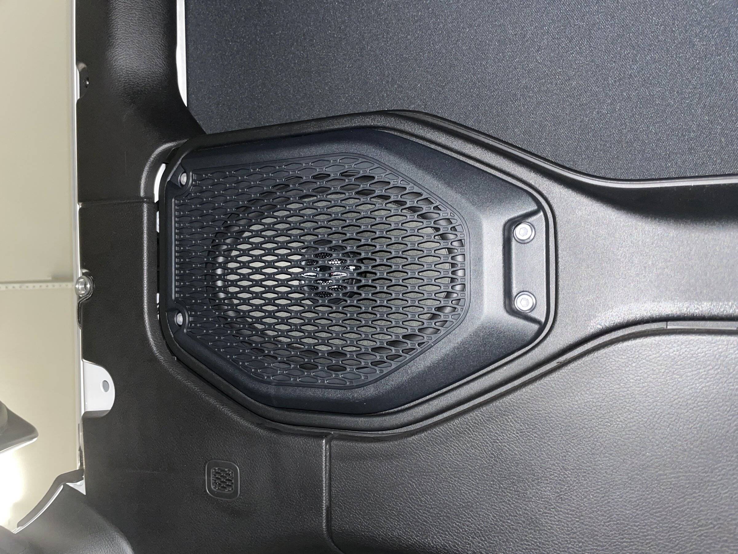

New 6x9 installed. I used a hot knife to cut it out where needed around the template and never actually removed the soundbar.
