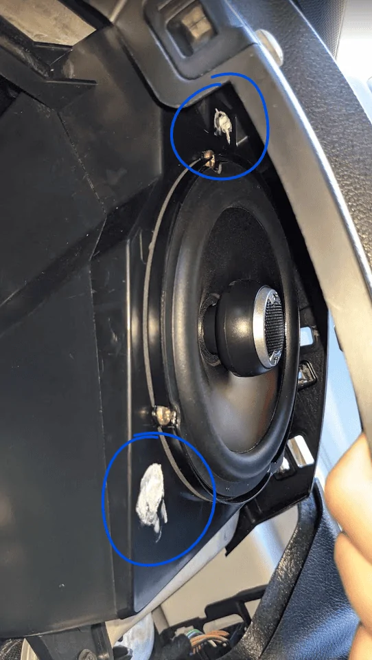

Did anyone that installed Metra pods have any odd sound from their passenger side? I thought my speaker was maybe defective, it was making the strangest sound in bassy stuff. It was this weird buzzing/whistling/didgereedoo sound haha. Started thinking maybe it wasn't quite seated correctly, maybe I'd half tightened the screws and forgot and it was air buzzing out the sides.
When I pried it open I started poking around, pushing the frame of the speaker, looking for something causing a buzz. Found these two little pinholes in the pod itself, like the size of if you jabbed it with a dart. When I covered each with my finger the sound stopped. Are yours like that too or was this some manufacturing thing? I just grabbed some caulk and stuffed in there and seems all is well. Thats really strange, and it was VERY noticeable. Figure worth mentioning if anyone else ever notices that.
Actually no, haven't seen that yet. Silicone or hot glue, preferably from the inside, would work well, just in case the caulk on the outside gives out in the heat. That's really bizarre, and KUDOS for the excellent relay of the sound effect!! ;)

I'm praying that holds, I really don't want to go through that process again to get them back out lol
No, didn’t notice anything like that and no abnormal noises. Hope your fix works.
Installed a set today, and those holes are simply for different shaped speaker mounts. I just put a little silicone in them and added a small screw for each. You should be fine!

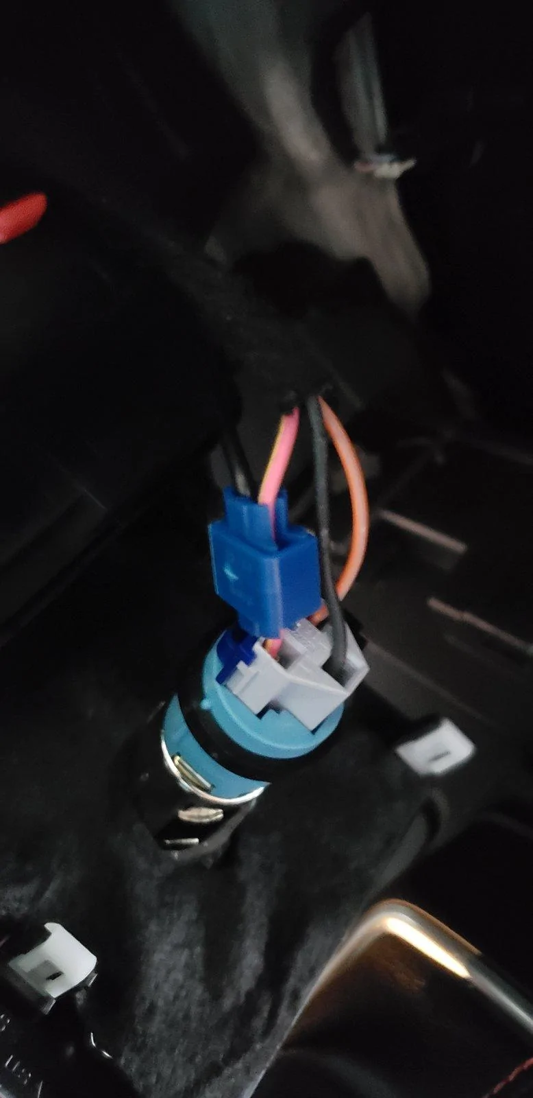

Lol, so funny thing...does everyone's cigarette lighter lose power when the engine cuts out at stop lights? Got all my stuff working, had to order and wire in the resistors to trick the head unit. All working great! But I tapped the cigarette lighter...the damn amp cuts out when I stop haha wtf!? Assuming a blip in the power there and killing my remote signal. I swear I saw other people doing that. Theres two wires right, the socket and the light? Maybe I grabbed the wrong one?
This is the wire I used. No issues with ESS and amps cutting out here. Is this the same wire you tapped?
Of course I snap pics of most projects I do and this is one part I didn't. But yeah I'm pretty positive thats it. I even had the same style taps laying around and used the same thing. I'd expect either of those leads to behave the same way I'd think. If it keeps up I'll be pulling the radio again so I'll have to check.
