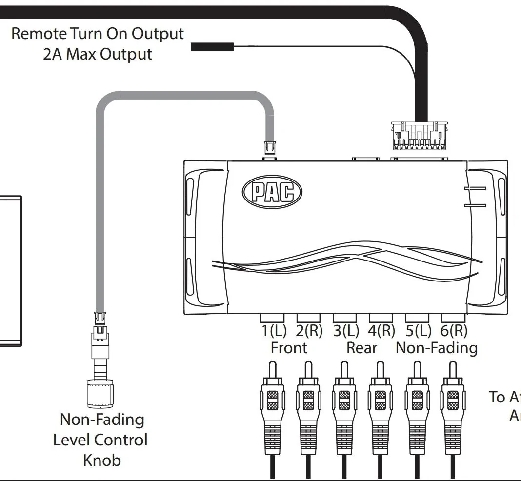

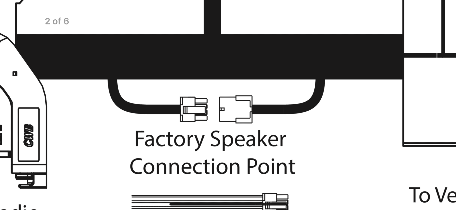

Thanks again for all your feedback.It's the latter, actually. Unless I'm mistaken, you really have to upgrade everything if you run with the PAC, because it plugs in-line with your existing harness.
You could initially run an amp and sub off of a basic LOC like the LC2i, using the rear speaker wires, then upgrade everything later
You'd only be out the cost of the LC2i when you're ready to upgrade, which isn't too expensive, and would likely sell pretty quickly on CL or FB.
I don't have a link at the moment for the Metra harness, but I'd bet a fellow member here can help. If I find it later, I'll update this post.
