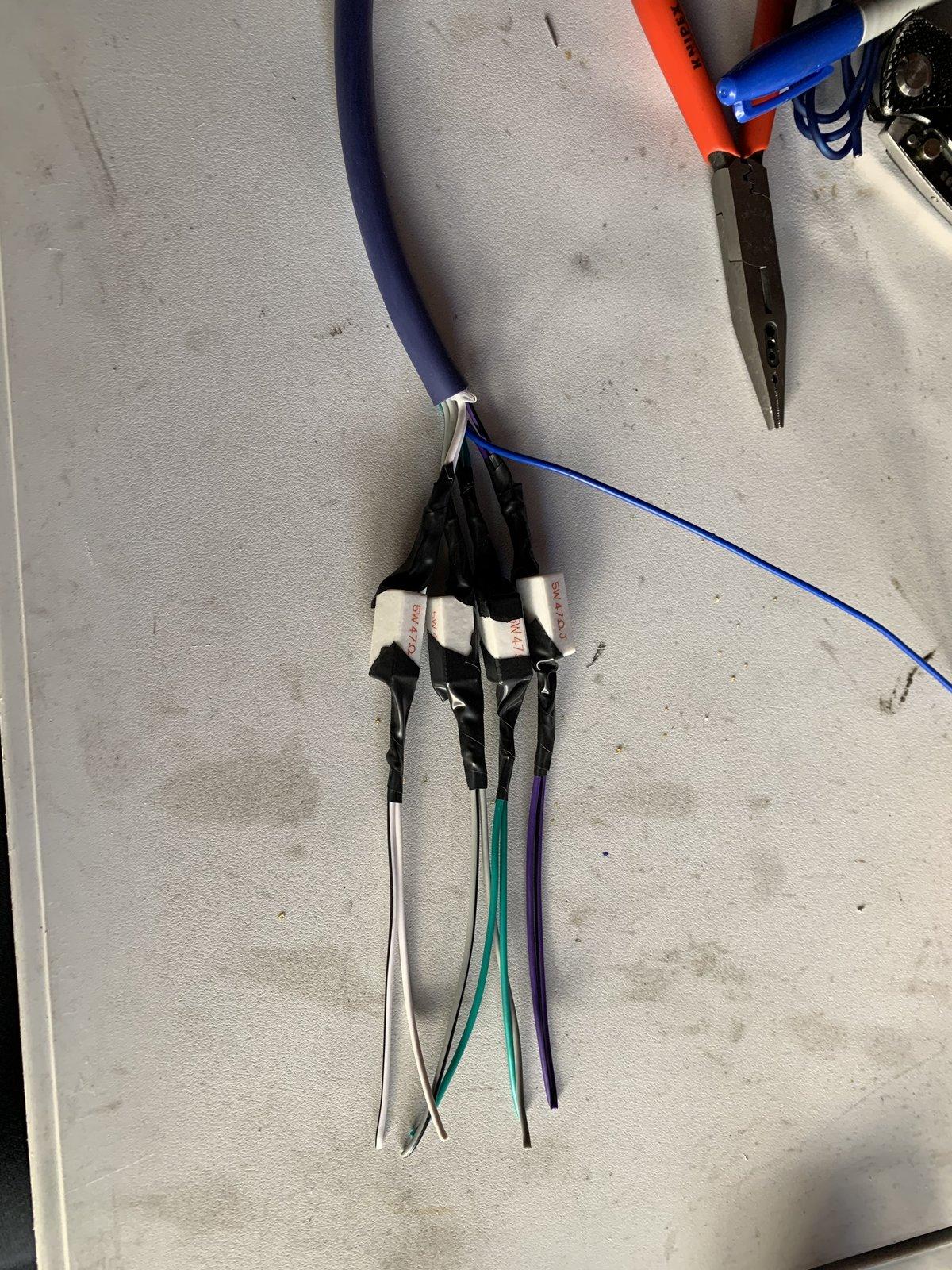

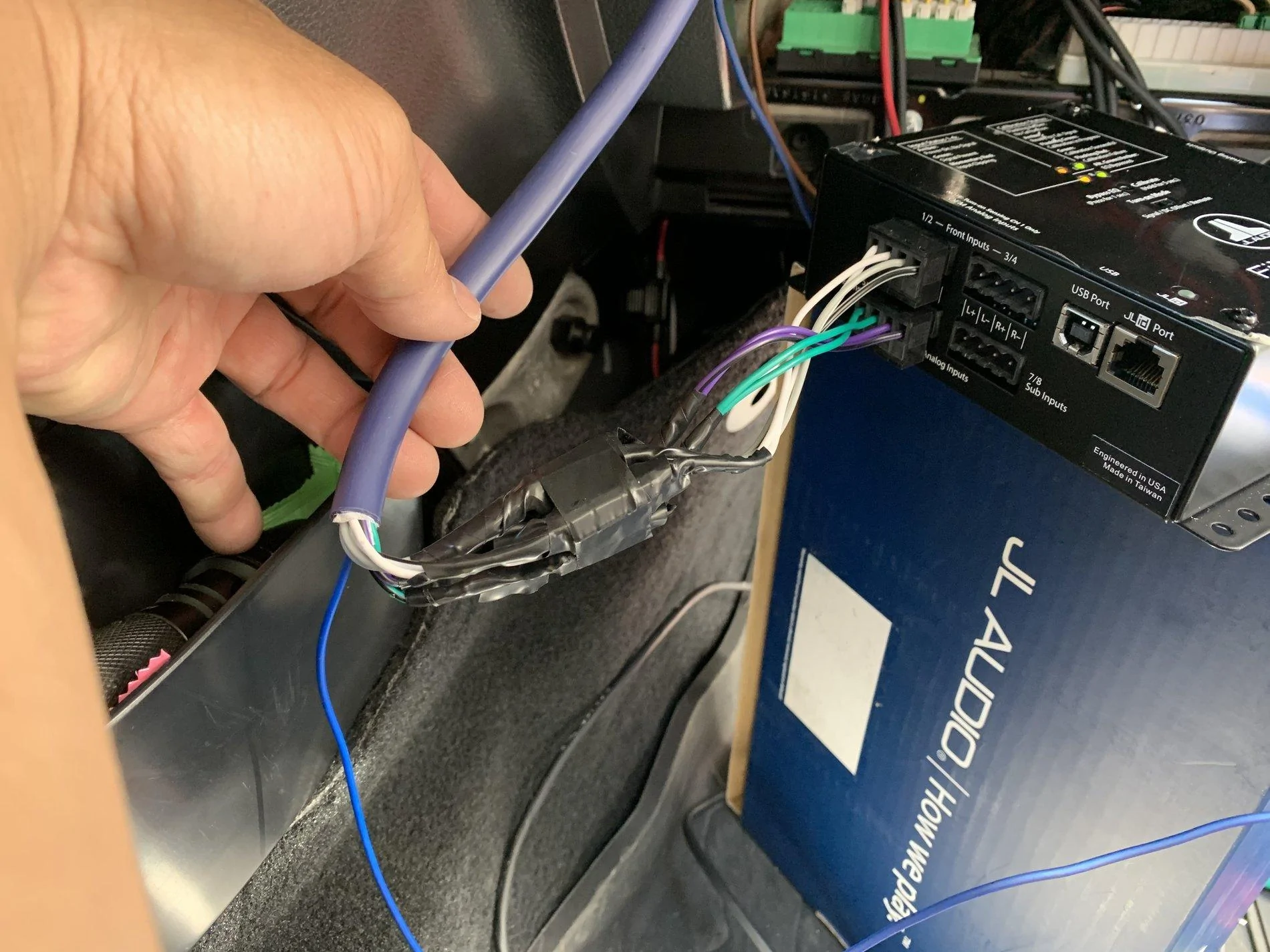

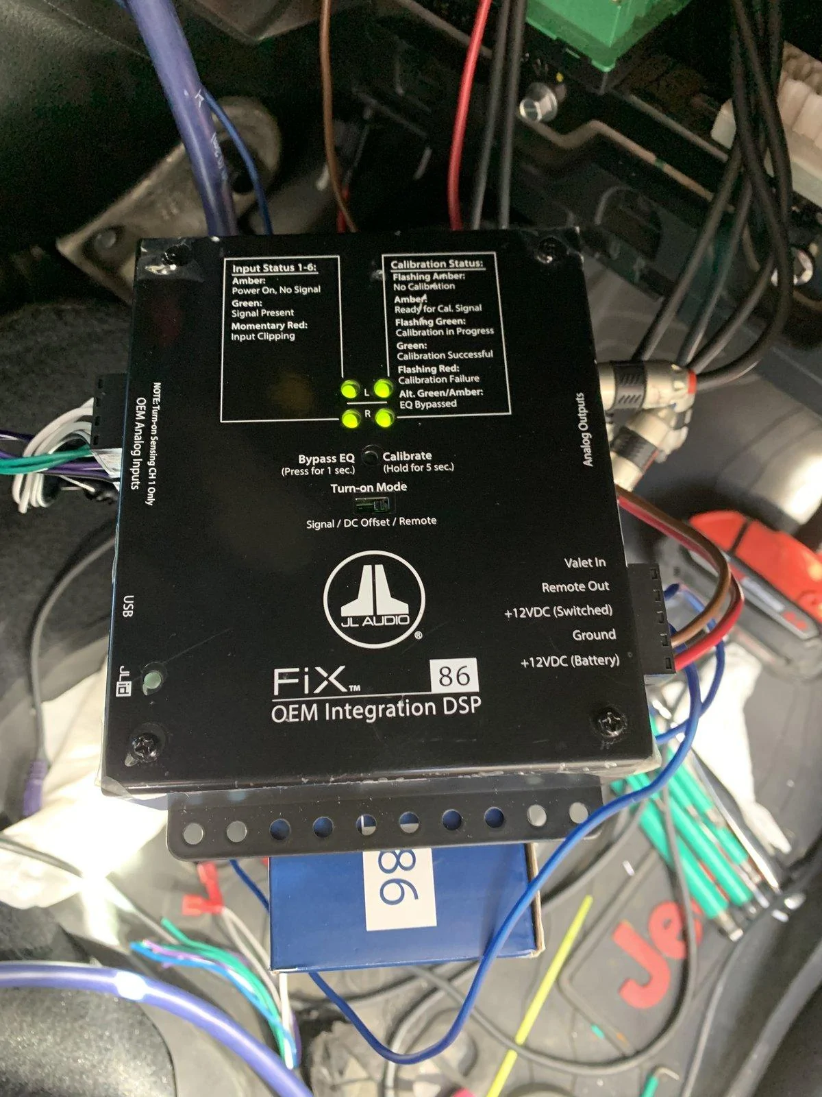

i had the Pac unit from first and having some HISS noice issues course MIKE was still trying to help with PAC but i just got tired and wanted to jump "The old school" version of the MIKE yes everything was wired and soldered how Mike explained on this first page
yes i followed all his instructions and guide from Mike with JL Audio FIX 86 last night installed FI86 signal harness everything looks fine but i couldn't calibrate the unit , today from the morning i maded another harness with Resistor thinking maybe something is wrong with the harness i made.. but exact same issue as previous.. think i did like 100 calibrations... and asked for help to MIKE and he was nice to call to my Phone helping to get resolve my problems talking and comparing things together yes! we found the problem!! :)
was the Calibration file... i got the Calibration file from CD in the box... and that was the Gate to HELL lol
we downloaded new file from JL Audio web and yes!!! all 4 light is green!! again Mike Thanks so much for all your help to get me here
car sound amazing even my amp is not adjusted yet !
PS : if you guys are getting Jl Audio Fix86 do not use the Calibration Disk that are included in the box Download from the WEB is 20MB + file
hope everyone has safe and nice day!!
