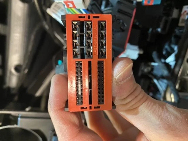

Thanks Michael! Well, I was connecting the radio to the new PAC connector and it will not go in! Yea, I have it the right way. It will it budge I looked at the connections and it all looks ok.

Did you open the clamp first? You have to unlock it before it can be inserted. I can't tell from the picture, but I'd guess that's the issue.

Sad to say, it is open.

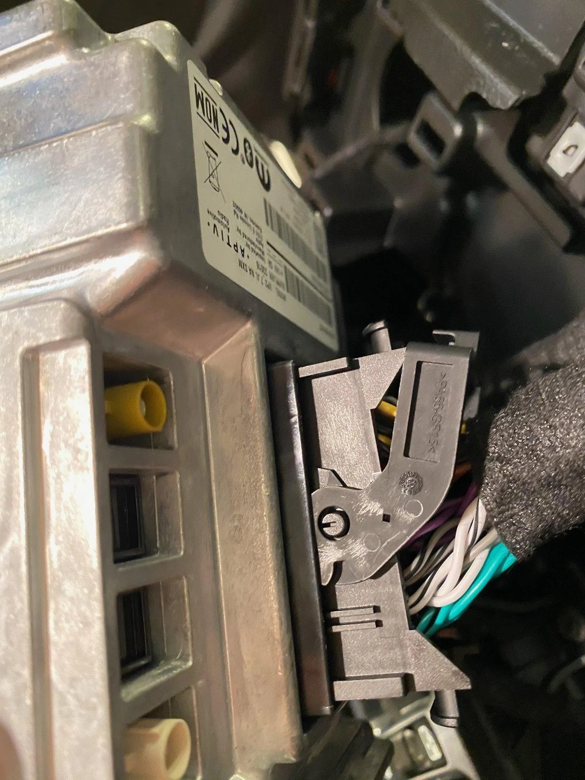

Sometimes, the latch on the PAC doesn't open as wide as it needs to. There's a notch on the plug that needs to point further downward.
In the picture below, for example, the latch isn't open wide enough. If the wires are pushed to the side, the latch will open wider, and that notch will then be able to grab the rail and allow the plug to be pulled in.
The base of the latch should likely be at, or close to a 90-degee angle with the plug.
