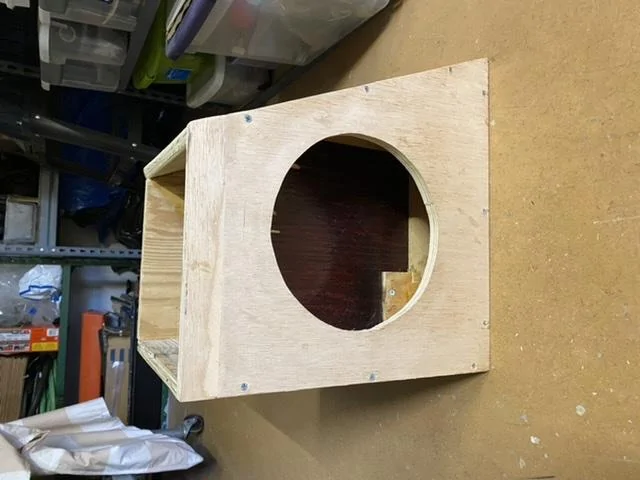

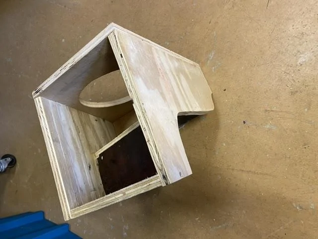

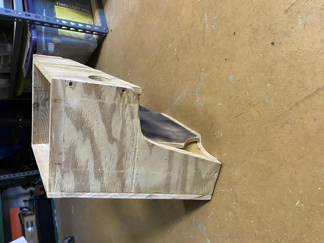

So he inspired me to build my speaker. Although I did it all out of wood. Here pix in the works.
