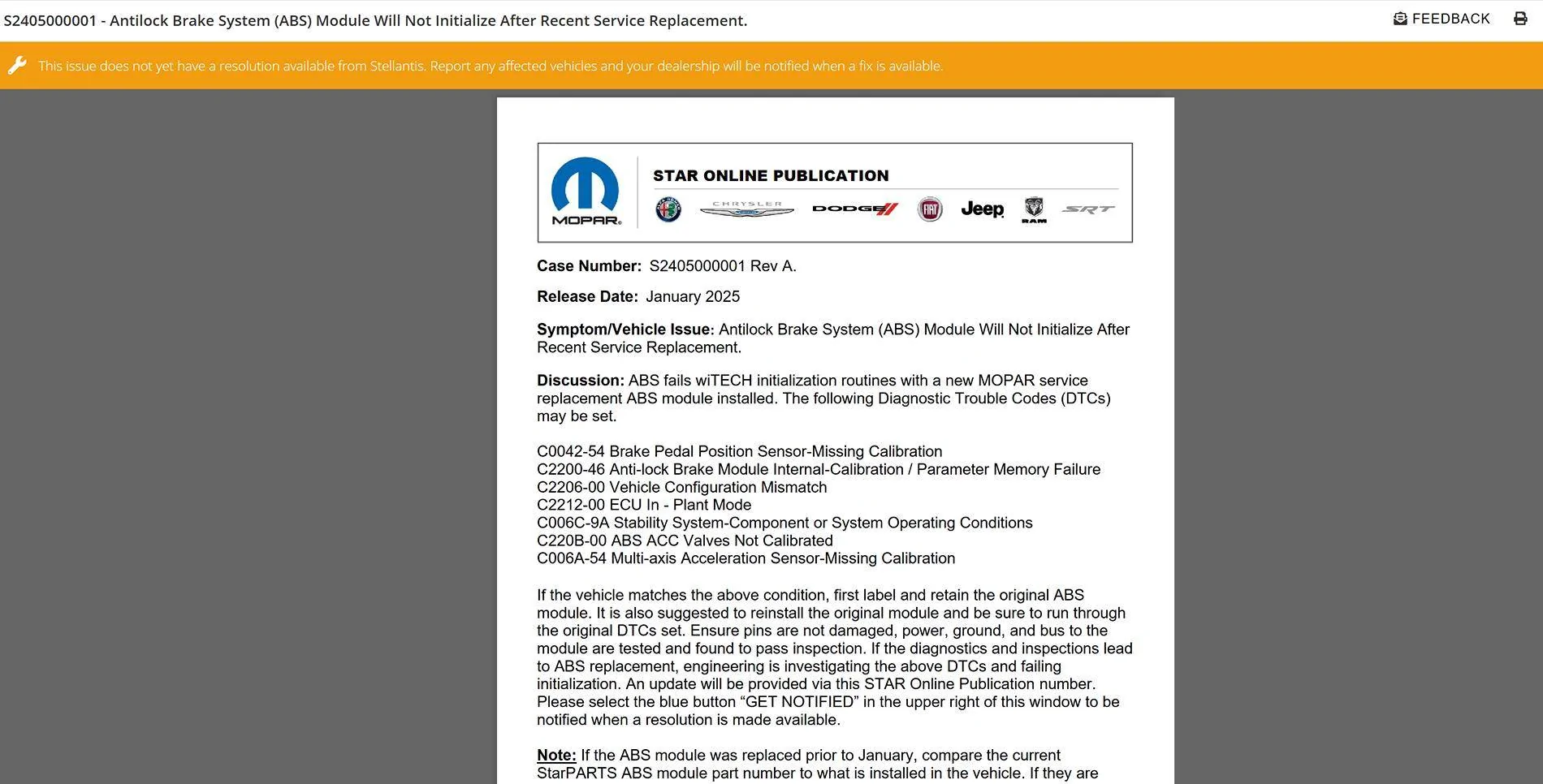

Something happened with the ABS module supplier. It took them over half a year to find a new supplier to get new modules produced. However the new modules refuse to program. The programming issue has been known and a bulletin has been available on this since SEPTEMBER. They stopped all production again once the issue became known. Zero resolutions available, you're shit out of luck. If you are within a lemon law period I'd strongly suggest contacting an attorney and going down that route. I think the engineers are just ignoring the issue.
I've got a JL at my shop that's been here since April because of this. Still no updates. I posted a picture of the bulletin below. Ignore the January 2025, its been around for over half a year at this point. Even if you managed to source a module you wouldn't be able to actually program it.

They're only able to be programmed once I believe. You can try installing one and running the ABS initialization routine and seeing what happens
That's crazy. VW has some quirks with their pumps, but I've never heard of one time use. A used one should already be programmed, I think @mg2020rubicon should buy one off eBay and roll the dice.
On the older models it just stores a vin mismatch code and leaves the light on but everything else works. In the JL it’s a critical module so it may or may not work at all. I’d like to know the answer as well.
