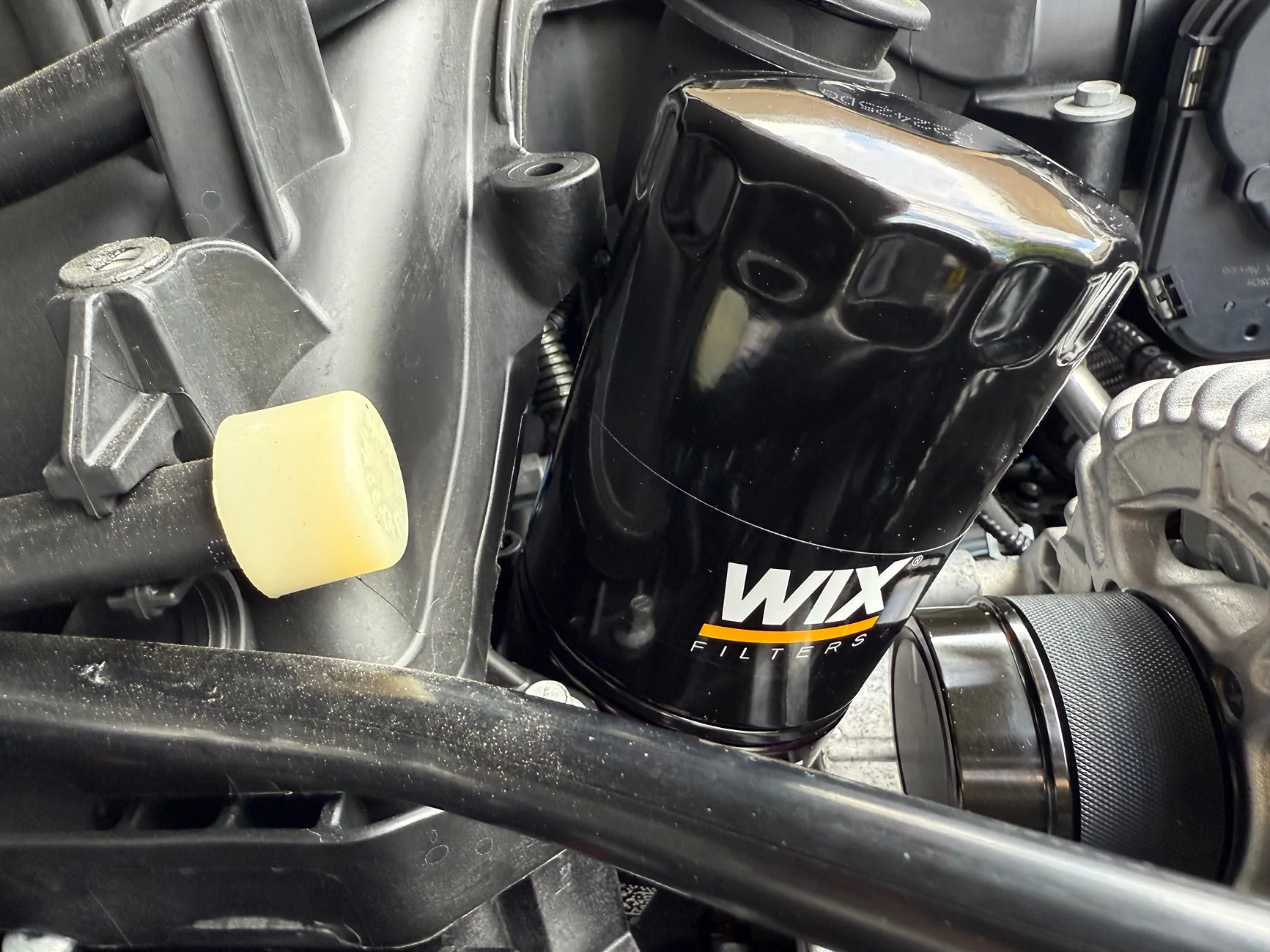

As posted above the Baxter adapter with its anti drain back check valve prevents the 3.6 dry start issue and allows a quality canister style (Wix or Mobile One) filter to be used. The only draw back is added weight to the plastic oil cooler housing. I installed mine at just over 1K miles and have been keeping a close eye on it and haven’t noticed any issues. My engine starts and idles very quietly.

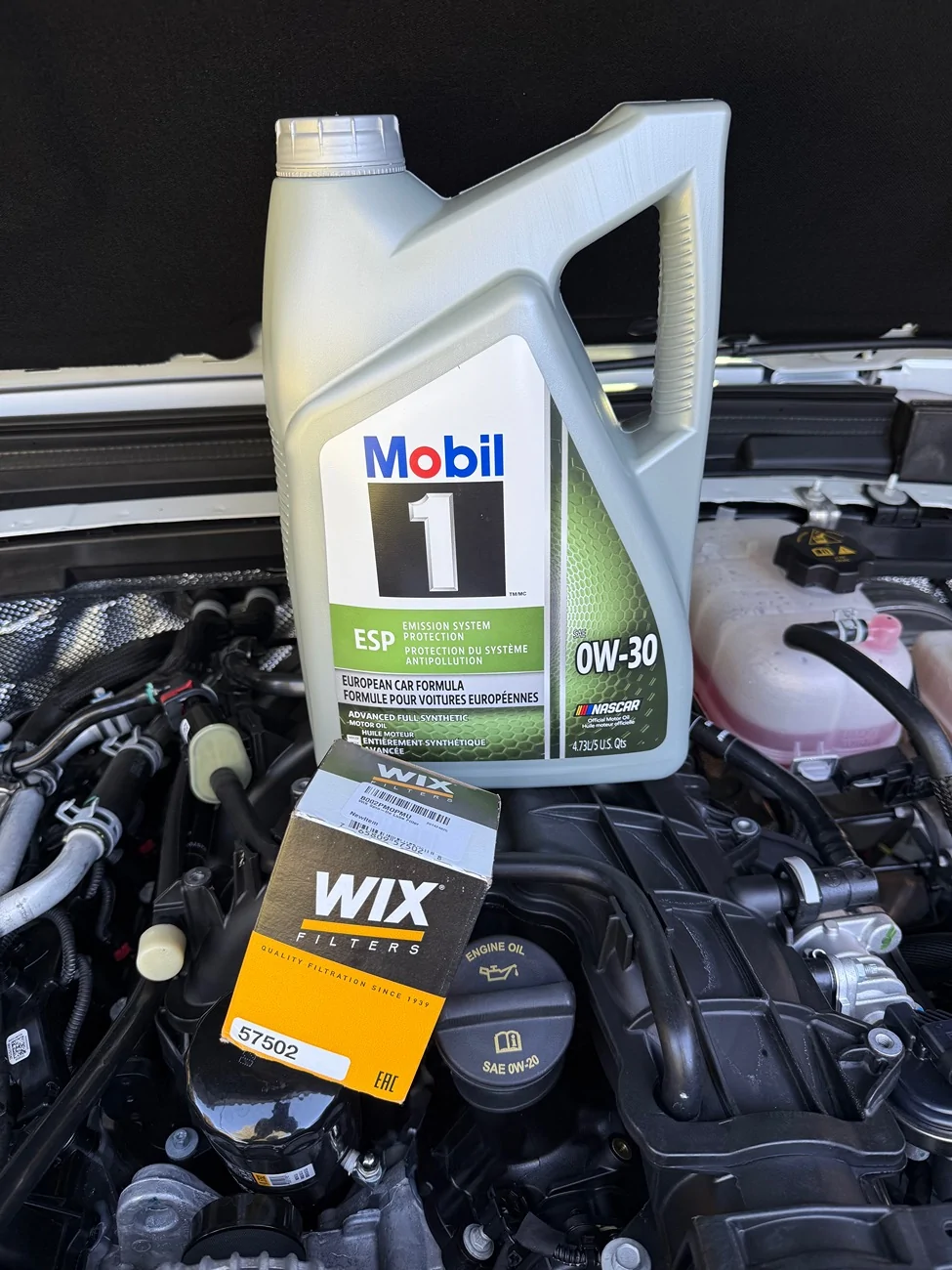

I agree. I haven’t installed the Baxter. But I do use ESP 0W-30 and a high flow/high efficiency oil filter. I rarely have engine noise at start up.
