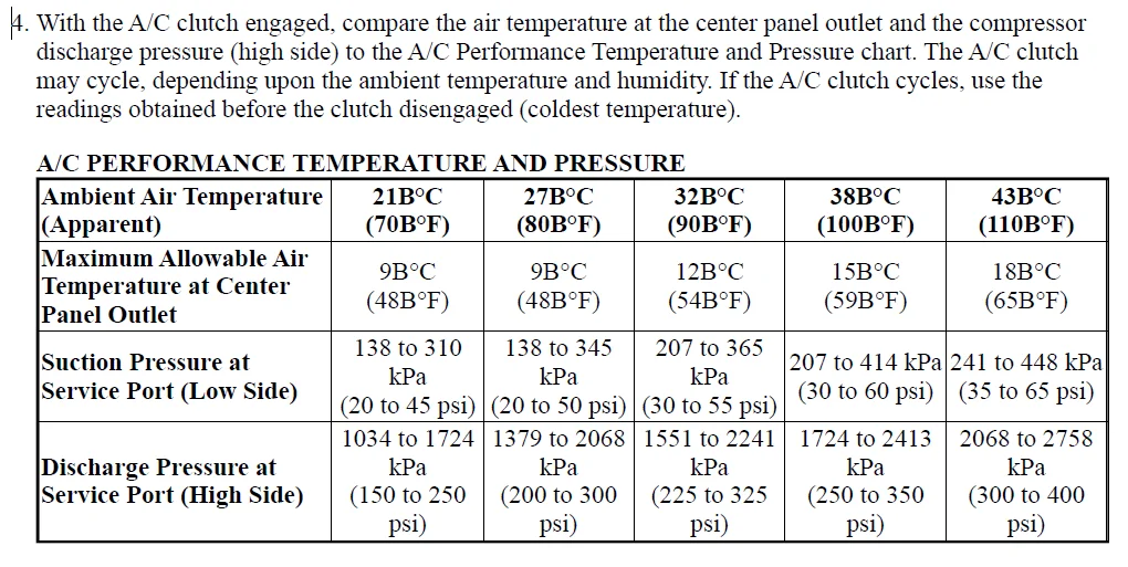

Fairly easy if you're handy. To properly diagnose, you'll probably want a gauge set. It should come with fittings for R1234yf cans and lines.
Then follow one of the many videos on YT to check low/high pressures, and refill as needed.
Here's the temp/pressure chart from the service manual:
Jeep Wrangler JL A/C refrigerant refilling? 1755886816935-jj
Just know that if it's losing refrigerant, then it likely has a leak somewhere.

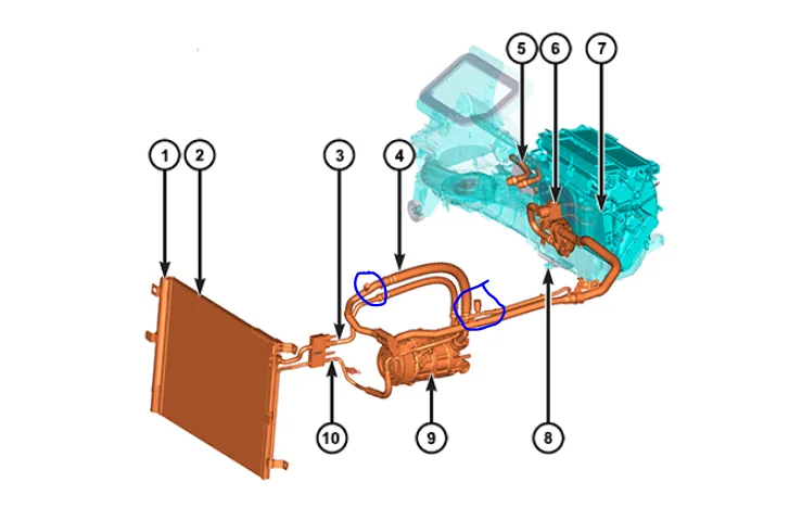

You can kind of see where to look for the refrigerant ports here:

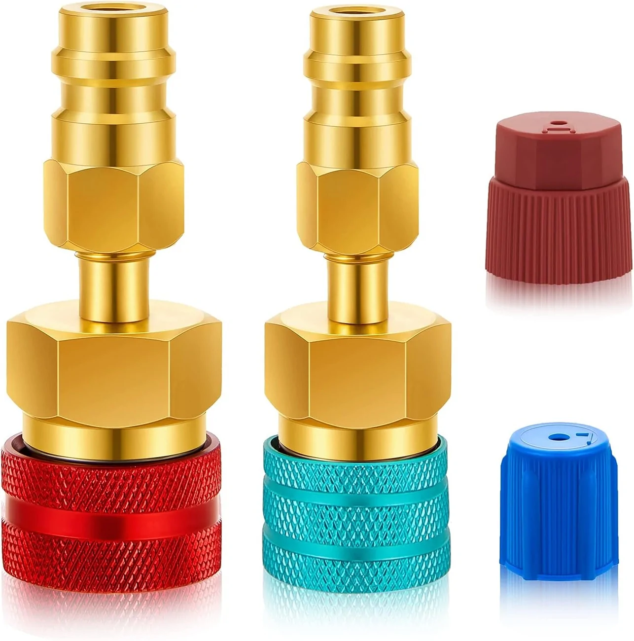

Do it yourself. Mine did the same as yours. For months before it gave out, the A/C made an intermittent hissing sound, which told me it was low on freon. Here is what I bought, which allows you to use the older 134a freon($10), without issues.
https://www.amazon.com/gp/aw/d/B0B17KWNHT?psc=1&ref=ppx_pop_mob_b_asin_title
Jeep Wrangler JL A/C refrigerant refilling? 1755960267139-zq

I ended up with the adapter fittings last year and filled with R134. I checked the parts list for Canadian models and they seem to have been delivered with R134. There are two hoses that have the fittings for R134 and a sticker which are shown in the JL parts lists. The orifice is the identical part as the R1234. Around here and what I found online, R1234 is running around $45 a can and you need 2 cans. R134 is about a 1/4 that. My system works fantastic and has since last year about this time.
