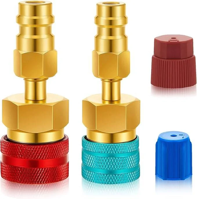

Well, a year went by, and I needed more freon. A very slow leak. I refuse to pay $70 a can for the new 1234yf freon, again. So, I bought the quick disconnect converters, that allow me to put the older R-134A freon. At $10 a.pound, it was a no brainer. It all hooked up with ease, and I now have a super cold a/c system again. Thanks to @Tredsdert 's original thread, and @Heimkehr for referring to the conversion kit. . The kit was $12.99 with free shipping. Solid, well made, and connects tightly.
Jeep Wrangler JL JL Needed Freon(1234yf). Not anymore!!!! 1740700390997-cv
Heimkehr
James
Sep 3, 2020
11,121
22,537
Pennsylvania
2021 JLU 2.0T
So, I bought the quick disconnect converters, that allow me to put the older R-134A freon. It all hooked up with ease, and I now have a super cold a/c system again.
For the sake of clarity, do you have blended refrigerants in your Jeep? Just curious.
