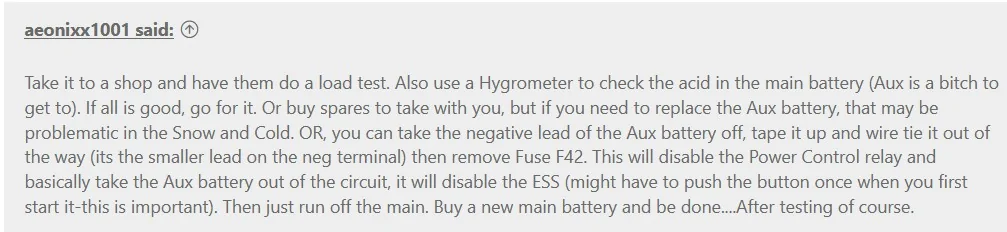

Take it to a shop and have them do a load test. Also use a Hygrometer to check the acid in the main battery (Aux is a bitch to get to). If all is good, go for it. Or buy spares to take with you, but if you need to replace the Aux battery, that may be problematic in the Snow and Cold. OR, you can take the negative lead of the Aux battery off, tape it up and wire tie it out of the way (its the smaller lead on the neg terminal) then remove Fuse F42. This will disable the Power Control relay and basically take the Aux battery out of the circuit, it will disable the ESS (might have to push the button once when you first start it-this is important). Then just run off the main. Buy a new main battery and be done....After testing of course.
Why would anyone need to check the humidity in a battery cell even if that was possible? What would be a good specific humidity level be for a battery cell? I don't think you're going to see a reading anything like a 1.250 to 1.300 with a Hygrometer.
My bad I mispelled the word G is close to D and I didnt notice. It is a Hydrometer, My bad. Thank you for pointing that out in an obnoxious way. LOL

Jeep Wrangler JL A battery gamble - what would you do Screenshot 2025-12-14 111752
@aeonixx1001
JL has an AGM Main & Aux battery...
You cannot as you suggested use a "Hydrometer to check the acid" on an AGM (Absorbent Glass Mat) battery because they are sealed.
AGM's hold their electrolyte in glass mats preventing access for such testing...
